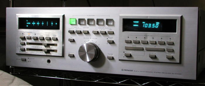

I have no idea but I somehow doubt it. It looks like it's early 80's vintage? Some Japanese stuff back then wasn't even using direct coupled output stages (i.e. they had single rail power supplies and a huge capacitor in series with the speakers).Peter Daniel said:I'm planning on using this SX-D7000, Pioneer receiver in my bedroom. Do you think it may equal Onkyo performance?
As I've said many times, I only maintain that amplifiers that MEASURE reasonably well will be hard to tell apart in a proper blind test. I'm not sure your antique Pioneer would measure reasonably well--especially now that's it's 20 or so years old.

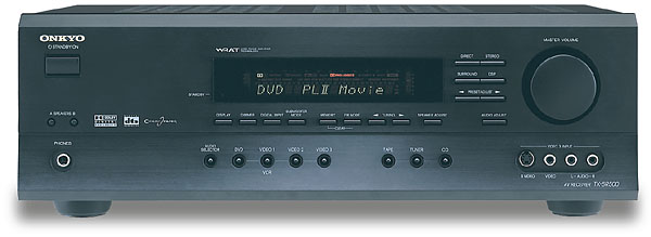

Obviously you're having fun here. That's fine. Here's a pic of the Onkyo SR500 used in the blind challenge.

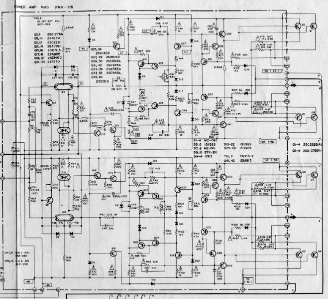

And this is schematic of the output stage. It looks pretty good to me again, and there is no sign of " no direct coupled output stages (i.e. they had single rail power supplies and a huge capacitor in series with the speakers)". It actually might be better than Onkyo.

Hi Nw
This Onkyo maybe have a very good audio perfomance...(and i say maybe ) because i haven't do the null test with it!!!
The WRAT technologie is a current feedback power amp that achieve a large bandwith and very low phase shift across it...and high slew rate...
So i'm not surprised...that it can sound good...

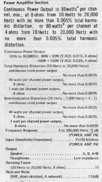

If that's the schematic and specs of the receiver/amp you want to test with, AND if it still meets those specs with its dried up old electrolytics, after any repair work that's been done to it over the years, etc, then it should do reasonably well in a proper blind test.Peter Daniel said:And this is schematic of the output stage. It looks pretty good to me again, and there is no sign of " no direct coupled output stages (i.e. they had single rail power supplies and a huge capacitor in series with the speakers)". It actually might be better than Onkyo.
Any "objectivists" in Toronto want to pop over to Peter's place to run a blind test for him? The only catch is, you have to compare it to another amp that measures reasonably well, keep them within their power limits, have them properly level matched, etc.

That's a good point. I'm not sure if WRAT gives it an audible advantage or not but that is another way the Onkyo differs from most receivers in its price range. Onkyo also claims it's a low NFB design.Tube_Dude said:Hi Nw
