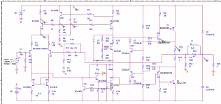

Hopefully this isn't considered reviving an old thread. I took your advice with regards to Pdiss in the VAS and CCS transistors, and used better output devices in a 2channel rebuild of this project. The power supply is now a 35-0-35V, 300VA toroid giving about 51v rails unloaded, powering both channels. Power devices are mounted on a large fan assisted heatsink rated at 0.6degC/Watt without fan and 0.3degC/Watt with the fan. There are no signs of instability driving reactive loads (2uF cap across 8R resistor), and whilst I haven't yet accurately tested distortion I expect it to be small.
The amps are now putting out about 135W each into 8R, but are limited by the single slope VI limiting to about 150W into 4R purely because I didn't want to use two pairs of output devices per channel (although the boards do have provision for this) and the transformer is rated at 300VA.
The only things I dislike are the fan noise, which isn't a huge issue as I only turn on the fan when playing so loud the fan noise can't be heard, and the fact that in negative clipping some small oscillations are seen, I'm not exactly sure why?
Thoughts, comments, opinions welcome.

Yeah it was with no load. It looks like ringing in the high audio band only on the negative clip.
The return of the zobel has its own separate return to the star ground, as do the on board reservoir caps (100uF and 100nF) which I forgot to include in the schematic.
Feedback is taken from a separate tee off the main output track.
D3 and D4 are actually 3A 400V types, forgot to mention that.

Can you explain me the function of this further LP filter R13-C2?
You have already TPC, so stability should be already achieved
Call it as you like, but it is a further pole in the transfer function, with a further 90 degree phase shift that comes along. So you better make sure that the gain is already under 0 dB when this pole takes place, otherwise your phase margin.....Wouldn't C2 and R13 actually be lead compensation? As an aside, it seems to me that TMC works better than TPC. Connect R25 to the output instead of the -V rail to see if you get some improvement.
BTW I am NOT criticizing this design in general, that for my taste is one of the absolute best that I have seen in this forum.
Yes it is also lead compensation, in my build (actually used 100pf and 1nf for TPC), sims seem to suggest that its not necessary for stability, it probably would be if I reduced those values though.Wouldn't C2 and R13 actually be lead compensation? As an aside, it seems to me that TMC works better than TPC. Connect R25 to the output instead of the -V rail to see if you get some improvement.
Self also suggests that swapping the compensation caps can reduce the VAS loading problem that comes along with TPC, so I might try that.
At the moment there's a bit of ringing on square wave, but it seems entirely stable with any load I've tried including capacitative ones.

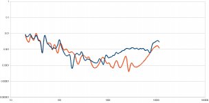

Also, for anyone who's interested I've been playing around with the STEPS program that comes in the ARTA bundle; I measured stepped sine response for the amp with and without the TPC resistor connected to V-, (effectively comparing single pole comp. and TPC). I exported the results to excel and subtracted the values for the soundcard alone as before and charted them. Again, I wouldn't say this method is accurate to any great degree but it does show the expected improvement with TPC compared to single pole comp.
The orange trace is for TPC, the blue trace is single pole. The lines have been artificially smoothed slightly also to make them a little clearer.
There seems to be an increase in distortion at LF which I'm not sure about; whether or not it's actually present or just an artifact produced by the soundcard measurement method.
These tests were run at 10W into 8R (resistive load).

I do not think so.With regard to R13/C2 and R14.
I think R14/C2 put a zero near 1Mhz (presumably the cross-over F) for some added phase margin and the R13/C2 pole rolls off this zero at a much higher frequency ~48Mhz (using the values shown)
Hope this helps
-Antonio
In your hypothesis, the gain of the ampli first rises at low freq. (at the zero) then levels off with the pole at a higher gain value.
A simple asyntotical analysis tells you that the gain is first high at low freq.
(circa= 1 + R14/R12 , then decreases at the pole, then levels at the zero at a lower value (circa=1 + (R14//R13)/R12 ,that can be approx. to 1+R14/R13).
So first comes the pole and then the zero.

Sorry, I mistyped. I meant final gain 1+R13/R12 in the last formula.
