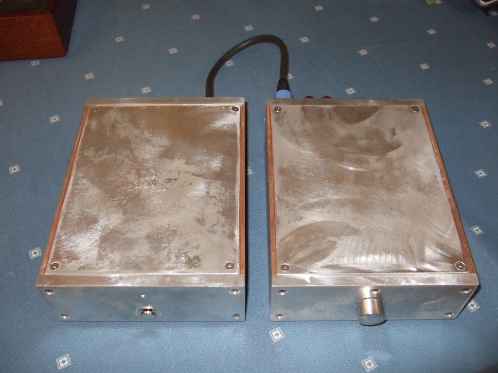

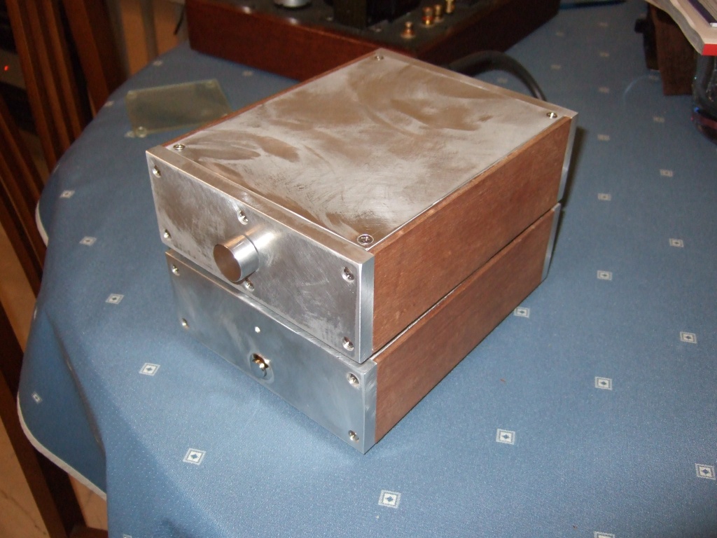

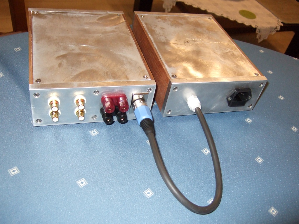

My brother in law made a copy of the synergy cct and psu, p2p with silver wire in custom boxes he also made. Heavy copper sections bind the panels inside. Doubling as sinks. I helped him choose a cct with gutsy psu (yours since it was balanced out for heavy caps), and I also debugged it in the end for him. He made a couple of small mistakes. We used 3886, the RC mute came handy for zero power on bangs. It drives 4 Ohm 50 litres bass reflexes for some months now in his summer house in Kefalonia island. He loves it.

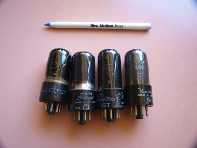

Have you realized that you probably got the most sought after NOS there? Octagon means RCA. Probably a relabel for Australian Mullard.
Kefalonia is over the other side to the northwest. Another kind of magic.
But enough sand and Ouzo OT.:D
I am only going to keep the two batched and manufacture matched pairs and maybe one other as a spare and sell the others off.
They are: Radiotron Q46, Phillips Australia, Rdaiotron Q3, 22, Miniwatt Australia 6?
You welcome to them but I have no idea what they are worth. I tested all of them and they all work. If you want them make me an offer. I will probably put them on eBay at some point. So I have four if you want them. Get straight back to me.
