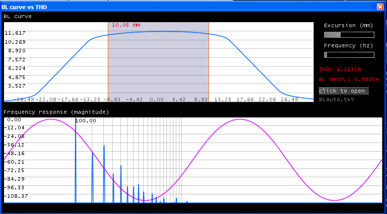

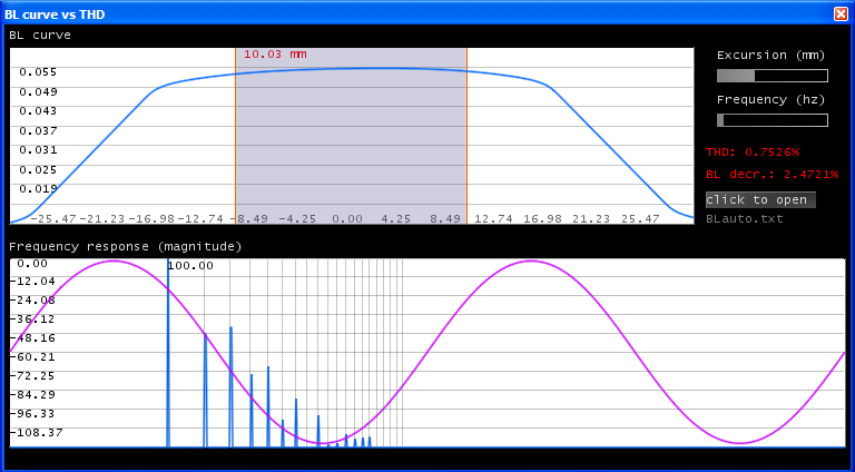

Playing with FEMM for a while, checking the distortion levels was a must.

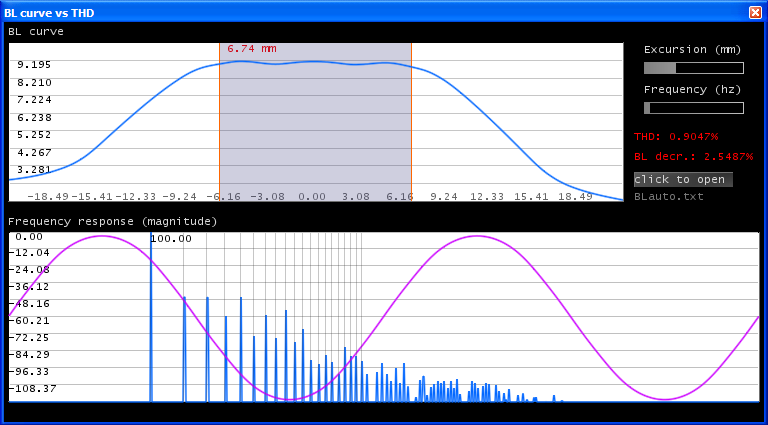

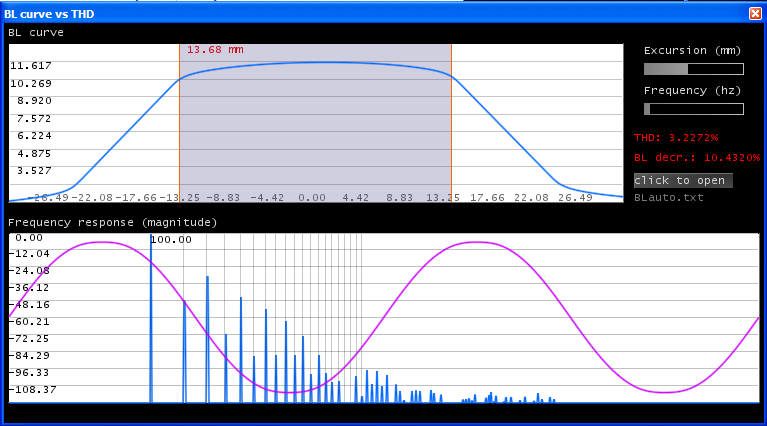

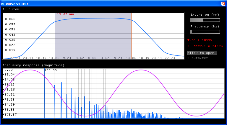

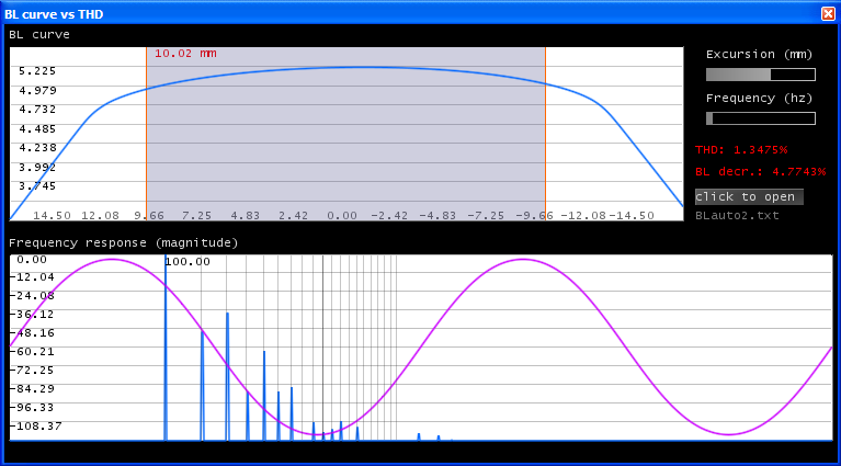

therefore i've made a simple application that evaluates the distortion and THD for a given BL curve generated by FEMM.
Let's take a look at it:
http://s5.postimage.org/jxxv44f47/app01.png
The app eats the BL curve and shapes a given wave, then the distortion is evaluated.

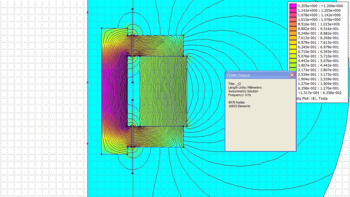

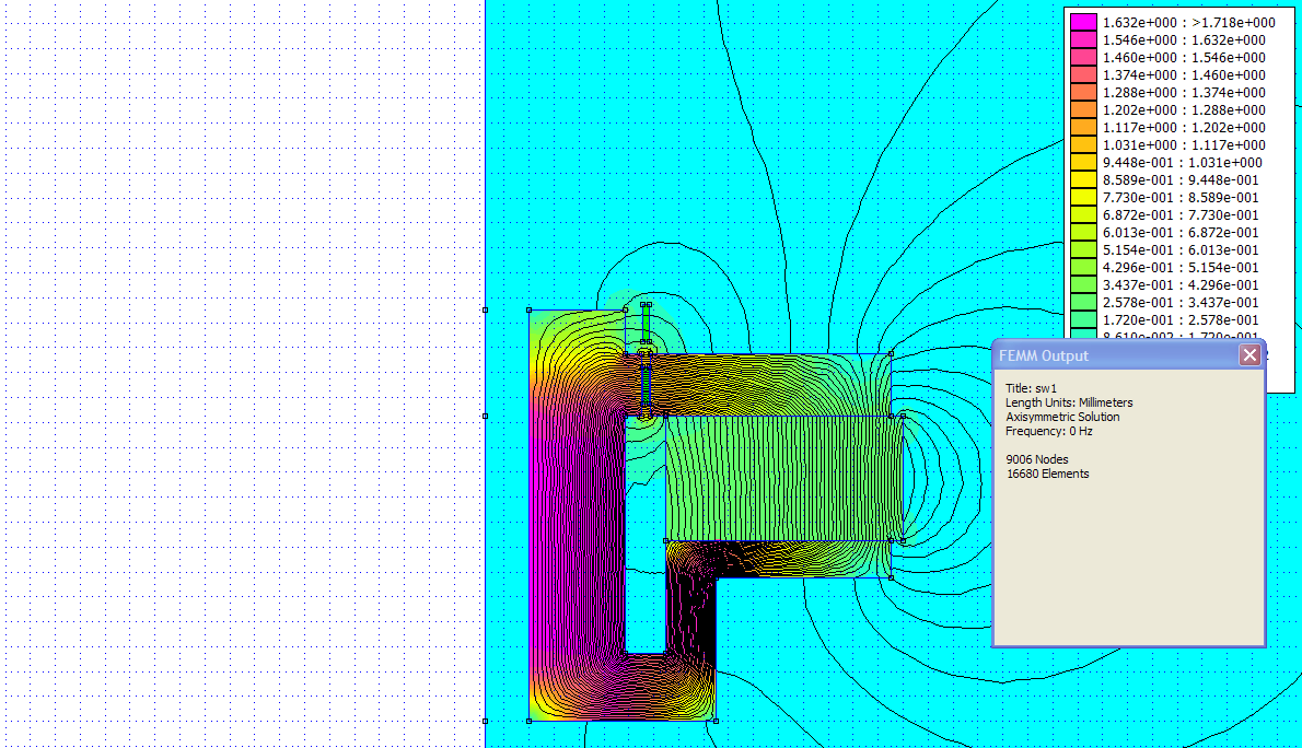

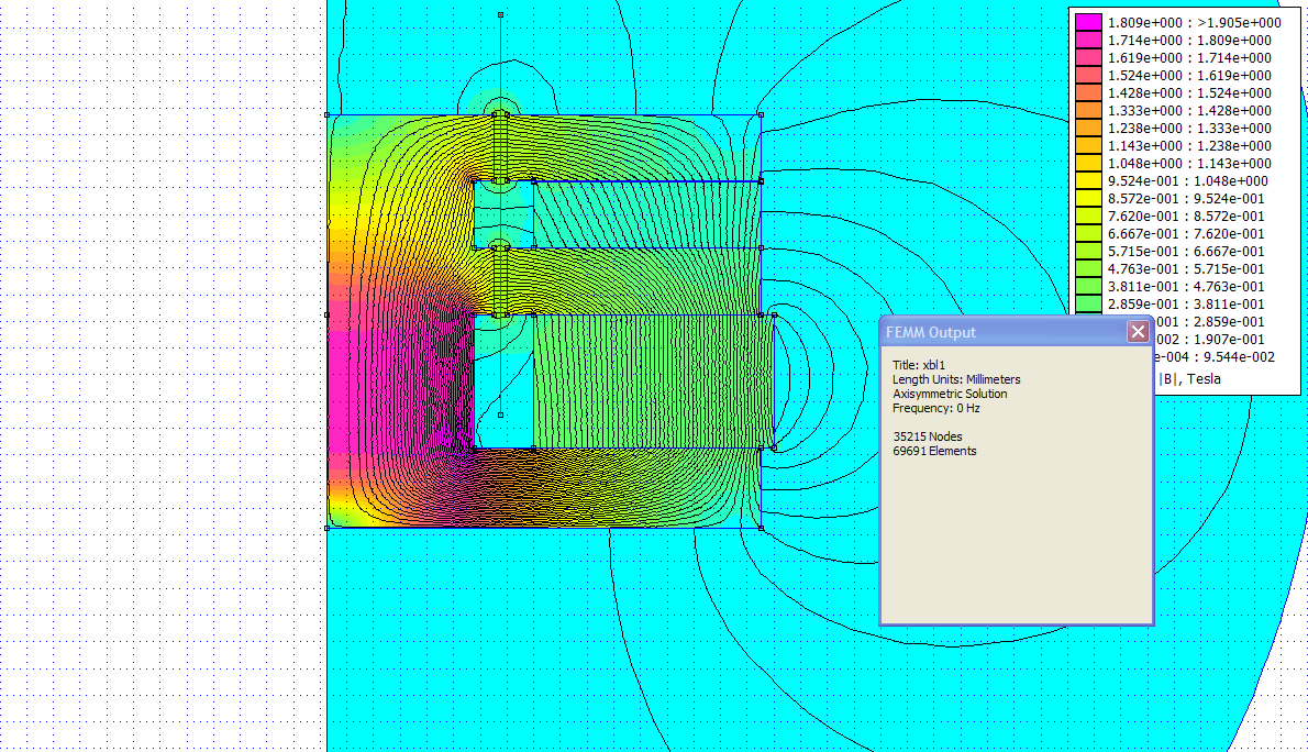

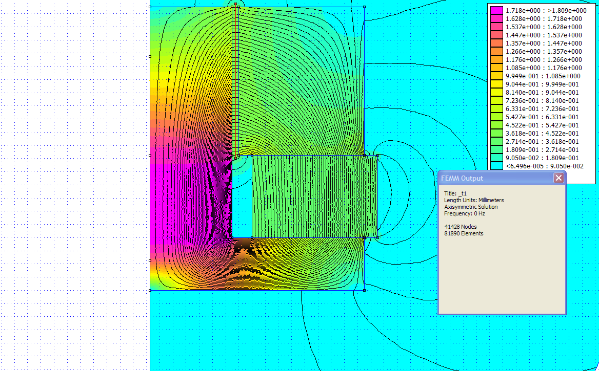

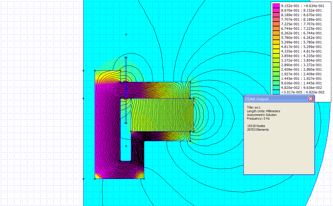

Here is (the already) optimized motor structure:
http://s5.postimage.org/vx9dbfkp3/motor01.png

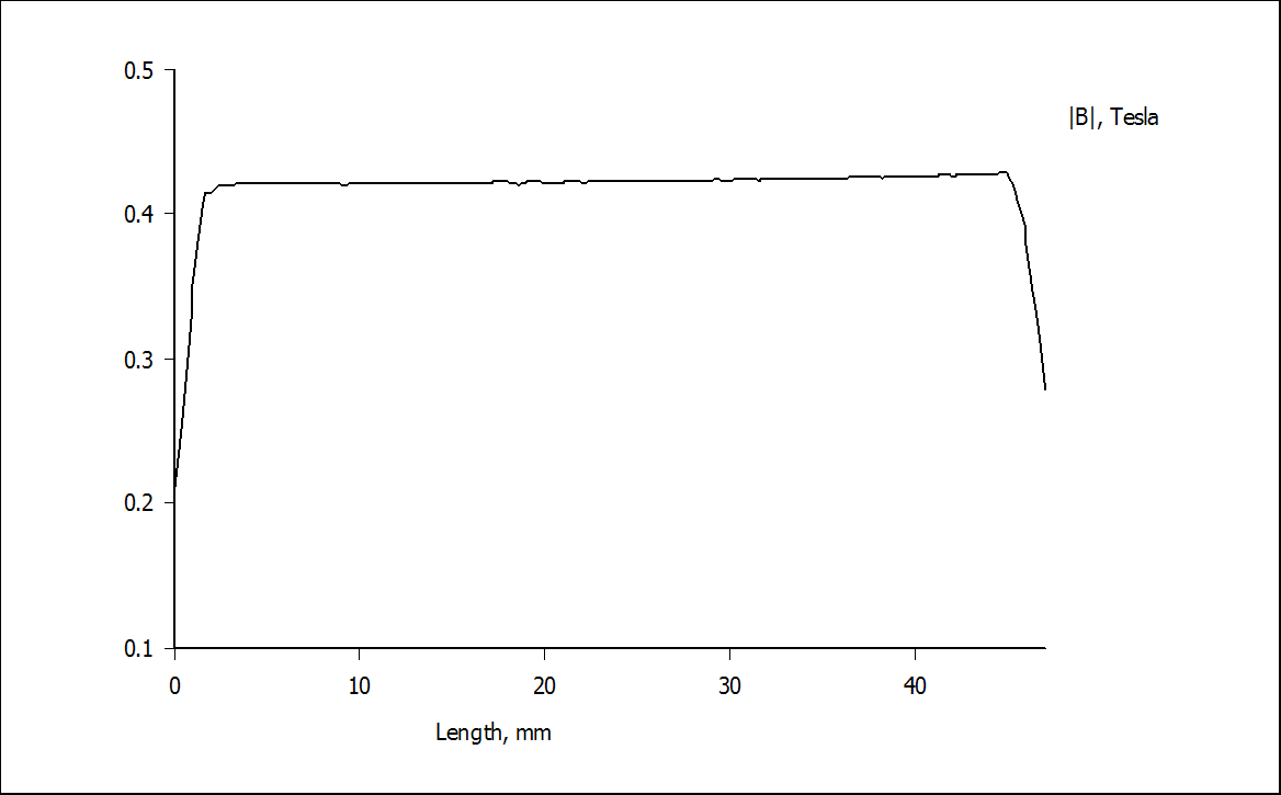

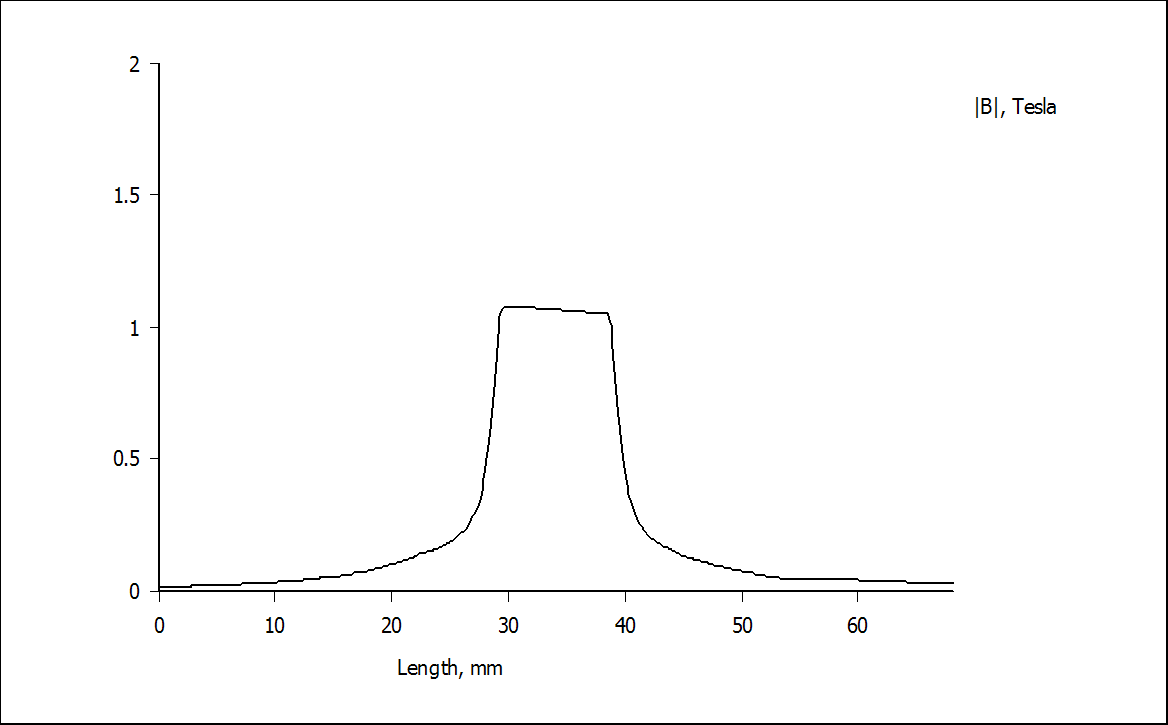

Since evaluating the BL curve is a pain in the @ss, and FEMM is unable to simulate AC frequencies with permanent
magnetic fields, the BL curve is not entirely precise. I mean, shorting rings will be used, and by changing the
direction of the current in FEMM, the BL curve also changes. btw. the BL curve itself (mathematically) is an integral
of the flux density in regarding to the coil.

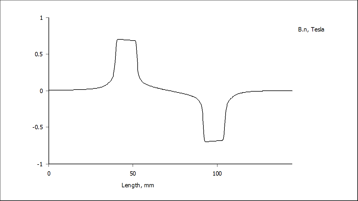

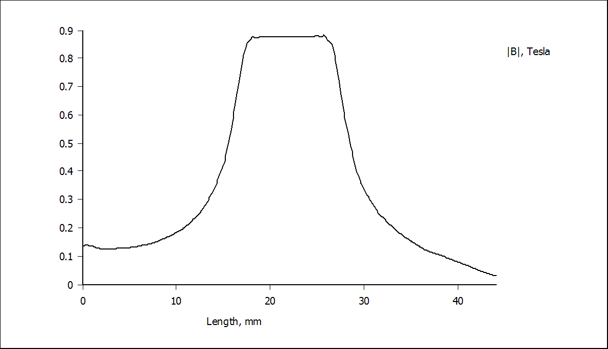

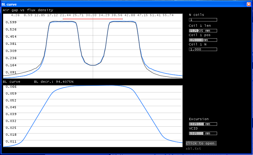

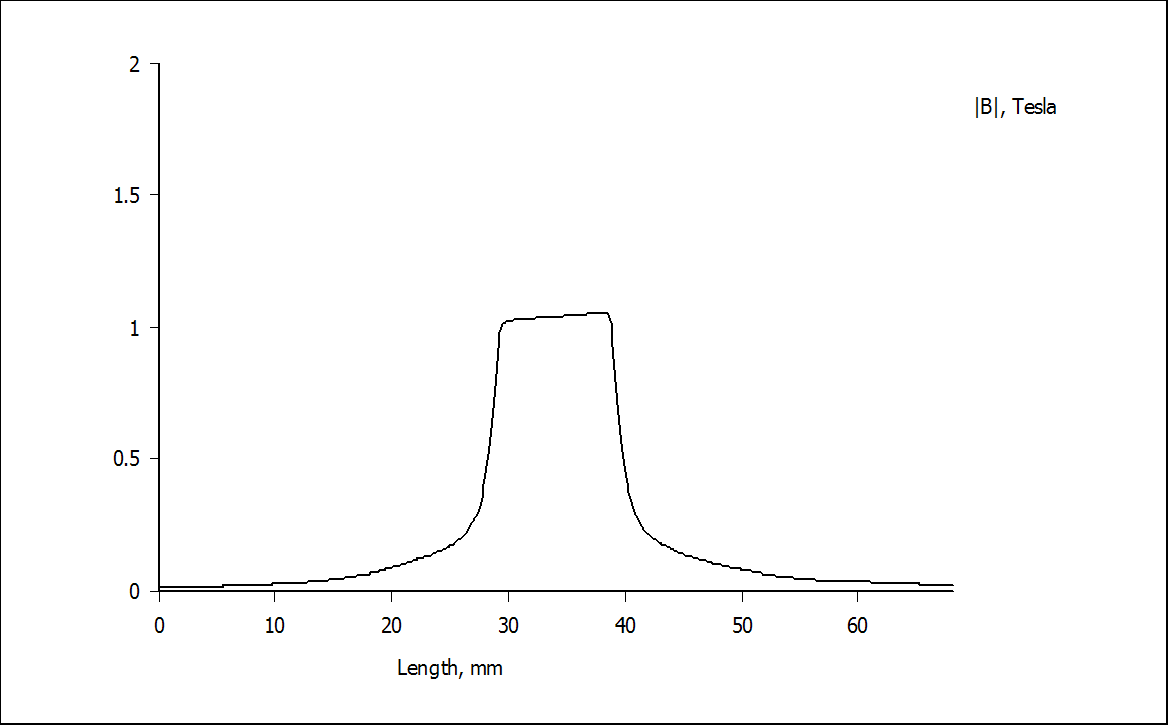

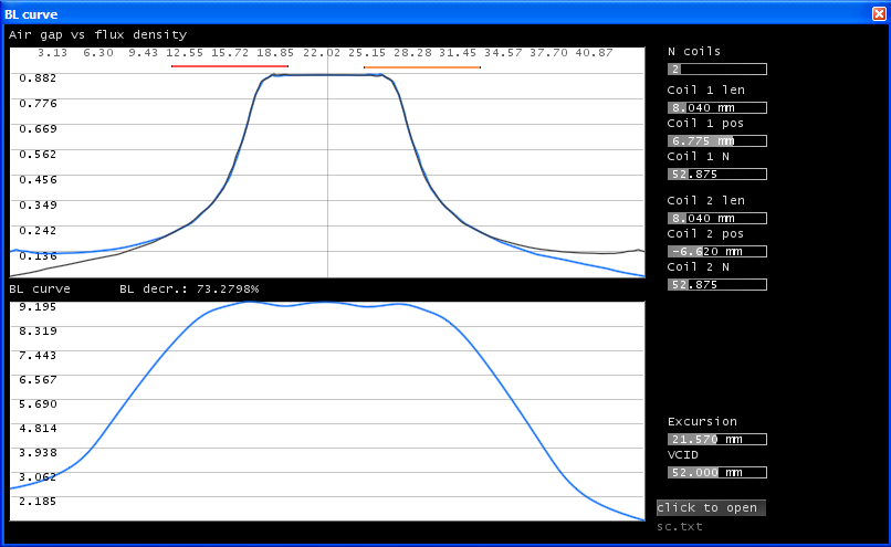

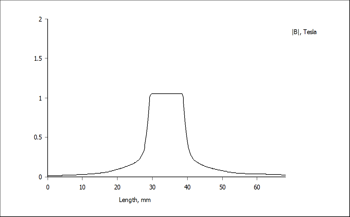

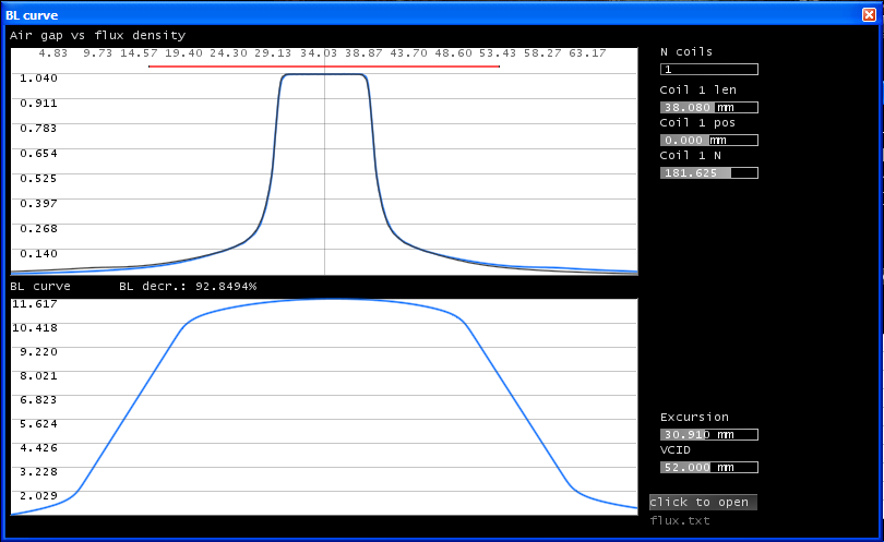

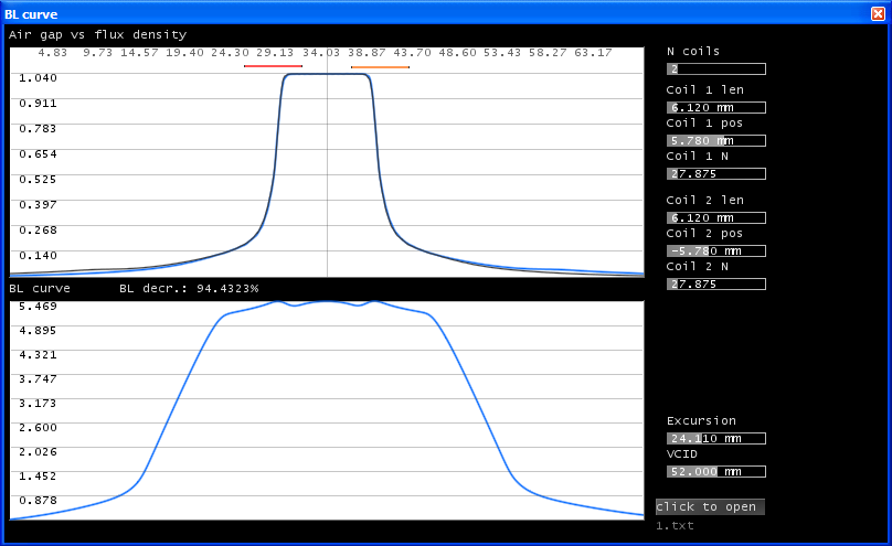

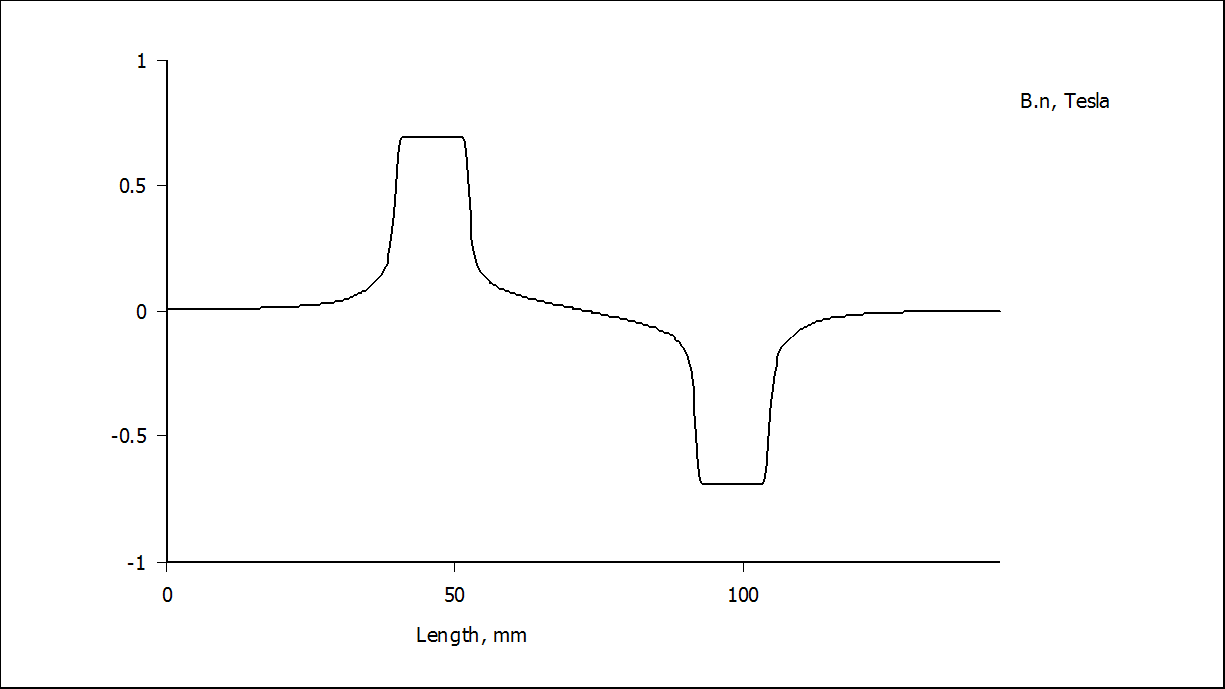

So, here is another app. that interprets the 'air gap vs flux density' curve generated by FEMM:
http://s5.postimage.org/xdkvtknlz/motor01_flux.png
http://s5.postimage.org/u9a7ws6tj/app02.png
http://s5.postimage.org/n7caal37r/app03.png
and generates the given BL curve for it. With this, basic distortion checking is simplified.
it is a simplified model, it doesn't take lorentz forces and so on into account so it is not a FEA.

Let's take it longer.
You agree that this is just a simplified model. FEMM takes the permanent field of the coil into account, but - in my opinion - it does not matter, because it also changes with the direction of the current, and if you change it to an AC waveform it can be reduced / or almost completely eliminated by a shorting ring. This is what it's called flux modulation as described by others many years before, and also influences the field of the permanent magnet itself.
FEMM flux for DC coil zero positive & negative currents:
Let's ignore them now.
From our perspective, the distortion caused by other things like the spider, surround, or intermodulation distortions are irrelevant now.

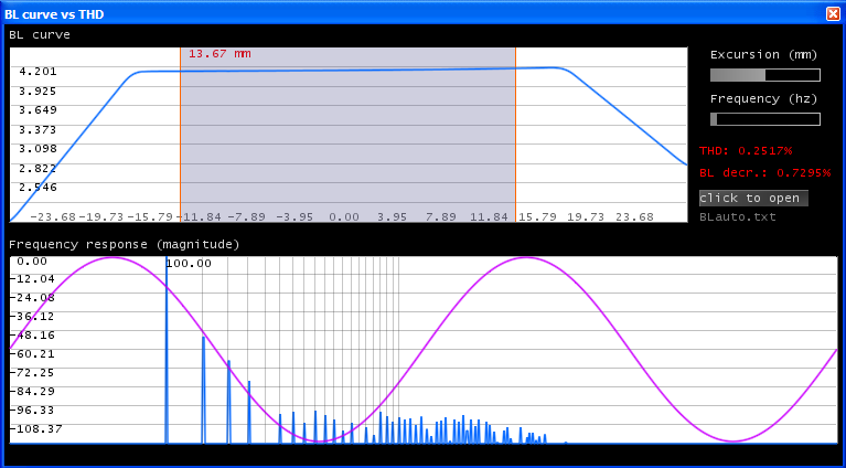

Here is the sample BL curve which is generated for the test subwoofer above for a 38mm voice coil:
The prediction shows that it has a BL deviation of about 4% for 10mm and around 10% for 13-14mm. It follows the typical rule that BL deviation of 30% results in around 10% THD but this is an oversimplification. First the motor structure itself is somewhat optimized since it is an undercut & extended polepiece.

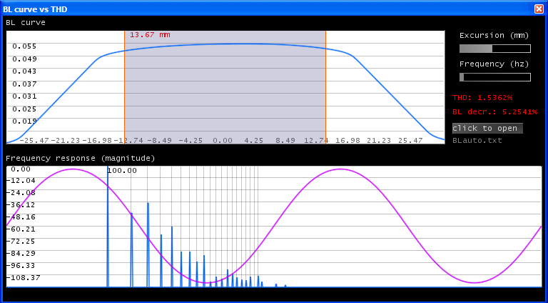

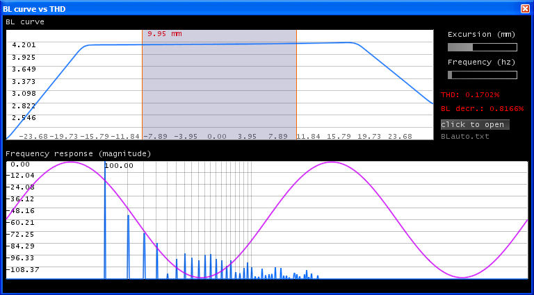

Next, I increase the length of the VC to 45mm:
The distortion figures are improved, 2nd and 3rd mainly. This is a common behaviour/solution but IMO not the best one.
(note here that the evaluation also depends on the quality, but i wasn't able to recognize any improvement above a certain point)

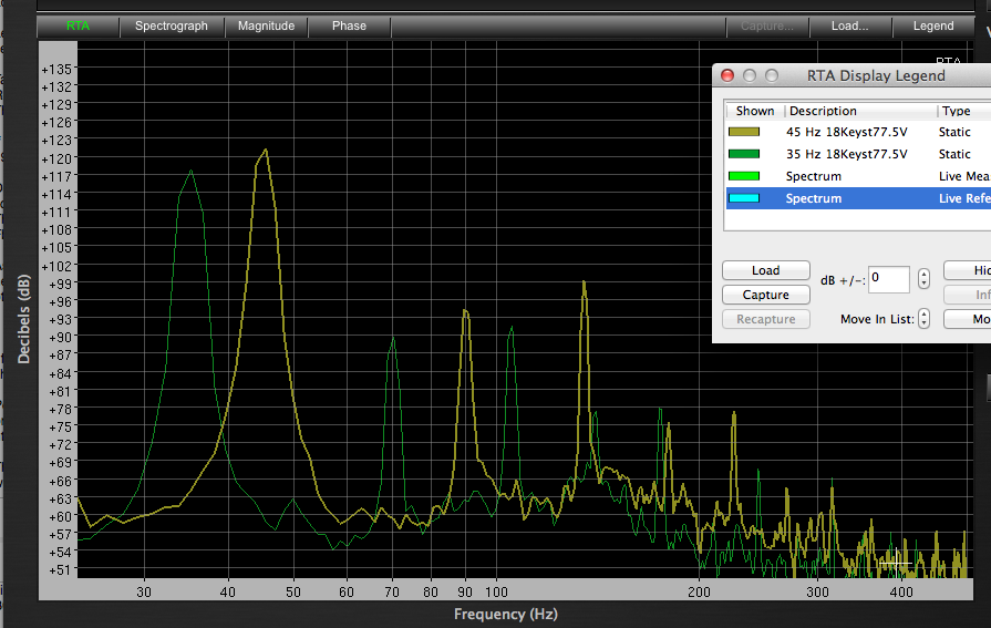

One of the best 18" in regard to low BL distortion and hi Xmax is the B&C18SW115, but it's price has gone up to more than double what you want to pay due to cost of the neodymium magnet structure.Well, then which subwoofers would you recommend me for low BL distortion @ hi xmax? prices around 300$.
maybe you have custom build subs. i would take a look at them then.
A close second is the ceramic magnet BC18TBW100 at around $349.
You can see distortion results using the B&C18SW115-4 in bass reflex and tapped horn enclosures here:
http://www.diyaudio.com/forums/subwoofers/184992-tapped-horn-vs-bass-reflex-case-study.html
I have never pursued open baffle cabinets, but I can say that a pair of B&C18SW115 run open air driven to 15 mm excursion at 20 Hz have very little distortion and enough output to make me feel ill for quite a while after only a short exposure during break in.
The suspension did loosen up a small amount (perhaps 2 mm) after several hours running around Xmax.
Art
Nice drivers! with good sensitivity.
(It would be great if manufacturers could share the details of copper wires, diameter etc..)
Thanks for the info.
Never used tapped horns, have to do some research before i can comment on it. Pretty backwards mounting
What kind of software is that you used there? If there are distortion measurements for pure sine waves, they are so interesting
p.s. this is the first time I saw h0 as "EtaZero" in a datasheet

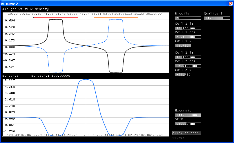

I continue..

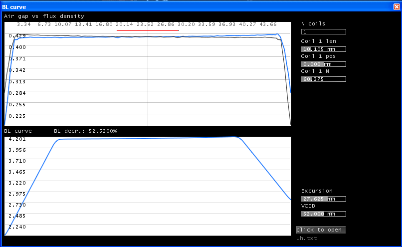

One would try to use an underhung design, but have it's own deficiencies for extreme huge top plates, let's see a flux curve given by FEMM for a 45mm top plate design (average steels, magnets):
very good indeed! but can you see that it's not entirely linear? what if you want a design with more than +-14mm?
It won't succeed unless you use high quality materials like pure iron. It start to saturate and you have to increase vcid this results in higher cost, but IMO still the best solution.

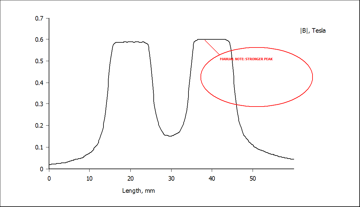

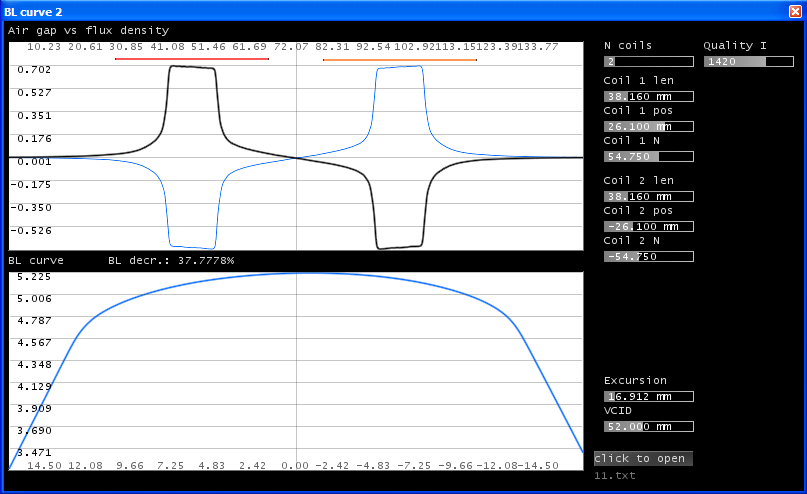

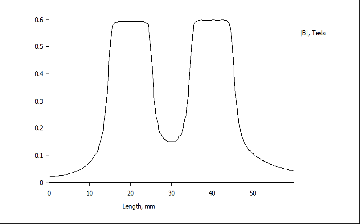

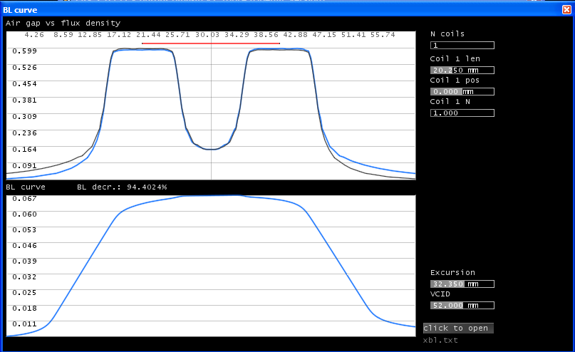

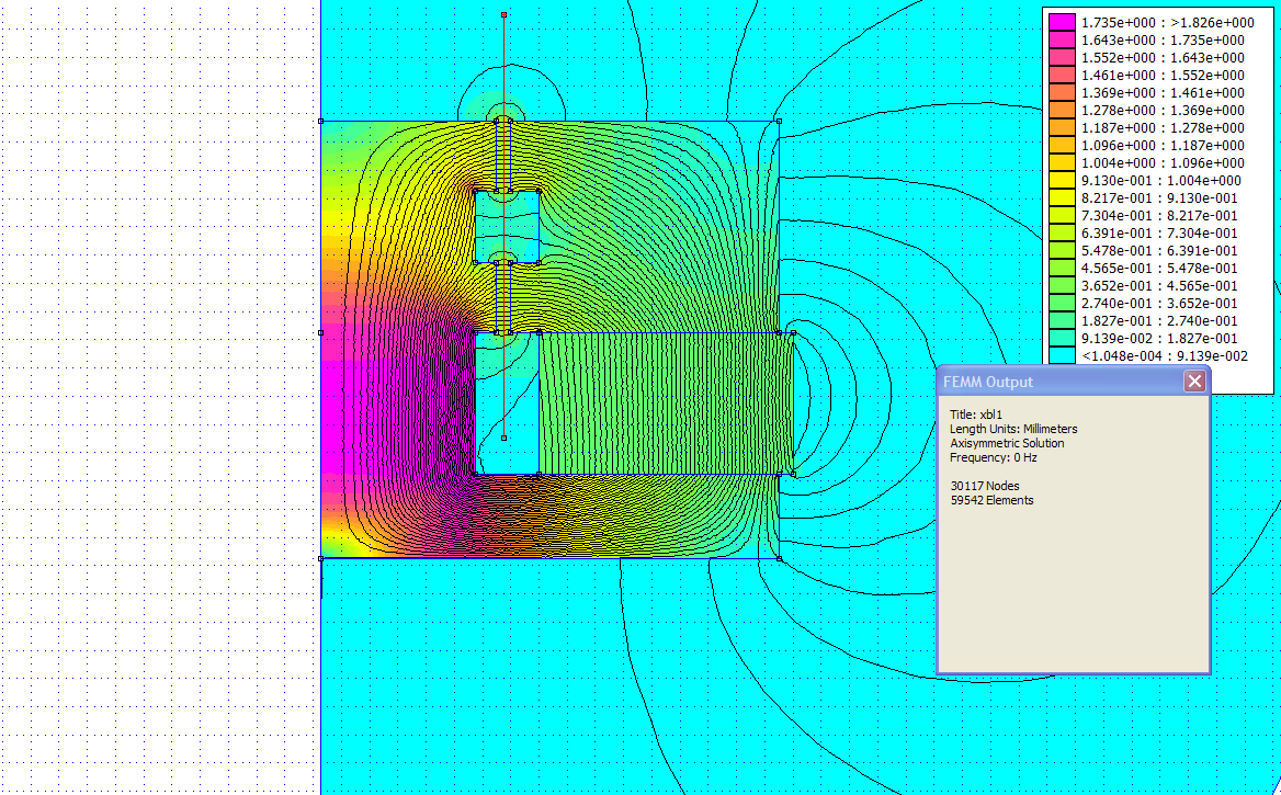

Next an XBL design:
not bad, better than overhung but not as good as underhung. however, it is possible that it generates more high order harmonics than UH/OH. this is why the THD is not representative. It reveals that something has a certain degree of harmonic distortion, but what harmonics? 2nd 3rd? Here high harmonics are generated (in theory) but (i'm skeptical) i would be curious in real-world examples.
btw. i think the xbl is a clever one, but let's see what happens when the voice coil is 'mis-wound' :
see the peak in the BL curve?
it requires careful engineering. IMO top plates should not be made of laminations like this:
This might worsen the reluctance and more flux will flow on the low reluctance path.
The problematic part in a finished subwoofer that you won't be able to authentically measure BL distortion because of the suspension. It requires special machines. Therefore i'm trying to predict BL distortion as much as possible.

I used the Smaart program to look at the actual distortion speakers have when driven with a sine wave tone , an example showing 35 and 45 Hz at 77.5 volts(1500 watts in to a nominal 4 ohms) is posted below.
Using the distortion calculator harmonic distortion levels can be determined.
Slowly.
I really have no Klippel experience, just have heard others write about it, and how the B&C neo drivers have the best BL charts.Super info.
Both 2nd & 3rd harmonic @ -28dB and 4nd & 5th harmonics @ -40dB, 7th @ -51dB, close to inaudible above 400hz.
This is at xmax i suppose?

The Keystone excursion maxima is right around 45 Hz, at 77.5 volts it would be around Xmax (Xvar), 30 mm peak to peak.
At 35 Hz, the excursion is probably only about 8mm peak to peak.
The suspension really puts the brakes on excursion above Xvar, the BC18SW115-4 would probably burn up before it hit Xlim.
Although I did not measure distortion, the driver sounded OK at 120 volts 60Hz, three times in a row (it was testing mistake), about 1 second per time.

Here is a split-coil model.
First I tried it on the existing flux curve of the optimized subwoofer and got worse results:
was sceptical and did the Bl curve evaluation in FEMM, the result were the same:
mm BL
5 5.54122
4 5.70404
3 6.03851
2 6.35937
1 6.46567
0 6.48344
then I realized that a split-coil model is quite sensitive, it does matter were you put the coils and how:
so, here is a newer FEMM model for split coils, and the flux curve, the result is generally good:
i will read through the Keystone Sub thread you posted before.
Understand. sure they have their proprieraty stuff for sims.
mm BL
5 5.54122
4 5.70404
3 6.03851
2 6.35937
1 6.46567
0 6.48344

Next a JBL differential drive structure:
As expected, the even ordered harmonics are very low in level due to the symmetry,
Note that the flux curve is evaluated for 0A. If we set the current to 1A, we basically arrive to the same BL curve as would give by FEMM:
The BL curve is no longer symmetric as well as the flux curve.
(at post #1 i mentioned that the BL curve evaluated by FEMM is not symmetric, and also depends on the direction of the current. however, in real world we never use loudspeaker drivers with DC current, therefore - IMO - evaluating the BL curve without taking the DC currents into account is not problematic. i.e. we can evaluate the flux curves for 0A. so the application won't take the the coil's own field into account, this is why it's simplified)
Since i'm not exclusively interested in OBs, i may build the design one day
