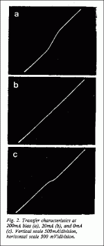

Mosfets are notoriously very non-linear in the low conductance region. When you measure output with the scope and determine it is no longer showing crossover, did you ever look at the gate drive signal? I bet the fb loop is at task to 'correct' lots of error around crossover. (of course fb doesn't actually correct errors ) Mosfets have lower transconductance than BJTs so they need more bias, at least a couple hundred mA. I prefer a bit more.
I have observed in my mosfet EC amp the gate drive error signal or 'distortions' at different bias levels. Even with class B bias, the output showed no crossover but the gate drive had much 'error'. With a few mA, the error is still very significant. It took about 300mA to almost completely get rid of the crossover error in the gate drive. Unless you are class A, there will always be some bit of crossover distortion in there. Your fb just shifts it to an inaudible frequency band. BJT's have very high transconductance compared to mosfet and do not need lots of bias to have optimum crossover. If you’re fretting over a few Watts of power, BJT’s are your friend, I suppose. As for me, the substantial increase in SOA for the mosfet more than makes up for a few extra Watts of heat.
So long as the sine wave looks good into a speaker and it sounds good to the ear then I am happy with that.
The crossover distortion clearly goes around 5mA on my complimentary MOSFET amps.
