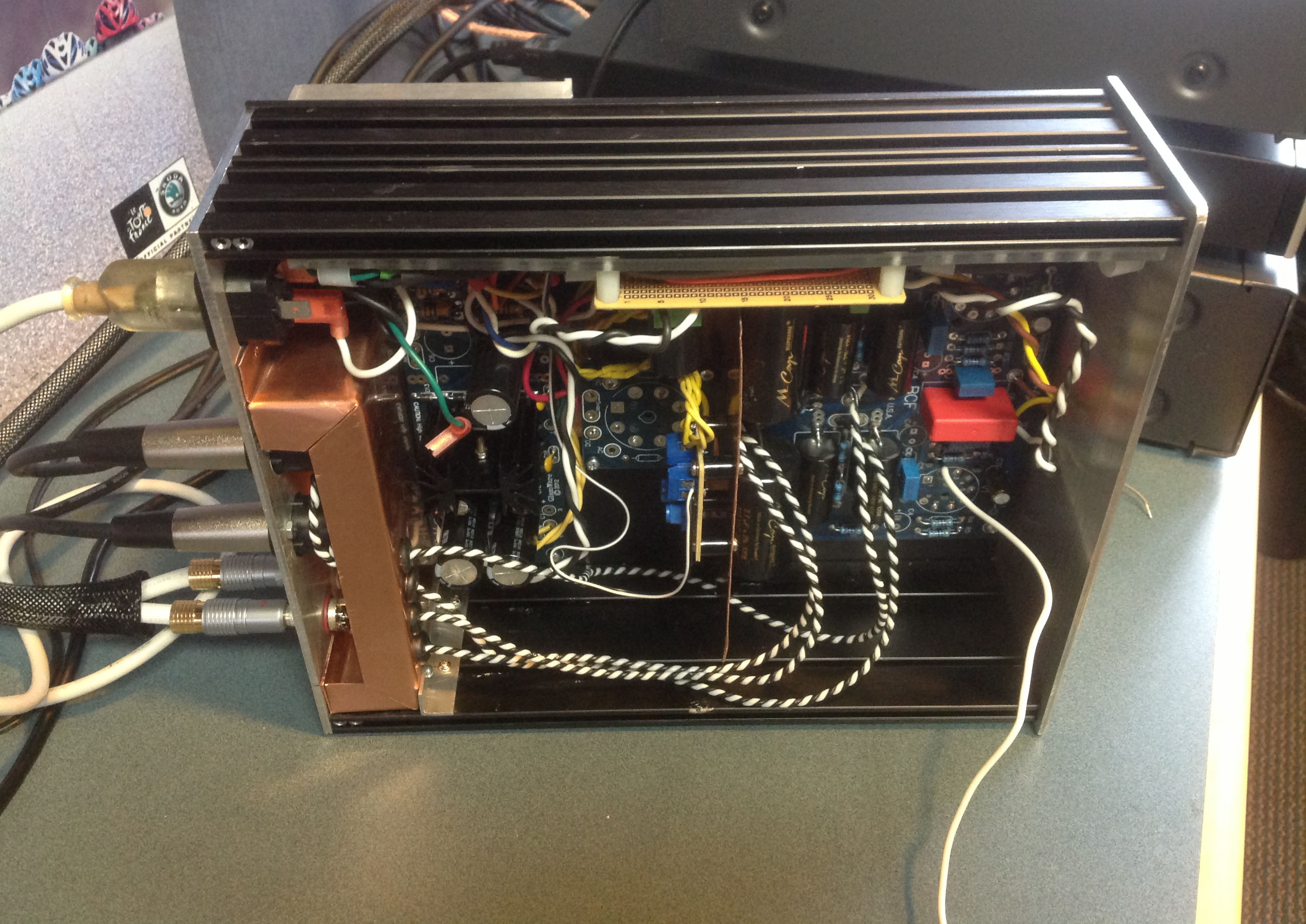

In the process of trying to fix a major hum problem in a tube line stage, I stumbled on a weird temporary solution. I think this weird fix is trying to tell me what the underlying problem is, but being relatively inexperienced with electronics and tubes I haven’t a clue.
Background and sad story of woe:

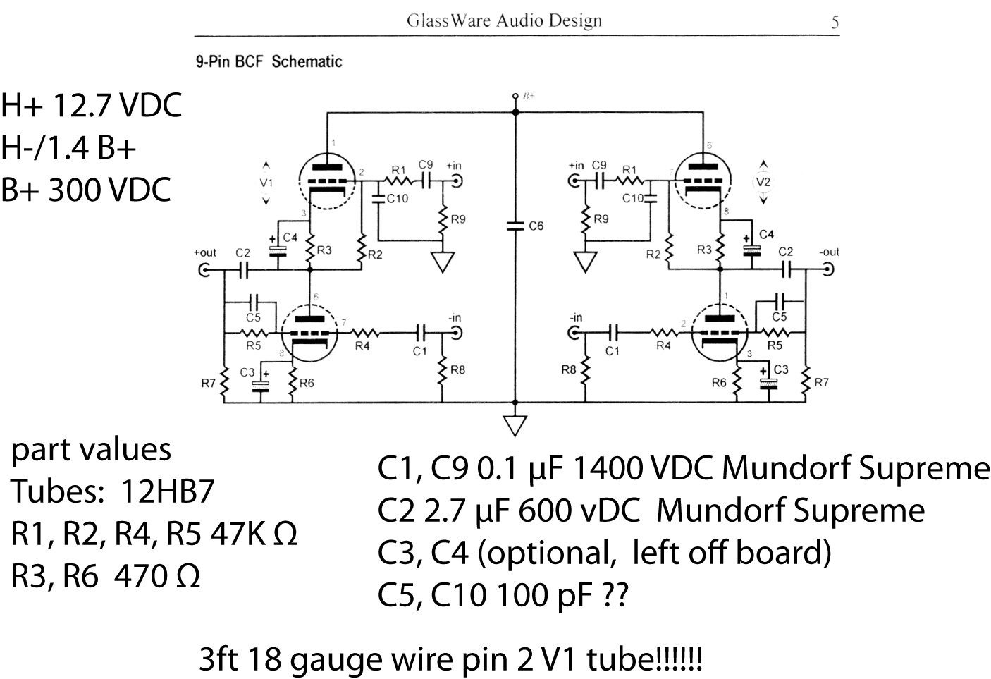

For the output stage of a DAC I choose to use John Broskie’s BCF_9 broskie cathode follower board (to take the balanced output of the DAC and convert it to an unbalanced signal for my audio system).
John Broskie from GlassWare audio design has an excellent reputation for making decent circuits and PCBs but unless there is a missing or broken part he doesn’t respond to emails for technical questions like what follows:

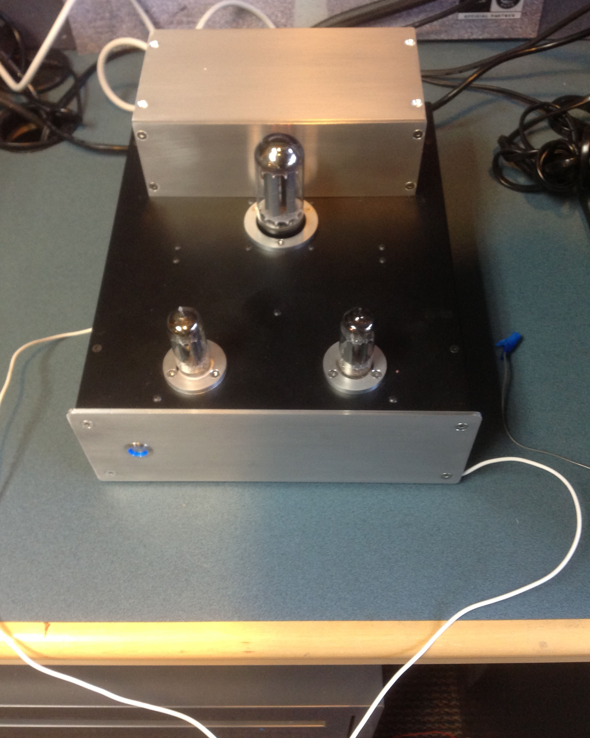

As you can see from the pics the build is nearly complete. I probably should have first tested the BCF_9 board before installing it but I thought I would just go for it.
Couple of days ago I checked the power supply voltages (H+ 12.7 VDC, B+ 300VDC, H- set to 1/4 B+), installed the tubes and was dismayed to have a major hum/buzz from the left channel. Also I would get a repetitive ticking sound.
Right channel is quite. Sound is overall very good from both channels but the hum/buzz/ticking from the left channel too loud to take.
I swapped tubes, tried a different set of 12BH7 tubes, checked all parts to make sure they were the recommended values (see circuit diagram), doubled checked with connections and resistor values with VOM, checked and reflowed every solder connection (twice). Still the left channel hums/buzzes and intermittently ticks (with or without an audio signal input). Completely disassembled and tested still hum in left channel
Pulled the tubes and the noise stops
Tried to trace the hum using an oscilloscope . I think the left channel noise signal is around 60Hz (compared to a signal generator) but not smooth (more saw tooth like and pretty distorted). But this is my first attempt using a scope.

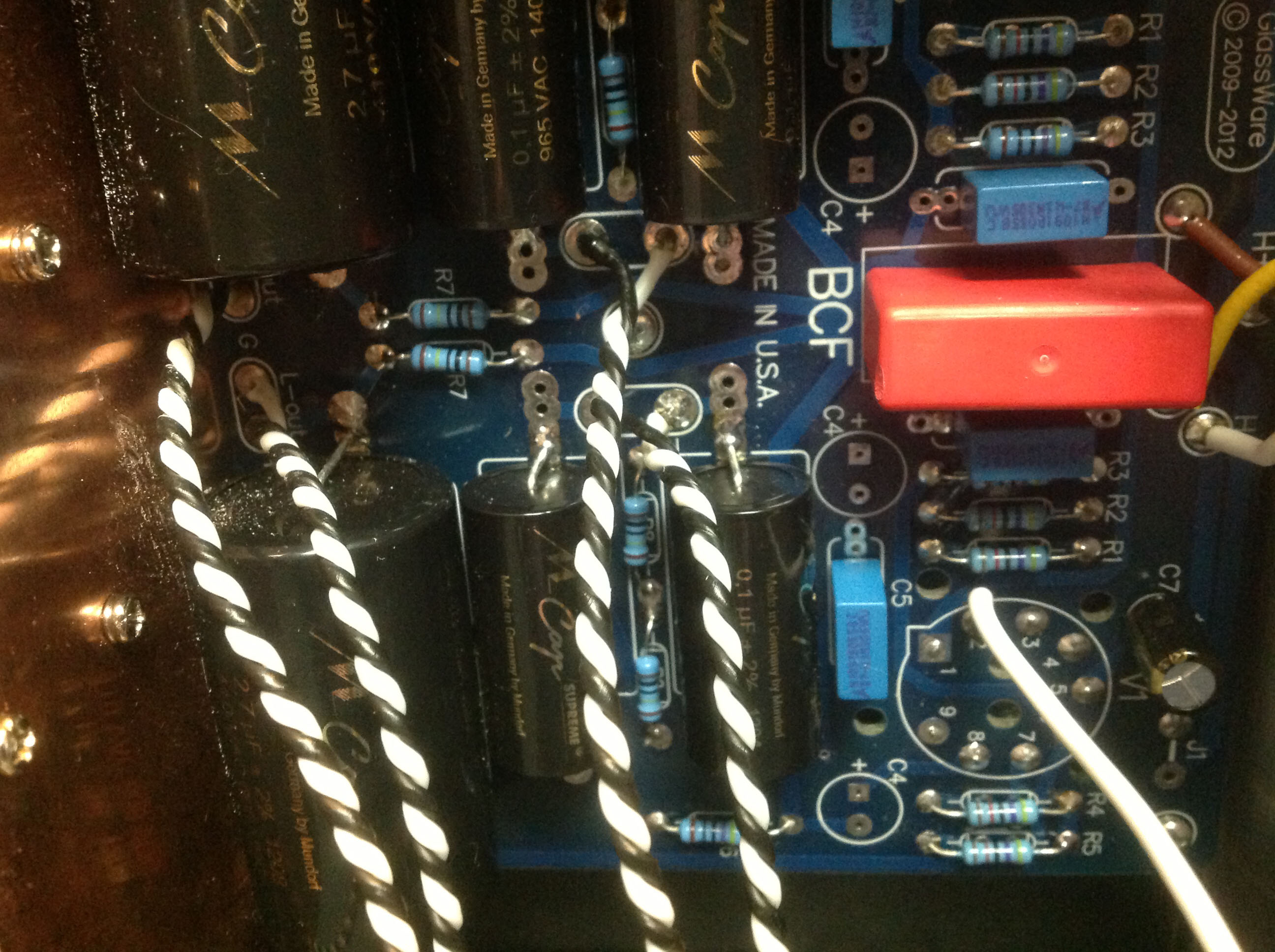

What I did find is that the noise could be readily detected on left channel tube pins (V1 in diagram) 3 and 6.
However when I probed pin 2 or pin 1 the noise stopped. Note: I was using a 1x probe with ground attached to B-/ground. By chance I came upon the fact that the noise also stopped if I touched pin 2 or pin 1 with a test lead/probe that was not connected to anything.
So I tried several lengths of wire soldered directly to tube V1 pin2 (white wire in pics). To completely suppress the hum/buzz and ticking in the left channel the wire on pin 2 must be about 2-3 ft long and needs to be stretched out (cannot be wound into a smaller coil).
This seems antenna_ish to me with the wire influencing some reactive circuit. There must be a bad part or connection somewhere (V1 + input stage?). But how do I determine which component is defective and/or how to really fix it? Beside trying more voodoo?
This is driving me nuts and I would greatly appreciate your advice before I toss this cursed thing out

C5, according to Broskie's documentation on the BCF-9, connects pin 9 of the tube to ground on his PCB design.
The 12BH7 you are using uses pin 9 for the heater center-tap. So if you put a capacitor in the C5 location, you are tying the center of the heater to ground through a capacitor.
Since you're using the B+/4 heater bias (if I read your post correctly), this might not matter... But I'd remove it anyway - it could only cause mischief. (The B+/4 heater bias should take care of the problem of heater hum coupling to the top-triode cathode - good that you used it!)
Also, was C10 part of the original design? I was looking at Broskie's manual for the BCF-9, and I don't see any capacitor from the grid of the top triode to ground in his documentation. It's unusual to put an AC bypass directly on the grid of the triode.
The cap is in a relatively high impedance part of the circuit, and could be causing the top triode to motorboat (if it's a "pop-pop" noise at low frequency)
I'd pull that cap out too, unless there's a good reason for it to be in there.
It's also possible that the C10 cap is picking up a bit of hum and injecting it onto the top triode grid - your gimmick antenna is probably injecting AC out-of-phase (and thus cancelling the noise). Your test probe touching the grid is providing a different path to ground, also cancelling the noise and stopping the motorboating.
All "educated guesses" - pull C10 and C5 and see if it takes care of your noise.

The use of a long 18 gauge wire on pin 2 (the grid of the affected stage) indicates exactly what you surmise: induced pickup of EMF 60/Hz noise from the power supply.

Parasitic oscillations seem highly likely to me too.. I recommend removing C5 on both channels and reporting back.
Also remove C10.
BTW - what is the part number for the C5/C10 (blue) caps? It looks like an Epcos logo, possibly a film capacitor, but the "M1091..." doesn't cross. Possibly there is a "Bxxxx" part number on the side?
C10 will be at about B+/2 potential - if the voltage rating is not sufficient then that C10 cap on V1 might be breaking down as it charges towards B+/2 and causing that sawtooth-like waveform you're seeing.
EDIT - Epcos has such a fun marking system... From your closeup photo, it looks like the 2nd line marking is " B7 -u1M(?)305(?)W(something) ".
If I'm reading it correctly, you've got a 0.1uF cap installed at C5 and C10 locations. Way too big, at least for C10 - take them both out.

Thanks to everyone for their speedy and helpful suggestions. Based upon the phenotype of the noise and your suggestions I removed C5 and C10 (and the meter of additional wire from pin 2). I was elated to not hear anything. Left and Right channels without input are hum free and the motor boating I was hearing is also gone. Weird how happy this made me and the sound with audio input is very nice
The purpose of C5 and C10 according to Broskie’s manual for the new version of the BCF_9 was to generate a low pass filter (<80kHz cutoff) which John recommended if using the BCF-9 as an output stage for a DAC.
Now that I have removed C5 and C10 will the lack of a low pass filter be a problem when I connect it to a DAC? Should I try different values of caps and resistor in the input section that would not create the motor boating and parasitic oscillation?

The lowpass filter circuit in the BCF on the + input is formed by the output impedance of the DAC driver + R1 working into C10, and on the "-" side by R5 and C5.
If you neglect the DAC driver output impedance, the "+" input lowpass filter knee is located at the frequency where the impedance of C10 equals the resistance of R1. Capacitor impedance is calculated using Xc = 1/(2*Pi*f*C) where "f" is frequency in Hz and "C" is capacitance in Farads.
The kicker is that the "+" filter rolloff can be affected by output impedance of the DAC driver. If the driver output impedance is very low (<< 47k) then you can neglect it. If it is higher, it will tend to lower the lowpass knee frequency.
The "-" side filter has a capacitor (C5) across the feedback resistor R5. I'm not familiar with the BCF topology, but it looks similar to how one would implement an active-filter using op-amps. Putting the capacitor across the feedback resistor lowers the gain as frequency increases, although with this technique the gain response flattens out as the impedance of the capacitor approaches zero...
I think Mr. Broskie gave a range of capacitor values because it really depends on which DAC you use to drive the amplifier.
If the DAC output is well-filtered (to remove the DAC audio artifacts and noise present in all Digital-to-Analog converted signals), then you proably don't need any filtering at all.
If the DAC output is not well filtered, it may have residual noise artifacts that are the result of the digital conversion process. The lowpass filter in the BCF is an attempt to clean-up those artifacts.
Note that a simple RC lowpass filter is not going to give a lot of cleanup. The filter might improve a "slightly noisy" situation, but if the DAC output contains a lot of digital noise then IMHO this simple filter won't do much.
I suspect there was feedback from users of the first version of the BCF boards about DAC noise , and the filters were added as a result.
Whether you actually need any filters or not is something you can test by just listening to music in your system. Your present amplifier state is no filter - so you're hearing the full DAC output spectrum, whatever it is.
Note that this filter will do nothing for power-line hum. That is a totally separate issue. The only thing this filter will do is clean up the high-frequency noise from the DAC that might cause problems.
