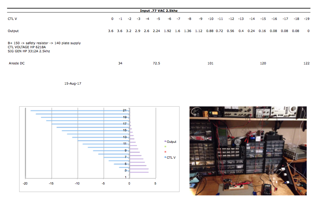

Here is a crude chart. Looks like the control range is just peachy, anode changes more than I thought. The ctl input scaling resistors look like a standard 0-10v could be easily implemented.

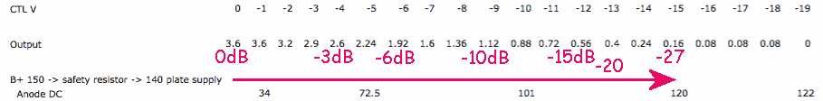

Anode DC shift is about 25 times larger than change in output voltage, that's not very good. I think most single ended vari-mu arrangements will have smaller DC shift.
Yes the patent claims 2v shift so one of my guesses on part value is off , it could be the ef86 but not likely.
But its very useable for my purposes as a limiter stage for classd feed.
Indeed. Birkemeier's patent says "D. C. level shift at plate (maximum). 2 volts" Your test shows 88V. Here's my old simulation of a triode stage's plate DC change:

Not much different from your test, despite radical different tube and current.
Dunno if your implementation differs from Birkemeier's, or if he was just wrong.

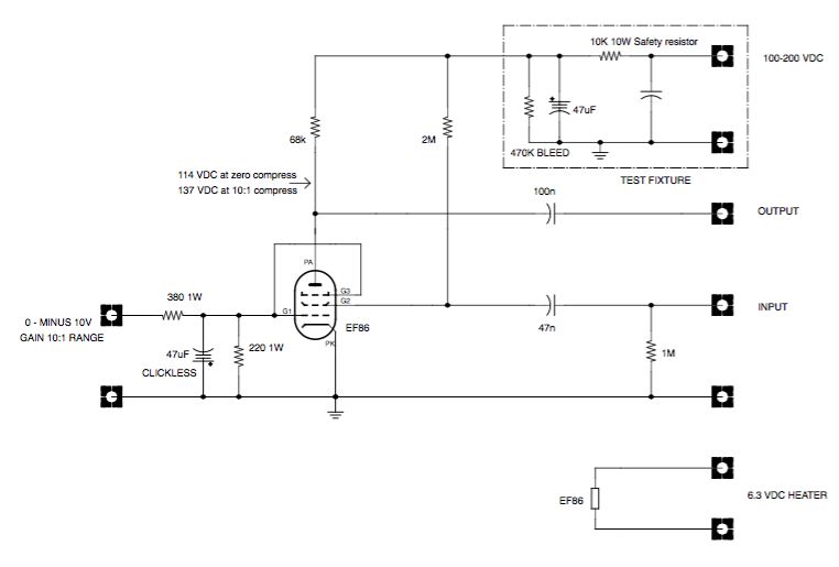

Anyway here is a slight update. By changing screen and/or plate load resistor its possible to minimize anode dc change. I played with it this morning and found easy to improve. The down side is distortion goes up slightly- so its a trade-off between anode VDC vs compression and open loop distortion. The distortion still tracking as before. G3 seems to not care much where it is tied.
ANODE DC:
Zero compression = 114 VDC
10:1 compression = 137 VDC

> ANODE DC:
Thanks. Something like the claim.
> This topology is used in a lot .... to eliminate space charge
I would dispute "a lot", but whatever.
And while the connection is similar, the Space Charge tubes took G1 to a steady high positive voltage, and didn't have a G3.

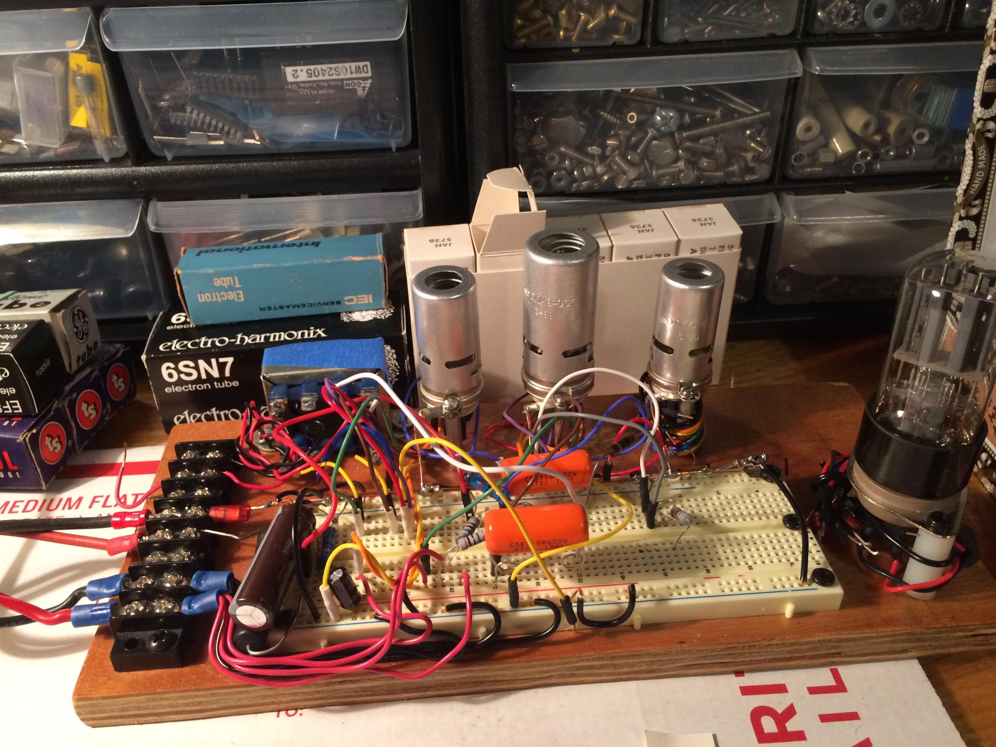

This (Birkemeir) VCA is really astounding to me.
Distortion is now down to 0.15% across a 9:1 range open loop accomplished with resistor/coupling tweek.
Testing again this week with ARRL side-chain.
After that will give a try 6SN7 to xfmr PP 600 ohm output stage.

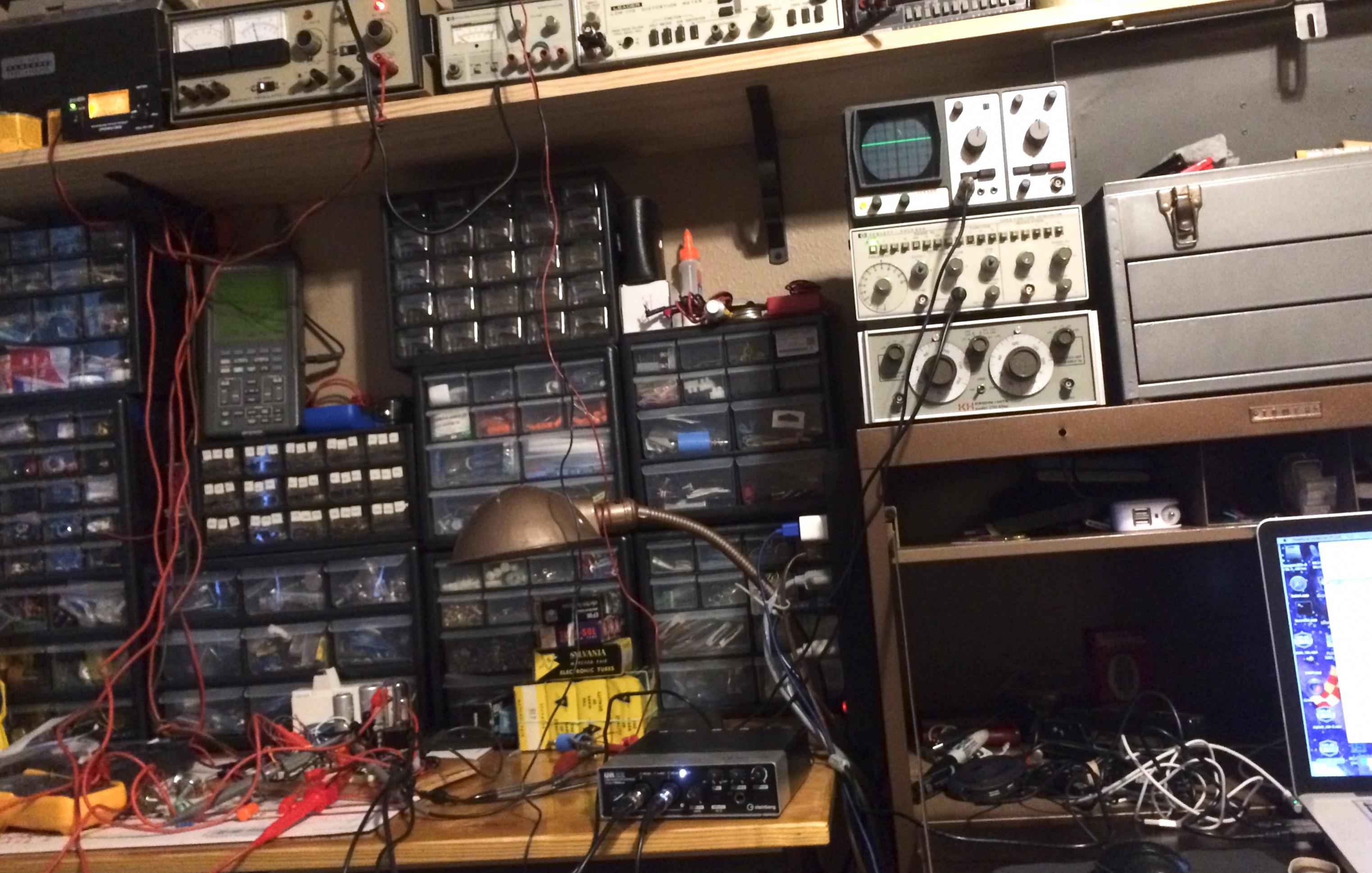

Plugboard in pic is non-standard using a contact strip on every other row.

ok now the DC shift from zero compress to max exactly matches patent. 2 VDC max with 150 V supply.
The issue was two things, measuring static DC in/out is not how the circuit works in real time, and the measured dynamic shift is *RMS* signal. next stage blocking does not occur in operation.
The sidechain is not shown but based on what I’m seeing it was similar to the ARRL circuit. not exactly though.
The sidechain is DC and transformer coupled.

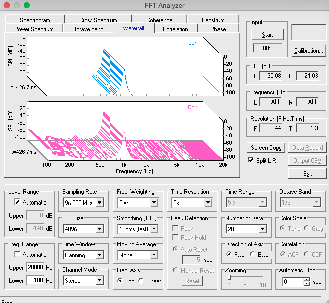

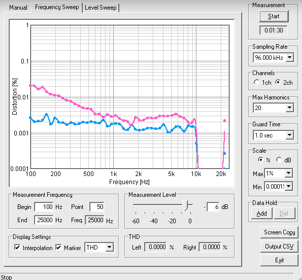

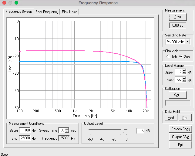

Here is the THD proof, I use a manual distortion meter for initial rough-in then the PC analyzer with Steinberg UR22 as final test. These are the measurements for the circuit operating with zero compression. I'm not sure a EF86 is capable of such low distortion theoretically without NFB. So there must be something going on inside the tube emulating NFB? The gain of the circuit without any compression is X2 (6db). Blue line is the UR22 looking at itself. Magenta is the EF86 circuit. The UR22 hi-z input is used for ef86 channel.
150 VDC, 6.3VDC 6db gain.
