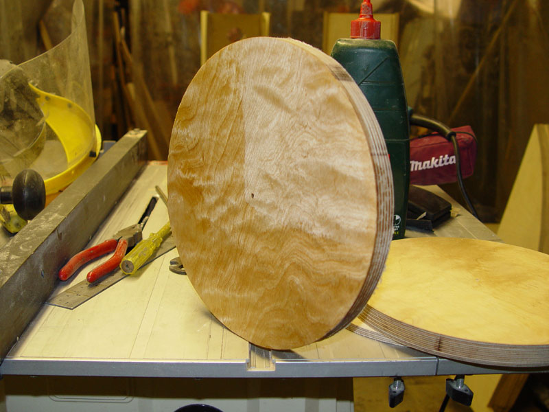

How do you finish good quality plywood?
Using russian birch ply I've sanded down with 180 grit and applied danish oil which results in a blotchy finish. Trying it over an undiluted pva base makes the finish even but with a bad surface finish.
Is the best method to apply many diluted pva/water coats and sand down each coat etc. before applying any oils/waxes?
Please share your favourite method of finishing ply to give me some inspiration! ;)
The 1/4 slice is the one applied over the PVA.

The blotchiness you describe may be tearing in the grain. Plywoods are prone to this because they are peeled and not oringinally flat. I suspect this because the light spots do seem to follow a certain alignment in the grain.
Try sanding with 320 or finer... birch is hard as hell and will reward your results.

The blotchiness is caused by the same effect as solid wood: differences in grain absorbing the colour coat to a varying degree. IME, the fix is the same as with solid wood: apply a sanding sealer as a first layer before you apply your colour/finishing layer. With birch ply, I've done sanding sealer + natural colour stain + polyurethane protective coat and was very happy with it. I use MinWax products because they are cheap at Wal-Mart.

What you are probably seeing is the oil accentuating the natural characteristics of the wood. Oil is noted for this effect.
Birch can be unruly. Especialy radialy cut or "peeled" veneer as in your example.
If what you have is not appealing try a surface finish like lacquer or water white varnish. Water borne varnishes/poly's and most lacquers will do less to accentuate the wildness of the grain pattern.
Avoid finishes with high oil content or that appear amber in the can.
Most water borne varnishes fit the bill perfectly.
You could also try sanding sealer as a first coat. It has a high stearate content that fills and blocks the grain somewhat for a more even finish. Follow with lacquer as a top coat.
An oil based pigmented stain, not dye, that is nearly the same color as the darker portions of the raw wood can even the tone some too. But it will make for a darker finish.

Seriously, try sanding, by hand, with finer grits... The reason you are seeing white areas is because the light is diffusing instead reflecting coherently. This comes from rough, splayed, stressed fibers at odd angles.

It's defintely tearing. I've just tried sanding with 180 grit and it doesn't get close to flattening it properly. On close inspection you can clearly see the tear outs when you move the piece around under light.
