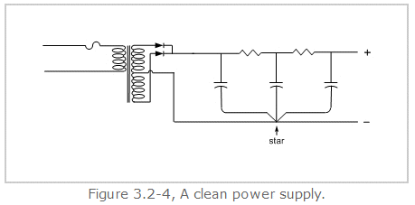

Bipolar Supply, Unbalanced Load
See this, especially Figure 2. Note that the transformer CT goes to one end of the caps ground connection, and the amp/speaker return/chassis grounds all go to the other end.
Funny, the schematical representation in fig 3.2-4 and the connection in between the caps in the drawing look the same to me: a star. If this is a copper rod, then the resistance from end to end is very very small (my guess < 0.5-1 milliOhm) and cannot be considered a bussed ground. If these are terminals that are screwed down to it, the contact resistances might be higher than the resistance of the rod.
What the author meant with "bussed ground" is more like long traces between the several different caps in the PSU filter, resembling e.g. the long power supply strips of a breadboard. This is most likely what OP is suffering from and hence my request to retry the PSU built according to fig 3.2-4.
To my mind we were talking about the same thing, but calling it different names.
I'm guessing the drawing is a hardwired setup, but if you were to place the caps on a pcb, a large copper area in the same place between the caps would act the same.
OK, so you don't understand the basics of grounding. Two rules: every connection has resistance so will drop some voltage so make sure this happens in the right place; every grounded point must have one and only one connection to every other grounded point so no loops.
It is a bus because it is not of zero size and zero resistance. The resistance is small, but 1 milliohm is a lot if you have, say, 10A peak charging pulses. In fact, every star is really a small bus. The trick with grounding is to ensure that these 10mV (or whatever) signals appear where they can do no harm. His wiring is correct: the dirty stuff is at the CT end and then he grounds the clean end at the other end of the copper.

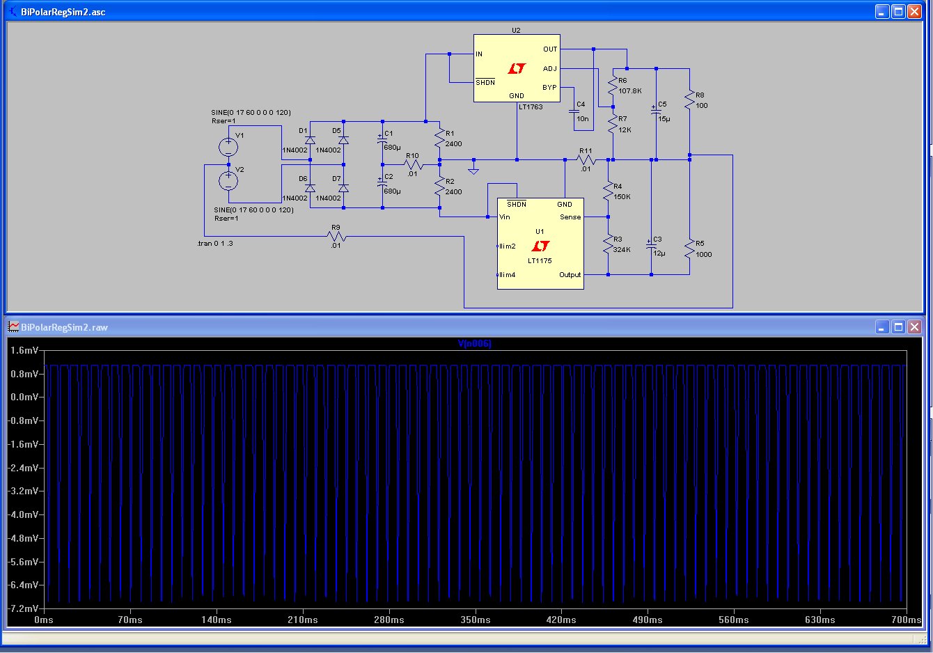

I came across this thread trying to address a similar problem. Hopefully the attached schematic and simulation results add a little more insight to anyone that may still be following this thread or comes across it.
As I feel demonstrated by the discussion, so many struggle with these concepts (myself included). I feel the basic problem is identifying the parasitics. Star grounds can cause as much problems as they fix if the basics of the problem is not understood. However, I do have some fundamental rules I like to follow.
A shield is not a ground return. Make sure you are not confusing a circuit ground with shielding although a circuit ground can provide shielding (so can the positive rail). Account for your return currents. On the later, if it has a goes outa, it needs a goes inta. This is where I see the fundamental problem lies for this situation.
The image of the schematic I have attached includes a parasitic resistance, R9, from the CT of the transformer to the filter capacitors (the xfrm secondary output is represented by two opposed voltage sources V1 and V2). R10 represents the parasitic resistance from the capacitors to the power supply ground. The loads, R8 and R5, hopefully represent the situation that the original poster described. As can be seen by the simulation the unbalanced load causes significant current pulses I(R9) on the CT of the transformer. This is the charging of the filter capacitors. They only charge when the sine wave voltage from the transformer exceeds the diode drops of the rectifier. In addition the difference in the return currents from the outputs of the regulator cause a DC offset current I(R10) on the mutual ground of the two regulator circuits. However, it does not contain the pulsing current because the regulators have effectively filtered it out due to their PSRR and the function of the filter capacitors.
Hopefully this schematic shows that a star ground does not solve the problem if you put the star in the wrong place, like the output of the bipolar power supply. See second schematic. This will induce 8mVp-p of noise on the ground even with just 0.01ohms of parasitic resistance back to the filter capacitors. Connecting it back to the previous circuit but keeping R11 this reduces to below 1uVp-p of ripple on the ground. There is a 1mV DC offset though. Consider this though, a .150” wide 1oz copper trace has ~.001ohms/inch. Ground planes cover a lot of sins.
When the OP built two separate isolated supplies he directly solved his ground current problem. He had a goes outa coupled to its goes inta for EACH supply. With a bipolar supply sharing a command ground the currents add and subtract. You will see the difference and the parasitics are there to show you they exist.
