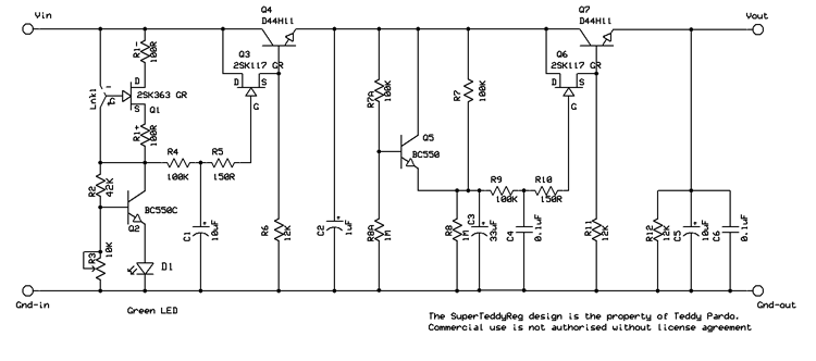

AndrewT said:Hi,
try replacing the input CCS with a high voltage supply feeding a high resistance.
say 10kV through 63k giving a 159mA CCS.
Makes the simulation simpler and also finds whether it's the shunt that is oscillating or the CCS or an interaction between the two.
Andrew, thanks for the suggestion, good idea. Just tried replacing the CCS with a single resistor, 10k in value, fed by a voltage source of 3kV DC, And now, it started oscillating after a few milliseconds, on this computer that it didn't oscillate before. I'm not sure what conclusions we can draw any longer, simulation is simulation.
My interest in this regulator was the slightly better AC analysis performance from 10kHz to 200kHz, when compared to salas' design. However, besides questioning the real benefit of a few dB in that range, now there are even more issues with it, real or not. It suddenly became a time sink. Personally I am very much getting the feeling of an academic exercise, interesting puzzle, that sort of thing.

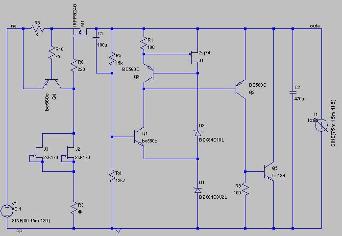

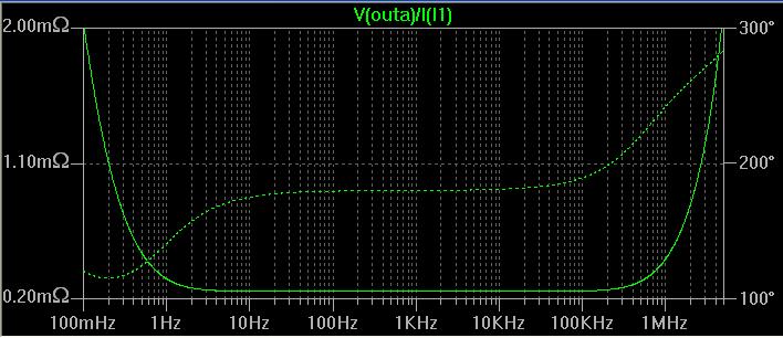

This being the circuit generating these plots. So much for the good news. The downside is that it oscillates for me when running the transient analysis. It would be nice if this circuit could work in reality.
One strange thing I noticed is that a small deviation from the ratio of 1 to 1.1181 in the value of the two resistors part of the voltage divider will completely throw off all the performance.
I don't understand D2 in that location.
It appears that D2 forces the output to ~ Vd2+Vd1+Vbeq3+Vgsj1.
D2 must allow a variable voltage to allow the regulator to compare the voltage at Q1 base to the voltage at Q1 emitter. This may explain why the resistor ratio is critical. It becomes an oscillator as soon as the Q1 voltages stray from the enforced set points.
How about replacing D2 with a resistor or maybe a crd/Jfet/ccs?
Unfortunately this wouldn't (doesn't) fix it. There was a resistor in that location initially. If enough current passes through it it will oscillate. Less current fixes oscillation but the output impedance goes high. Would it help if I posted the currents/voltages as I did in the past?

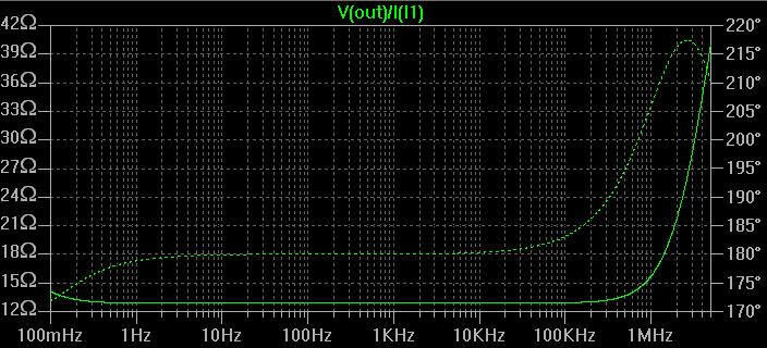

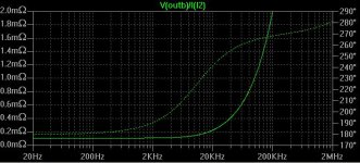

OK, my bad, I apologize. That was a plot of the circuit with no tweaks. 30V in, about 26V out, values as shown on the schematic. Took a bit of time to use Mr. Pardo's suggestions (tweaks to set current through various parts of the circuit). The output impedance with the tweaks is 15ohms across the spectrum

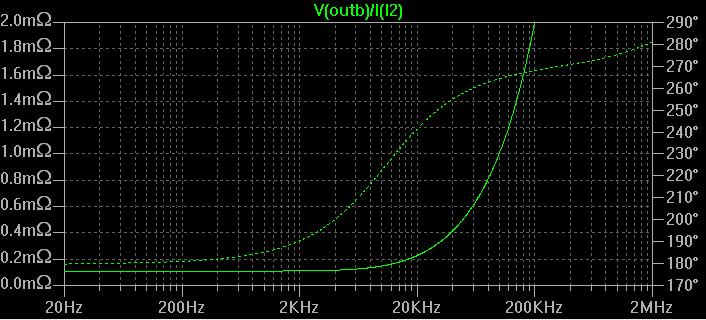

Here's the output impedance of some latest tweaks that I'm trying, but not built yet; will be soon testing it in reality. Couldn't get the Zout lower than what's shown in the high frequency, but I'm not sure I should bother with that anyway.
However, given that it's such a simple circuit, perf board and point to point is even recommended.

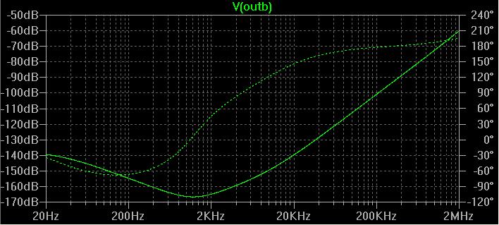

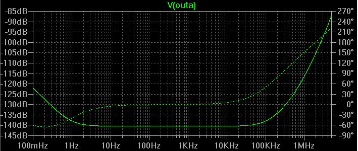

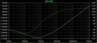

And this would be the ripple rejection bode plot. Let me remind you though, this is just simulation. In reality things may be different. For something true and tried I'd suggest the original salas regulator (see link a few posts earlier).
