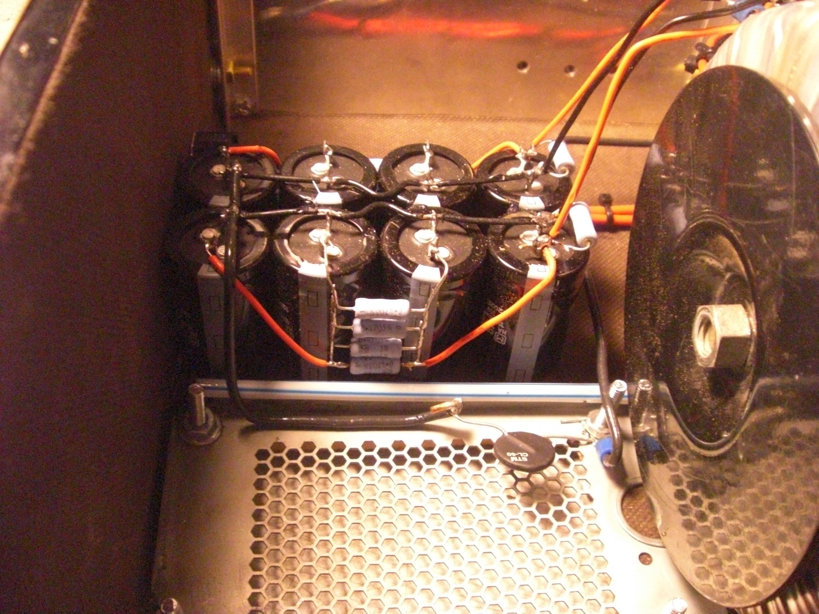

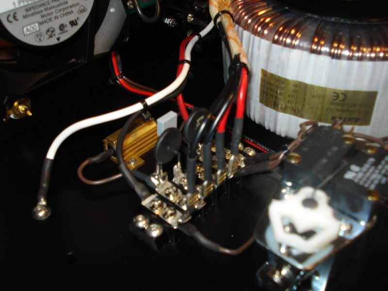

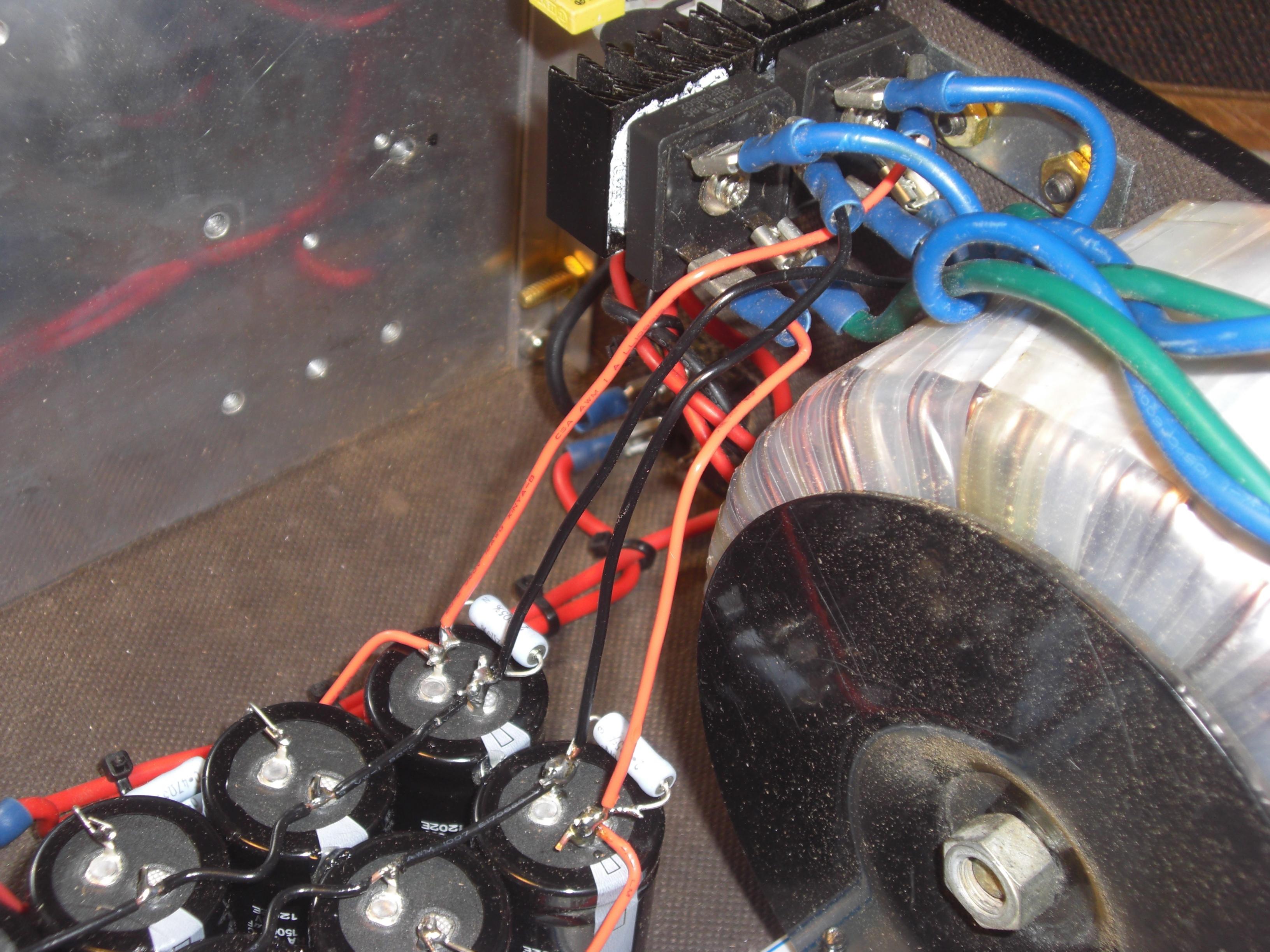

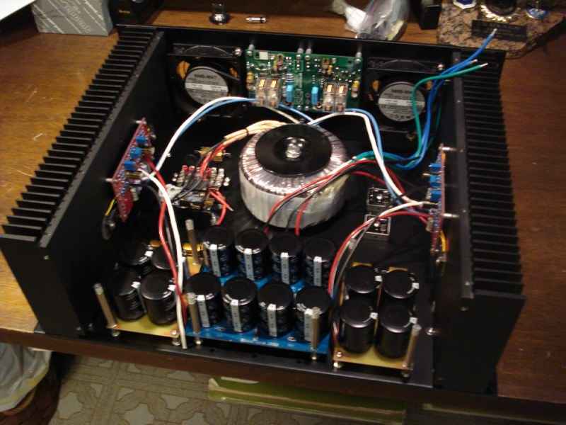

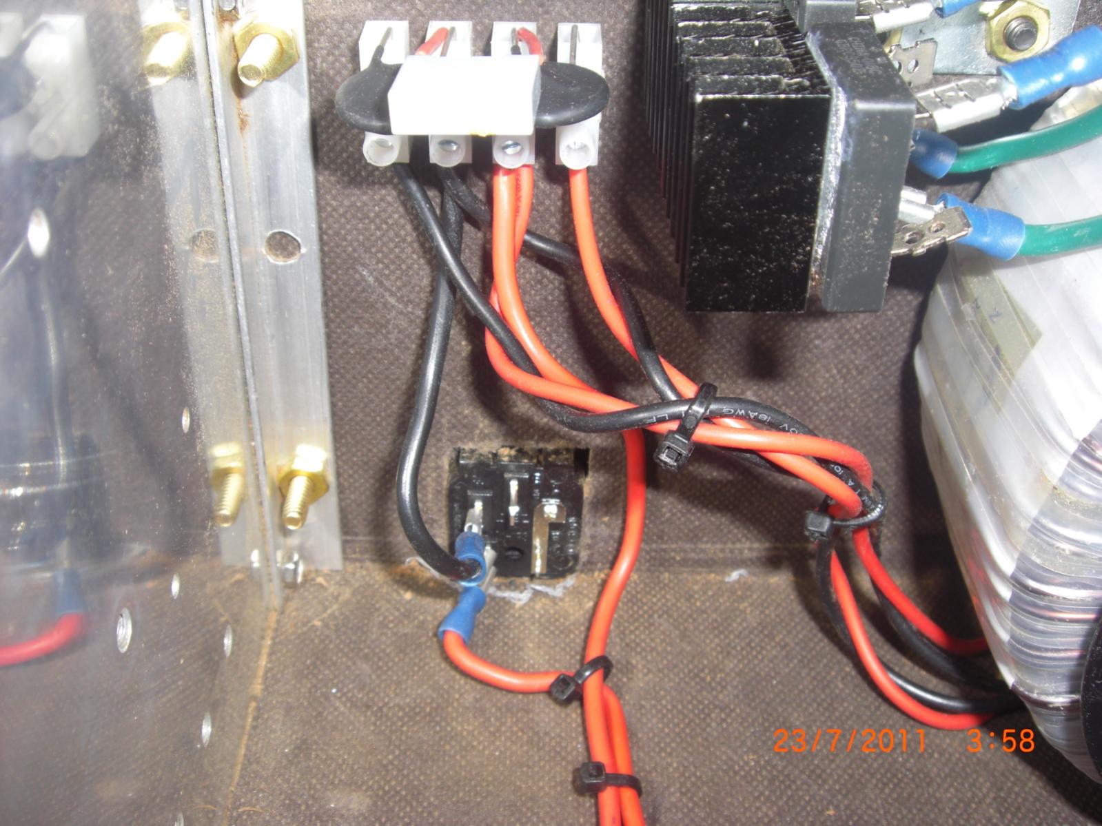

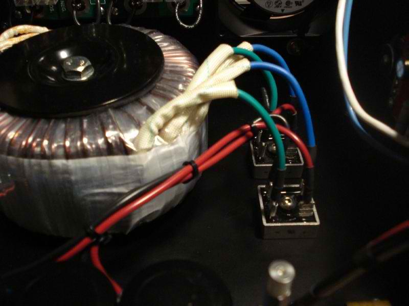

I'm beginning a F5 build. So far I've almost finished the enclosure and started getting the power supply portion built. I tried to P2P the power supply using the First Watt schematic. I thought I was finished, so, I hooked it up to my dim bulb tester (100W light bulb). The bulb is full bright (everything in the power supply connected) and i saw a little smoke come from one of the connections on one of the caps. Does the photos look correct? The transformer is an Antek AN6218 (18v secondaries). With the DC sides of the rectifier bridges disconnected, I'm measuring about 17.7v across the DC side of the rectifiers (shouldn't it be close to 25volts coming out? - also the bulb tester doesn't light up). Also, instead of the .0033 line cap, I have a .0082 in it's place (from an old computer power supply - is this value OK?).
Without caps you won't get DC after the rectifiers, but a rectified sine wave. If you have a true rms multimeter you measure the rms-voltage, so the sqrt(2) reduced value of the peak voltage:
17.7*sqrt(2)=25 V -> ok!
From the photos I cannot see an obvious error, but there is definitely one somewhere.
Sound like a good place to start your investigation

Why do you have the groundstar on the second set of caps?
The first set of caps has a very high current and voltage ripple compared to the ones after the resistor. By the looks of it, those are panasonic caps, I have some of the 10000uf ones, and they are about 0.36 ohms each and have a ripple capacity of about 4A on a good day. even paralleled they might not be up to the task at hand.

On your voltage measurement..... keep in mind you are not measuring pure DC when you measure the output of your PSU rectifiers without the caps connected. Without the filtering of the caps, you are seeing full wave rectified DC, that will be about 70% of your final PSU output voltage. In other words, if you are seeing about 15 volts now, after filtering (and without a significant load, you'll be seeing 141% of your present measurement. That will give you about 25 volts--right where you should be.
Also keep in mind that without a load on your PSU transformer secondary, the transformer PRIMARY will also not see much of a load. Therefore, your transformer will not cause a large voltage drop in the mains voltage--and you'll be applying almost all your mains voltage to the light bulb...therefore, the bulb will be bright. Until you load down your PSU outputs (i.e., with the capacitors, bleeder resistors and amp modules attached [and drawing some bias], yourlight bulb tester will appear to be pretty bright.
You might want to check the gauge of your wiring between your full-wave bridge rectifiers and caps, and within the cap banks. Same goes, for when you wire between the PSU and the amp modules. I think your wiring is pretty thin. I used, if I recall, about 14 gauge wire...... so pics attached for your info.
I have not done a wire-by-wire tracing of your pics. You might want to triple check, and press on from there.

OK, here's an update on my problem. I took a while off and took care of some other unfinished projects and drank more than a few beers while i pondered. I thought about my problem, and why i wasn't getting proper dc voltage after the cap banks. I thought about the bleeder resistors i have at the input of the caps. I was thinking of power taking the path of least resistance ( i assume this is what's happening). So...i chopped off a lead of each resistor to take it out of the mix. BOOM...I'm sitting around 25 volts now. The dim bulb tester lights up bright and immediately dims (I also took the advice and lowered the bulb wattage). I'll upgrade the wiring next (Dreading the thought of having to dig thru my misc. box of gadgetry). Thanks for the insight and suggestions.
