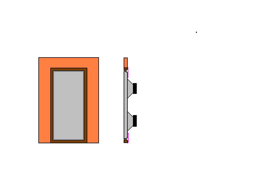

This will be 27-28", which equals 4x 15"
To the best of my knowledge 4x 15" will move FOUR times less than a single one
The chosen Beyma SM212 is special in the sense that its a 98db 12" with +/-7mm Xmax
If we stick to the comparison of 4x 15" it means that we get an effective Xmax that equals a 15" with 56mm Xmax (4x 14mm(p-p) = 56mm(p-p))
The big 31" Fostex has Xmax of 2.3mm, and impressive 96db with a mms of 440gr, Qts 0.69
PrecisionDevices 24" has Xmax of 15mm(p-p), and 99db with mms of 342gr
How much it moves will ofcourse depend on how deep it goes, and how loud its pushed, but I dont expect it will move very much
But it will be interesting to see the weight of all the needed polystyrene
Update
The high density 50mm polystyrene for floors are only available in 500mm width
So, the 700mm round design with tube surround is on hold
May be that the softer poly is ok, or a smaller one is the option
The available tube will decide the size tho
I did found a 700mm LATEX tube, which could be interesting

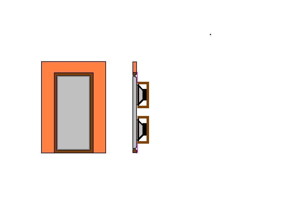

New design is with TWO 12" woofers each panel
Which on its own might give a more stable design
It will be 500mm wide
Height could be like 800-1000mm
Surface would be 4000-5000cm2, which would be like 5-6x 15", each side if stereo subs
Actually, the cost of a second woofers isnt much more than the cost of the additional wood needed for the round 700mm "tube-design"
Rather use the money on a woofer, right

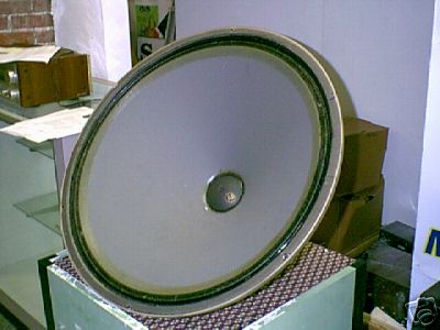

Polystyrene cone -- the EV 30W !

It's indeed much lighter then those big paper cone, thus higher sensitivity.
And motors with 20TM BL and 5~6mm Xmax are not hard to find, so maybe it'll be a very good chance to get a superwoofer with big area polystyrene diaphragm of over 100dB/w

Regarding the round 70mm version with tube-surround
I just realised it probably wont work as smoothly as expected
1. The tube may not have enough control over the planar diaphragm, because of its unpredictable springyness
2. The space between the planar cone and surrounding baffle needs to be very precise, or the tube may push the cone sidewards, when airpressure is applied
There are ways around dealing with this, but its still unpredictable
But still, could be fun just to try it
Well, I did end up going back to the first version with "thread" surround, but modified with using strips of fiber net for surround
And using double 12" which ought to give better control
Surely not perfect either, but I think its the ways to go, if doing this
Beyma SM212 still seems like a fine woofer for this
Affordable low distortion woofer with high sensitivity and 15mm Xmax is a bit rare

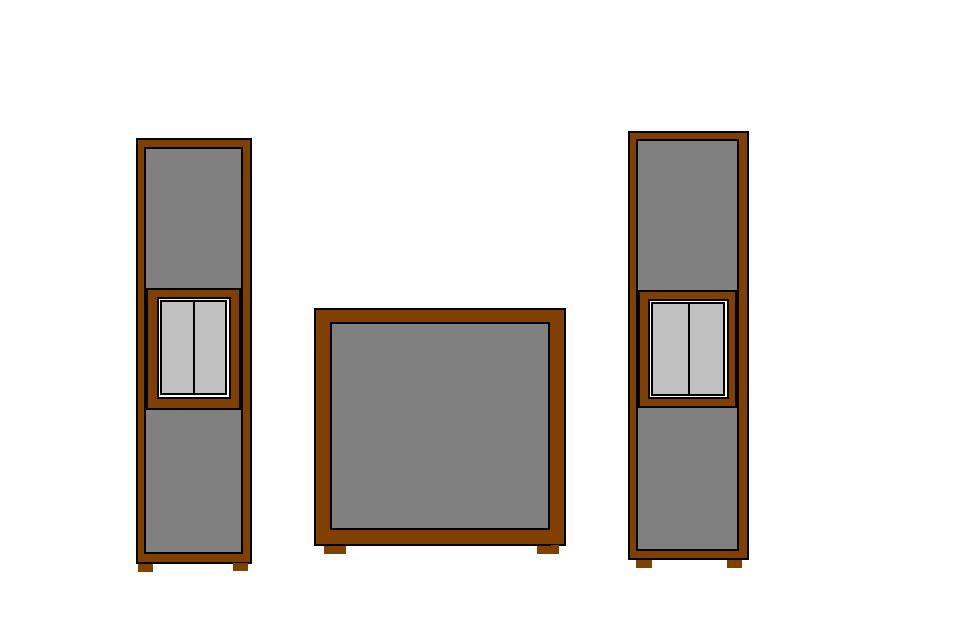

btw, maybe remember that this is for free standing dipole sub only, nothing else

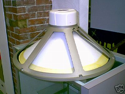

If you want to stiffen that diaphram then use thin aluminium foil. A company called Leak (as well as Kef) did the same thing. Kef used a solid polystyrene cone, where as Leak used a conventional cone shape with approximately 10 - 12mm thick polystyrene.
When i saw this i went searching for a picture on the net of the designer of the cone literally standing on the apex of the driver cone. It was that stiff & strong that it'd take an adult mans weight without breaking
A thin sheet of aluminium foil either side should prevent a hell of a lot of flexing
Found it, click for more info
E2A:- If you look up "Leak Sandwich" speakers on the net you'll find out a load more.

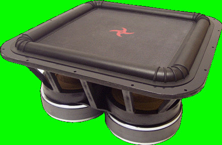

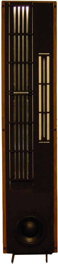

The automotive audio industry has created a few unusual subwoofers like this four motor rectangle speaker in the attached picture. I believe it about 34" on one side using four 15" woofers.
I think you would get the best bass from a push-pull planar similar to Eminent Technologies, or the best Magnepans like the MG20 which have magnets on both the front and back for true push pull. NdFeB magnets can provide good efficiency and have come down in price. A steel frame completes the magnetic flux path, and would have a minor sonic impact to very low frequencies.
A suspension of butyl or silicone rubber will last decades. The membrane can also be clamped into a wood/plastic frame and several real metal springs can be used, and tuned to minimize resonance. The large Apogee bass panels used this frame+springs construction technique. Each springs had a screw to adjust tension and tune the membrane over the length to reduce resonance. The Apogee bass panels were typically crossed around 300Hz, and could produce 20Hz bass because of their massive area, despite having magnets only on the rear.
