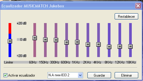

At the moment they are playing in some cardboard boxes and they actually sound very good with a must equalization to bring down the mid-upper mid and high frecuencies (equalizer pict uploaded)

and, Is there a way to make a proto board to play with differents notch filters or something to bring down thoose nasty upper peaks

Looks like you could use a Zobel filter, here's a nice calculator: http://www.mhsoft.nl/spk_calc.asp In my experience component values / quality aren't very critical with a zobel.
The parallel noth filter calculator on that website is also a nice starting point but you'll need to finetune by measurement or ear. Use the inductor value indicated by the calculator, then try various combinations of resistance & capacitance untill you've found the peak and the width of attenuation you think is best.
For best sound use only good quality components here, caps are most important (I like motor-run caps), low dcr chokes & good quality power resistor.
