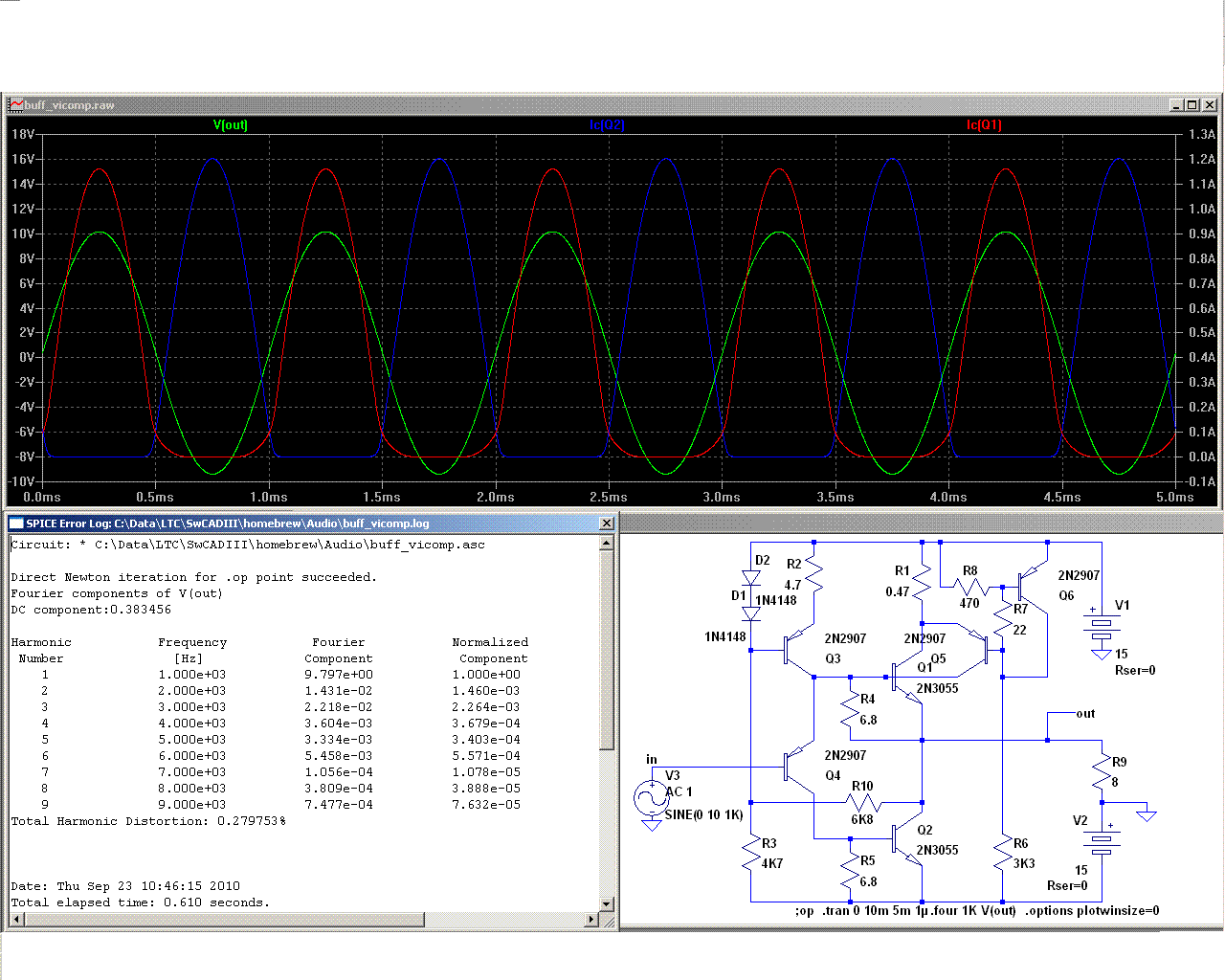

Here is a practical example:
http://www.diyaudio.com/forums/atta...logy-no-feedback-classab-buffer-unigabuff.gif
It is a bit unusual, because it is implemented as a unity gain buffer, but if you make Q4 NPN, it becomes the standard circuit.
The current source is Q3, and it has to compensate thermally the output transistors via D1 or D2, the other serving as a self compensation.
In addition, this circuit has a servo-controlled Iq via Q5 and Q6, but conventional emitter degeneration is also usable.

Thank you for your reply. I'm a little unclear on how this would work - for example, in the circuit you posted, let's say I remove the bias stabilization circuit consisting of Q5 and Q6 and put in place emitter resistors in each power transistor. In that case the current from the current source is going to zip down through Q3 and through R4, and through Q4 and R5. There's no way to "force" the current to go into the bases of the power transistor. In that case I don't see how one would set a quiescent bias point for the output transistors using such a current source.
Part of the current provided by Q3 will go into R4, and the rest will be diverted by Q4 to R5.
When the circuit is properly adjusted, the voltages across R4 and R5 will be equal and just sufficient to reach the Vbe of the output transistors.
The quiescent current will be set by the common current generator Q3, which is why it has to be thermally coupled to the output transistors.
Q4 manages the way the total current is shared between the output devices: if it conducts less, Q2 will be completely off, and the excess current will flow into the base of Q1 (the value Vbe/R4 is constant), making it conduct more.
It also works in the opposite direction.

from the good known push-pull buffer technology with NPN/PNP BjT's the typical value for the idle current must be between 15mA and 50mA for each power device - mostly 25-30mA.
Can I realize the same idle current values (and the same crossover distortion values at the same time) by this both circlotron topologies?

I think so.from the good known push-pull buffer technology with NPN/PNP BjT's the typical value for the idle current must be between 15mA and 50mA for each power device - mostly 25-30mA.
The classic circlotron (all NPN, including the phase splitter) works essentially in a common emitter configuration, very much like older topologies using transformers.
But for those topologies, the optimum quiecent current is in the same range as the more modern, complementary ones
To bring D1 and D2 in thermal contact with the heatsink of output power devices it would be from the mechanical point a good way to create this diodes from a TO126 BjT like BD139. Are there electrical disadvantage in this case?
Note that only one of the diodes has to be in thermal contact with the output devices: coupling both of them would lead to overcompensation.
And the other one is needed to compensate for CCS itself, Q3.
A TO126 seems nice for this function. And if it is a large area transistor, the current density will be small, causing a small overcompensation, which is probably desirable to overcome imperfect thermal coupling.
