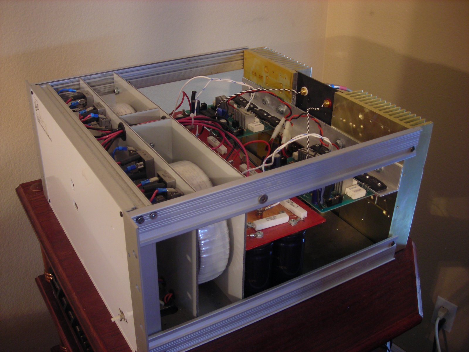

Blazer Boards
A friend gave me these. He did some biamping with ten, yes ten. He changed out the bias pots. So if they were factory set...I used them to power up my 7ft 3-way line arrays (PICS Included of my work). My brother is an electronics parts buyer and he gave me20 20,000uf 100v Panasonic caps. I also picked up two 600ve torids from ApexJR and added some additional filtering, used 16 total caps. The proof is in the power supply. It did a dam good job and soundede excellent with the LineArrays, they can dip down to 1.5ohms. Now the right side is a bit muffeled in the highs. Did all the swapping to eleminate the easy stuff, but no, it was the amp. I have two extra boards and will rebuild, upgrade before I replace the ones that are in there...MAYBE. If I can not figure out the biasing, I will change out the amp boards.
Hey, I can replace the boards with something else that has 70v rails (can not rember if the voltage is quite that high) from China, modified ofcourse. I put a lot into the amp with the front in Wenga and sides in Purple Wood. There is a board on e bay that will handle up to 100v rails.
Thanks for your help, hope you like the PICs, I need to sale some of these speakers!!!!
