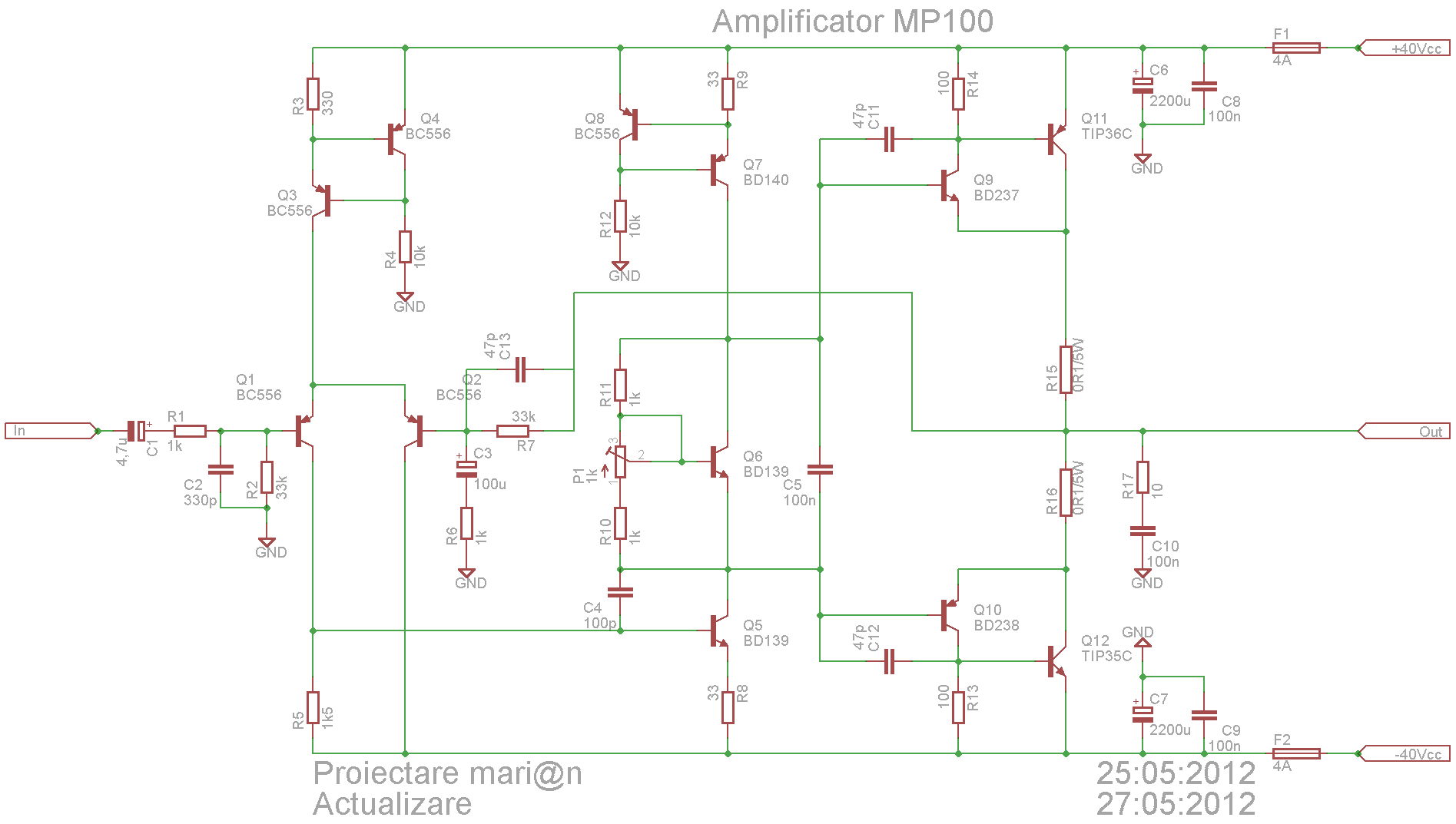

Mr Cordell measured fT of the 340/350 at 18MHz for the NPN, and 30MHz for the PNP (is no typo)
That is not what i asked, i already knew why BF's are prefered, what i asked is where do you get the Cob caracteristic for MJE340, since in the datasheet is not listed, but nevermind...

Hmm...100V across an 80V Vceo part?apex's 150w mosfet amp >> +- 50V >> bf871 its a 250v VCE... >> BD139 do the job.....
That is some very special under-rated part to survive power supply fluctuations too. I can tell you the original Philips BD139 did not survive long on 50V rails. Even selected parts would eventually fail.
I think we know that they would not be subjected to 100V, but rather les than the rail voltage ( in this case, less than 50V ), the output FET's do require some of that rail voltage to turn on, but spike's/accidents do happen that is why it is always recommended to choose devices that can cope to at least the rail to rail voltage.
As for the max possible power on 8 Ohm load with 50V rail and Fet output devices, well it can actually go higher than 100W, the fets will take less than 10V to turn on so the power can go up to 110W or even a bit more.
Bd139 could probably work as the voltage accross it would be below 100 v but once again its a poor choice. It has too high cob about 12-14 pf, low early voltage. In this case both high and low frequency distortion gets affected. If these better parts are hard to find its better to use a common transistor like mpsa92 and paralell 2 of them. Typical cob for 1 is 1.5-2 pf so 2 in paralell for a max of 4 is pretty good and gives performance similar and depending on the parts used could even better the performance of the purpose designed video transistors. I myself use bf721 parts in paralell many times. A small 1 or 2 ohm resistor on the emitters is enough for matching when there is a 10 percent match between two parts.

I would have a question for all of you who seek the so called hi-fi sound: The hy freq distorsions that you acused MJE340 of givin due to it's Cob ( wich it's taken from some spice model in stead of it's datasheet ), are you able to hear that distortions? and i mean with your own ears and not testing it on some fancy device? cus i think it's just a waste of time and resources to solve a problem that in fact does not exists, i doubt verry much that there are too many people that can make the difference between 0,02 and 0,002 THD, you cant because it is too low for the human ear to pick it up, so why do the big companyes waste time and money on this subject? It's simple, it is a very efficient way to justify huge pricesc for theyr amplifiers, no one cares that they will not be able to listen to those minuscul harmonics, no one cares that they more often cannot tell the difference, they have an hi-fi amplifier that const thousends of dollars, that is all that matters right? maybe not...

I'm more of a pragmatic one so my opinion might be biased, i always desighn my own amps ( or most of anythyng else i built for that matter ) and i base my desighns mostly on cost effectiveness but not sacrificing quality, i do not seek the perfect audio amplifier ( nor do i think it actually exists ), hi-fi is most of the time for people with big pockets and i am not one of them, this is one of my latest desighns:

I strongly recommend that you try one of the more modern designs using faster semiconductors. Examples: Mike's Symassym (updated version), Lazy Cat's SSA, TSSA or even Quasi's N-channel in which case, I'd say substitute the MJEs with Video Transistors and hear for yourself what everyone else is talking about here.
