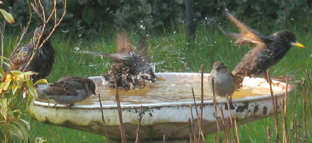

If your feathered family don't have a bird bath, one is easy to make using an upside down bin lid, a large plant pot saucer or photo printing tray, raised up from the ground on a wall or pile of bricks.
As long as the edge is not too flat or too sharp for their little feet.

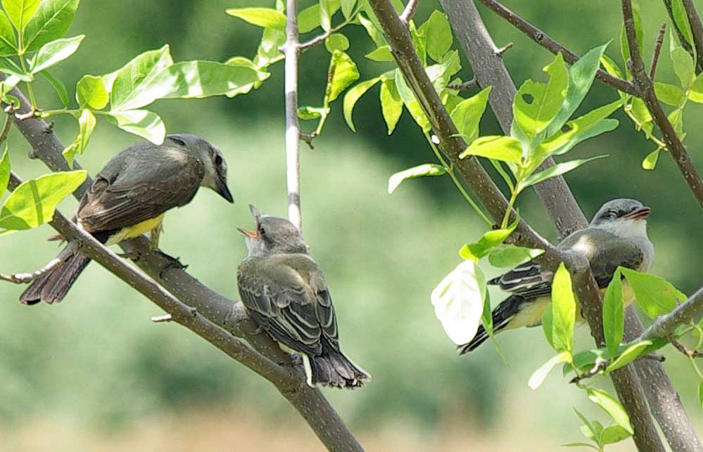

This is the first time since winter I've used the new Pentax K10D, so here's a 1:1 crop of a 10Mpixel full-frame shot. Sharpness could be better, since shooting through a double-pane plate-glass window isn't ideal, and the DA 50~200mm zoom is not at its sharpest at full aperture. I like the Pentax color, though - it's pretty close to what the birds really look like.
Yes, that's the mother on the left - as attentive as ever, even though the baby birds left the nest two days ago.

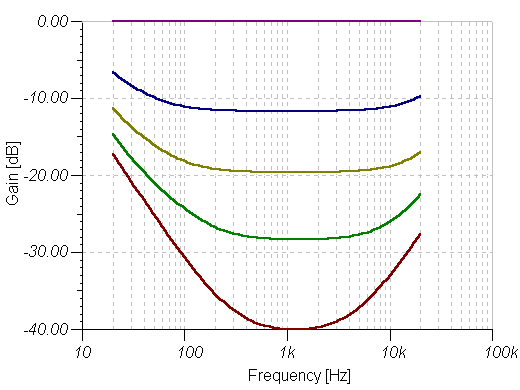

In my own LS tests I have become quite fed up of the 'sound' changing with level due to our human hearing characteristics.
I have come up with this little subcircuit, which is my first attempt, and thus the values need to be refined to better equalise the Fletcher-Munson curves.
Needs low impedance source and >10k amplifier.
Volume control circuit here.
Characteristics in my next post.
There are bound to be other versions out there but this one remains simple with 5k lin pots, and has a smooth onset of loudness compensation.
Cheers .......... Graham.

Hi Lynn,
I'm not positive, but your bird family looks to be Western Kingbirds. They belong to the flycatcher family, and are from the genus "tyrannus"; as in tyrant. The "tyrant flycatchers" get their name from their propensity to mob and harrass hawks and crows in flight.
Pete

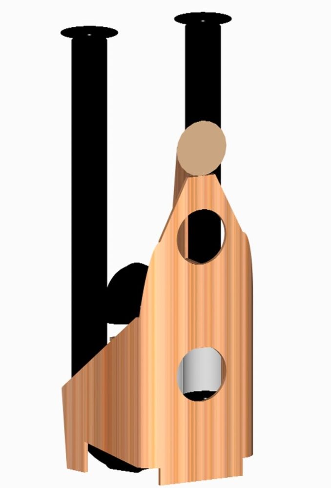

Here is a pic of what I am brewing up with people who can cut more inches of wood than fingers, repeatedly. This is the "Does it all fit?" solid model. Next I try and strangle some flat panel measurements from it, one's that someone else can read.
Then, sawdust.
