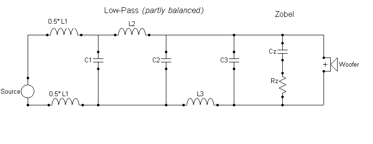

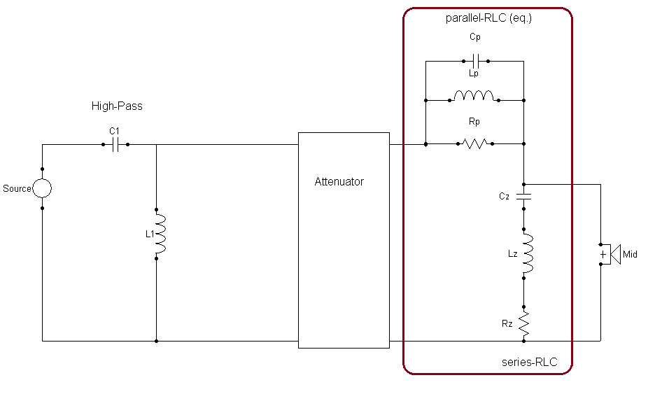

I have been trying to read more about the inspiration for your crossover, Marco, but Rey Audios biggest and baddest Rey Monitor uses a supplied active device. Go figure. Any chance you will share your crossover? I am very curious by now.
All Rey Audio systems have always used passive (high level) crossovers only, as you can see in their brochures here: CATALOG DOWNLOAD.
These crossovers are all based on the same topology that was first developed by Kinoshita while still working at Pioneer TAD, i.e.:
- balanced 6th order Low Pass on the Woofer, with Zobel impedance compensation;
- 2nd order High Pass on the Compression Driver, with L-Pad attenuator, parallel-RLC response shaping and series-RLC impedance compensation.
The layouts of these two sections of the crossover are illustrated below in the figures "Kinoshita LP" and "Kinoshita HP".
In my own system, I used the same kind of LP, but I forewent the two RLC networks and instead added a 2nd order LP on the Compression Driver too, complemented by a symmetrical 2nd order HP on the (super)Tweeter.
Of course, there is no point in showing the exact component values, since these are 100% dependent on the specific drive units used and on the chosen crossover frequencies.
