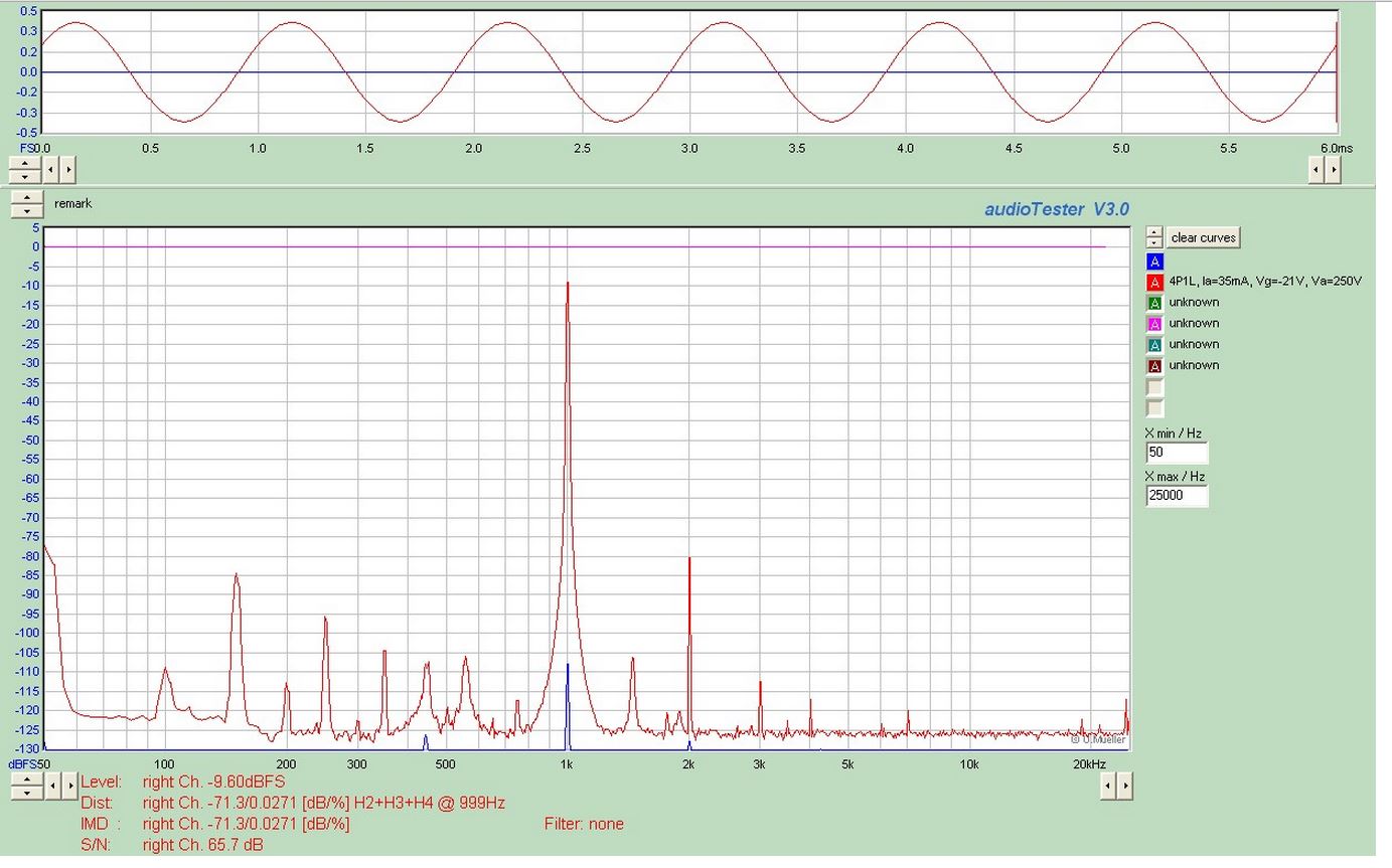

4p1l is the best tube I've heard in SE with filament bias; it sounds very clean and detailed. However it has quite a bit of harmonics beyond the third, I'm not sure if it would be as clean as a 45 in PP driver. I'm pretty much relegating myself to new production 45s when it comes to finding a matched quad.
According to at least one of Ale Moglia's measurements of the 4P1L, it can be quite clean beyond the 3rd harmonic. I 'm sure that you could find certain specimens of this type that could present an increased amount of higher order harmonics at specific operating points, but as indicated here this tube has some of the cleanest distortion spectra around. It's also worthwhile noting, that in this graph the second harmonic is down 70 db while the third is down by more than 103 db in triode SE mode with no feedback!
4?1?/4P1L THD sweet spot | Bartola Valves
From this it does not really need PP to cancel the 2nd order harmonics for this and better performing valves. I like the SE sound with the DHT, whether it is 300b 845 or whatever. But if I built up or modded another I might do the PP but not with 845's. Naturally, the 100dB plus 3rd order harmonics down mentioned in the posting is desirable. My 1987 revised PP SS amps are way below 100dB 2nd Harmonic. Well below any DAC output.

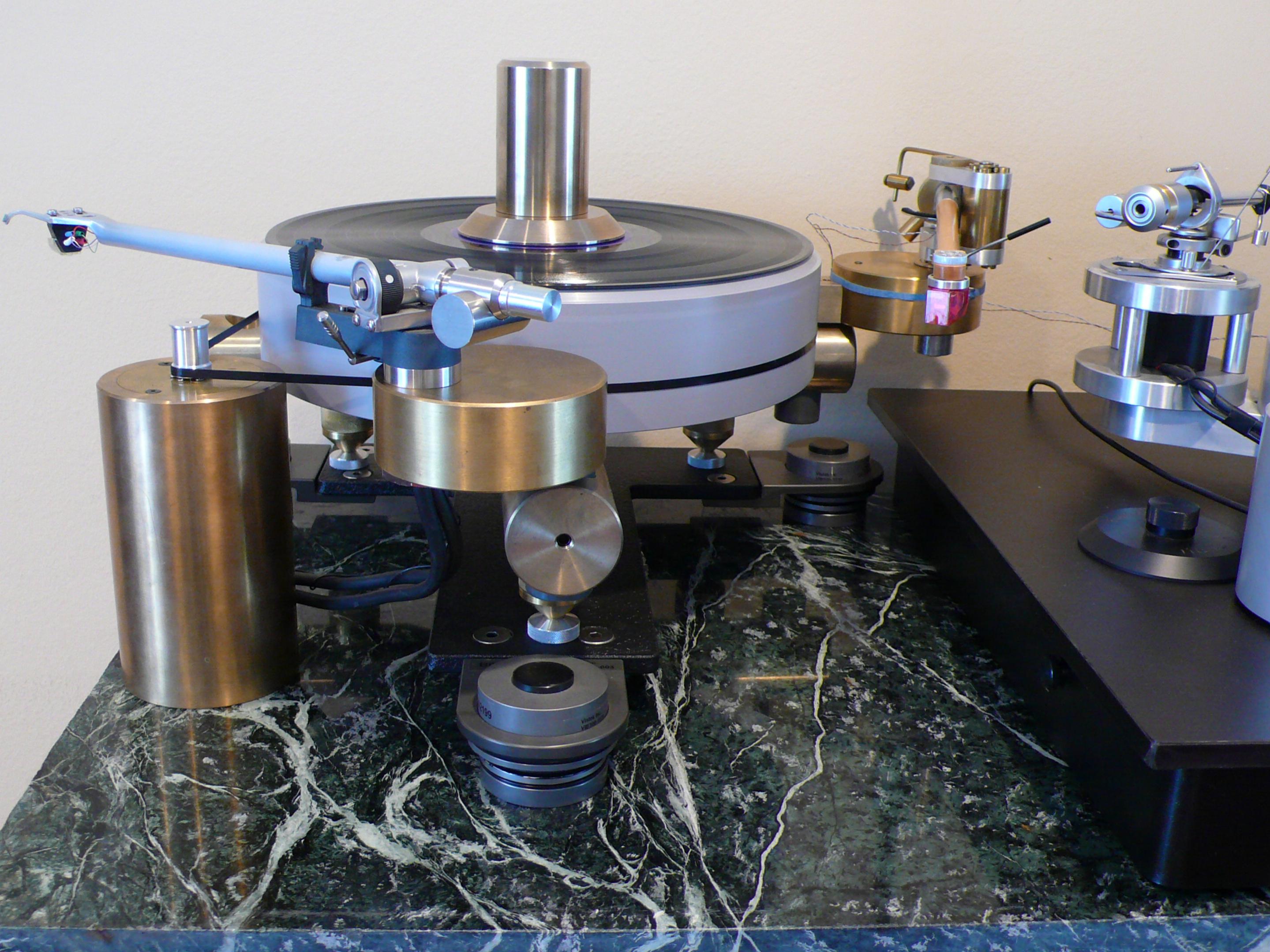

Regarding the turntable I should have specified that it was not your PVC platter although I bought it from your Aussie customer who upgraded to one of your high spec platters (stelvio or gavia) and the bearing I got from Chris Brady. I don't want to build any more DIY tables....ever:D
