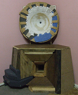

At work, noise comes in through a pair of 1973 Pioneer full range stacked in the corner above head height. After lunch I decided to turn it up a little and sat down for a cig, when S & G came on the box.
So I was conscious of what to expect but I was hearing it like I haven't for a while. Reminded me of a system I had in the 80's.. but I was hearing it that way too.
I'm looking to increase loading in that range while opening into the room. I haven't heard the slot loaded woofers yet.It was once suggested to me that if 300Hz was the center of all power, then it would follow that an octave below and above this would encompass the all important power range. What works best in my mind is to horn load this range.
The sonic signature and directiveness would then more closely match if a horn is also used above this, for the mid range/and/or the entire rest of the range. The enclosure for the 150-600hz range would be relatively small, and internal baffles could be incorporated to seriously reduce/eliminate standing waves. Now, how to match the bass and subwoofer range below this, would then become the subject of great debate.
