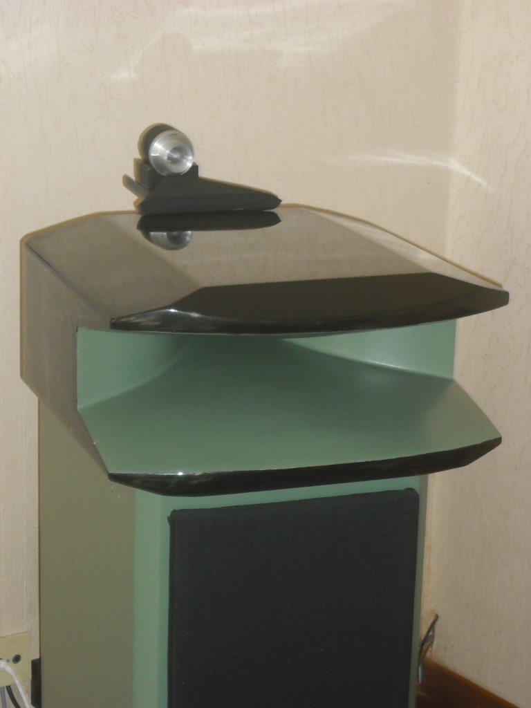

I used a 600 Hz Guigue Iwata horn for quite some years with a compression driver with low compression ratio (membrane surface / phase plug slot surface at the membrane side). Why low compression ratio: the volume of air between the membrane and phase plug V the phase plug open area creates a lowpass filter that is an important parameter for the high frequency extension next to the other parameters that have been mentioned such as membrane resonances, phase plug design and the short conical section inside the compression driver that controls the directivity for frequencies with wavelength/4 < length of conical section.
The advantage was that with a simple passive equalizing circuit no super tweeter was needed. The disadvantage was that all compression drivers I tested that were very good above 8 kHz, lacked 'body' and 'tone density' in the upper midrange (I am not an audio writer so this might be the wrong terminology) and therefore the optimum x-over frequency was > 1.8 kHz. An Altec 802 or 808 had the 'body' and 'tone density' and could be crossed over at a lower frequency but lacked the highest frequency extension.
In the end the in-room balance with a larger 300 Hz Guigue Iwata horn proved to more neutral (to my surprise), so I started experimenting with integrating the super tweeters. After many positions, different filters, level balancing, measurements, listening sessions (and Monte-Carlo simulations), I achieved very satisfactory results with a configuration as in the attached picture. There is a small patch of absorbing material in front of the super tweeter. The effectiveness is the same as covering the whole top surface of the mid-range horn with sound absorbing material (verified by comparative measurements and listening sessions). Integrating the super-tweeter was time consuming and not many good example were available when I started, but the end result is beyond what could be achieved by equalizing a compression driver.

Some to go to great lengths for time alignment:
http://blog.silvercore.de/wp-content/uploads/2011/11/IMG_25973.jpg
