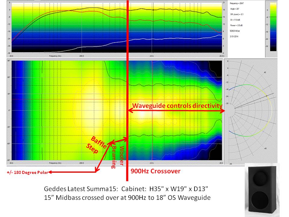

Speaker designers who can hear differences from: NdFeB compression drivers; Beryllium domes; autotransformers; underhung Alnico motors; are very likely to also find that all woofers do not sound the same, and end up with modest Mms, high BL, wide bandwidth designs.(Like Gary) Room equalized. No Servo.
Your 3cuft sealed box GPA 416-8B with have a total Qtc of about 0.7. A sealed woofer with a similar Qtc = 0.7 would provide a good transient match, and deep bass with enough equalization and power.
The large 4" radius edges will reduce diffraction. If you put your woofer under the midbass, give some consideration to vibration reduction or counter-force woofers.
Some very horny audiophiles really like control. They use horn tweeters, and horn midranges, and horn midbass, and build special rooms for horn woofers in order to maintain pattern control through most of the audio output.
Geddes/Olson designs only use a horn tweeter crossed to a boxed midbass. At the midbass baffle step frequency the polar response becomes 360 degrees. More energy into the room, less energy reaching the listener's ears. Balanced with midbass compensation boost. A boxed woofer would want the same polar and SPL. Avoid dipole or cardiod woofers with a 4.77x higher Directivity Index. Avoid horn woofers with an even high Directivity index.
