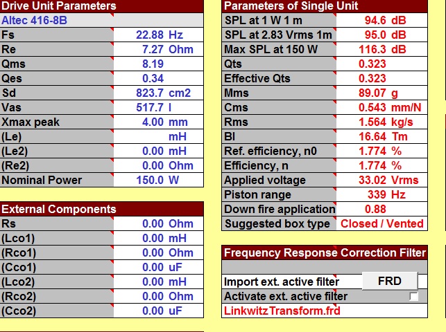

I was just playing in Unibox with the GPA 416-8B (8ohm) to see what kind of sealed box size it wanted. I was really surprised to see that the calculated sensitivity db/1w is 94.7, not the 98db/1w I was used to seeing. I went digging and it looks like the spec in GPA's datasheet is quoting it in 2pi above the baffle step, not the more traditional 4pi measurement.

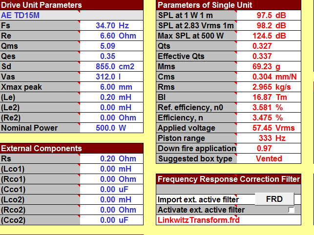

I put in AE TD15M's data in for comparison, which yields 97.5db/1w using the same method. Did you notice any difference in sensitivity between the two drivers?
Unless I botched the calc. I double check vis-a-vis GPA's quoted T/S parameters.

Quick comment on JoshK's data: 89 grams seems pretty heavy for an Altec-style cone, and close to the 98 grams of the modern JBL 2226. The numbers I remember seeing for old-school Altecs were in the 60 to 70-gram range, which is on the light side for a 15" cone.
The Qts of 0.343 also seems a little high for an Altec/GPA 416, while Gary's measurements fall in the below 0.3 range I'd expect for drivers that preceded adoption of T/S theory. In the Fifties, the common attitude was "more is better" when it came to magnetic force in the gap, which leads to lower Qts figures than we usually see today.

What is the Rs of 0.20 Ohm referring to (in the "External Components" box) of the AE Driver ?

That was an error on my part...carry over from playing around with the Onken style loading. Should have taken it out for a purer display, but still the comparison is close.

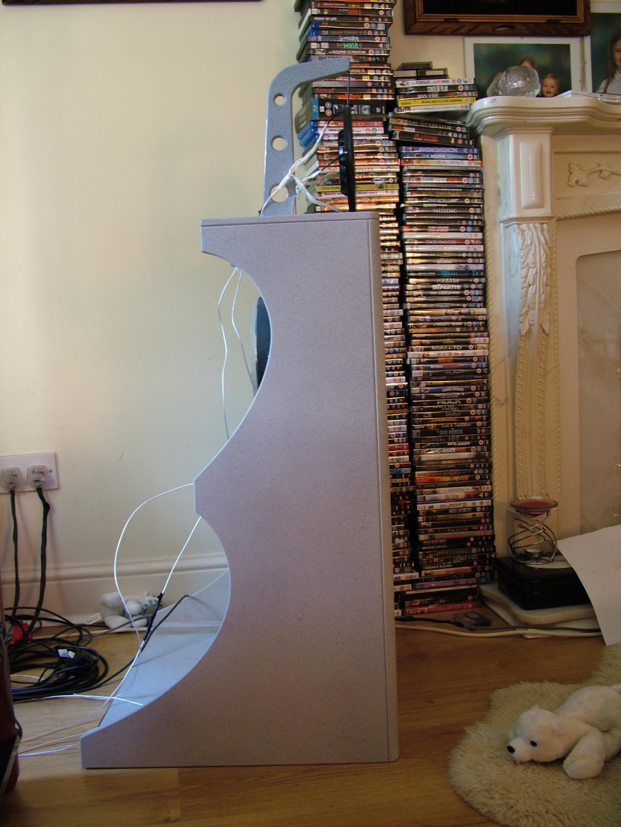

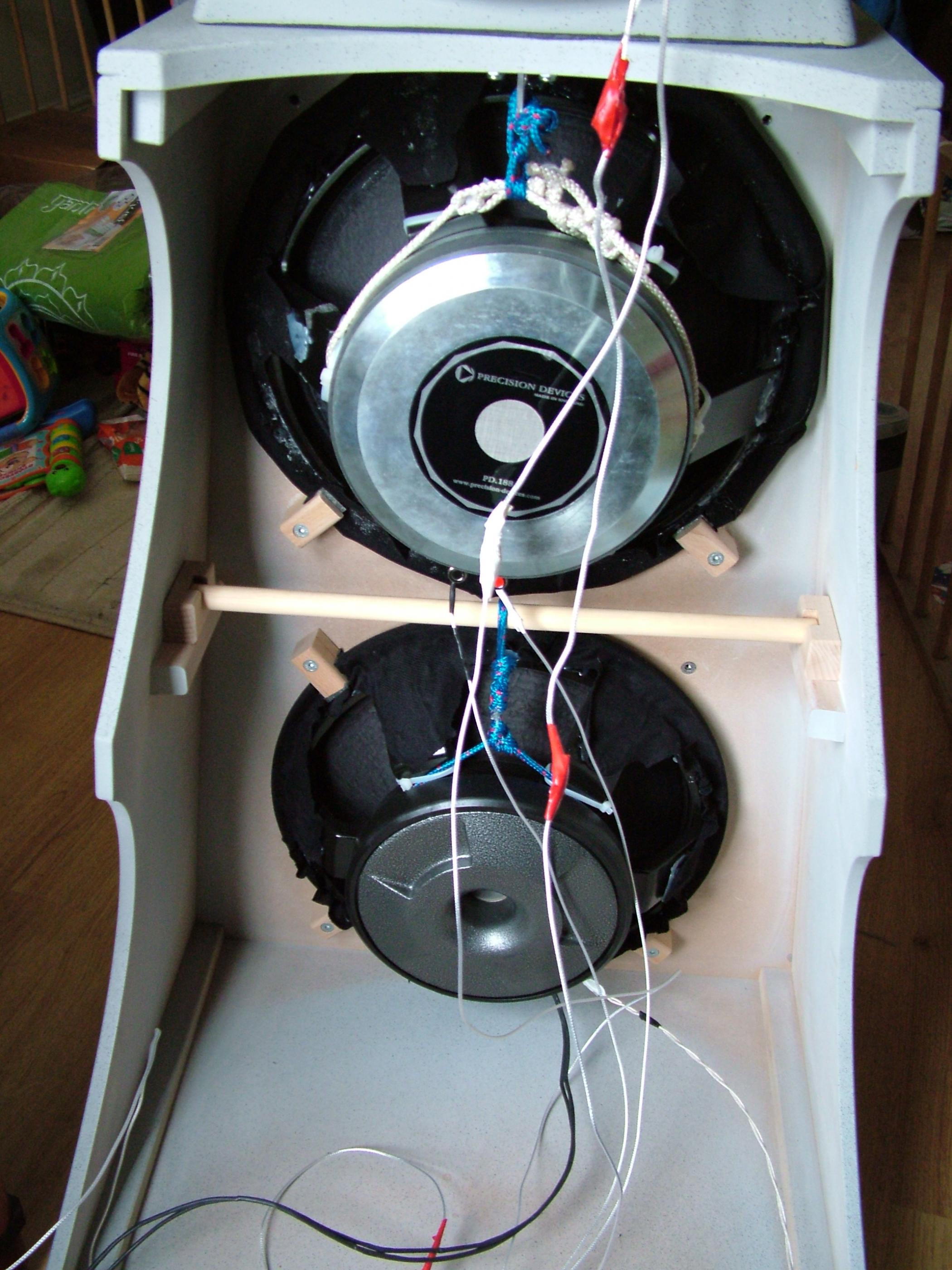

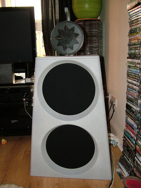

I have attached pics of a three way open baffle using another great option the PD 158 which I used in open baffle to cover 80Hz to 500Hz ( vary to taste!) with another 15 inch covering the sub bass...The Beyma SM115K which is a fab driver and great value, or the Precision Devices PD 1550 which is simply the best dedicated bass driver I have used.
I have not tried it as a two way but the attached VPL open baffle cabinet ( with suspended drivers) would be a perfect solution for those seeking to run a pair of 15 inch drivers in parallel and cross them over to a compression driver / horn sitting on top.
With one 15 inch driver on the bass and one on the mids I was getting beautiful results...Really addictive natural bass and low midrange totally free of cuppy and muddled resonance.
If I had a dedicated two channel room I would still be using the twin 15 inch open baffle cabinets but cross them over around 120Hz to an array of BMR's....Gonna build it one day just for a blast!

Hi Lynn,
Its been a few years since I replaced the open baffle system with the on wall BMR line arrays, had a quick look on my old PC and got some info that should help:
(1) Whilst most of my listening was done around 80dB average with 96dB peaks I enjoy high SPL blasts so the system had to capable of higher than average SPL's....Around 90dB average with 106dB peaks at the 4 meter listening position.
(2) Heavily modified and battery powered DEQX controlled the system.
When mounted on a flat slab of MDF 600mm wide 900mm tall the Beyma ran out of excursion at around 45Hz. The PD 158 never got near thermal or Xmax limits. (The PD 1550 bass driver could handle the Eq to get flat 35Hz and still remain within Xmax. )
(3) When I swapped the flat slab of MDF for the 500mm wide ( tapering to 350mm wide at the top) VPL baffle the Beyma could be Eq'd to a -3dB at 30Hz and still have Xmax to spare.
The PD 158 never exceeded plus / minus 1.5mm travel even at full power...Each 15 inch driver had 500 watts with "circuit breaker tripping" current available.
(4) In the VPL baffle the Beyma 115K had 5dB boost at 42Hz with a Q of 2.8.
A second Eq boost of 4dB at 70Hz with a Q of 3.5
Some times I replaced the two small peaks with on central boost of 6.5 dB with a Q of 2.1 at 55Hz, but I always ended up coming back to the two smaller peaks.
Crossover was linear phase 48dB or 60dB at 85Hz where the PD 158 took over. It had no boost at all, only a gentle cut centred around 190Hz. Usually -2.5 dB or -3dB with a Q of around 2.
This varied with room position, but was mainly an artefact of the deep VPL sides. If I made them shallower the cut was not required but I lost low end performance.... The small cut removed the tiniest hint of chestiness on male vocals and a slight richness in Cello.
After Eq' ing the sound was pristine....As I right these words I am smiling as I remember the sound... The combination of VPL baffle and DEQX allowed the huge Pro drivers to blend seamlessly with the Manger driver....That's pretty astonishing right there!
Hope this is of interest and helps you with your audio journey & remarkable project....This thread is a true reference for all DIY speaker builders with great knowledge shared by so many top guys, thanks to all of you!
