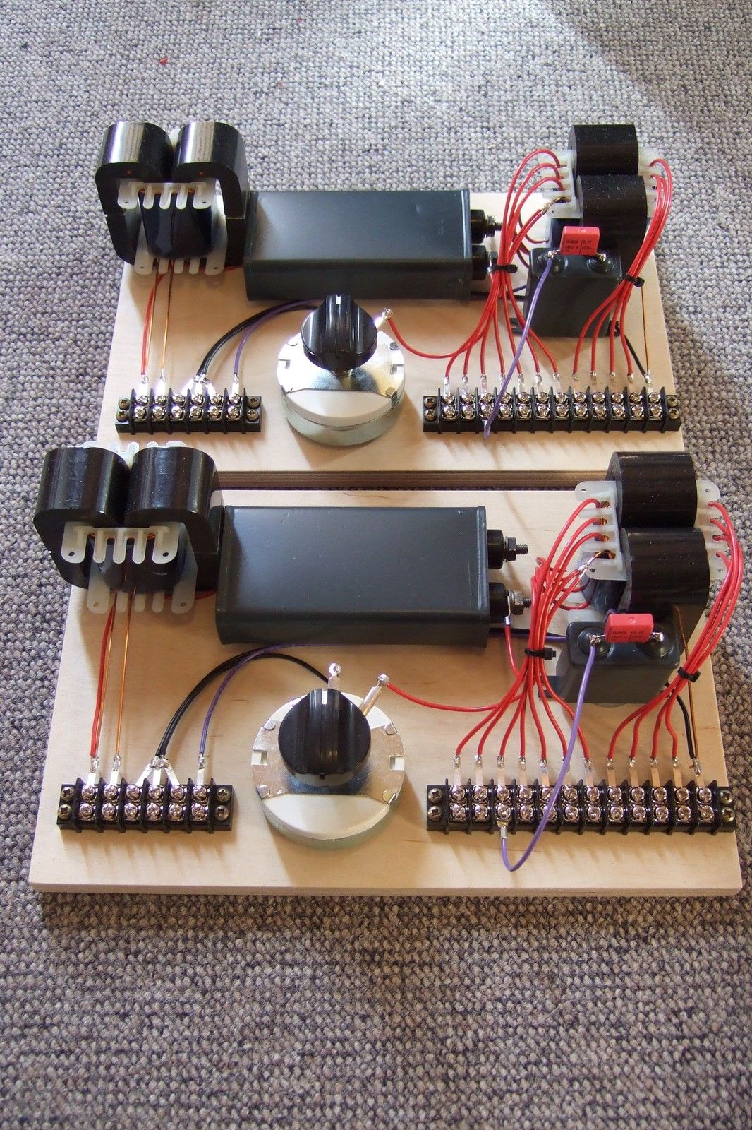

I wound the autoformer myself. I didn't want to remake the cross over and saw no benefit in having the autoformer on the speaker. With a 80% Nickel core you can have high impedance (so it is not effecting the LP) and low DCR. But mine probably has quite low power handling. Autoformers used between the cross over and speaker will need modelling, different for every tap. In my set up the cross over just sees the speaker. The autoformer is lumped into the amp output transformer. How that effects the amp is another question..

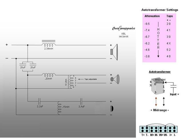

The speaker system is unchanged since post #10964, and is configured as follows:
1. RAAL Lazy ribbon, 2nd order high pass at ~8 kHz, 10-ohm tap of tweeter connected to -9.5 dB tap on Slagle autoformer.
2. Radian 745NEO/Be (16 ohm) driver, Azurahorn AH425, 3rd order high pass at ~700 Hz, connected to -17.5 dB tap on Slagle autoformer with 35-ohm swamping resistor.
3. GPA 416-8B Classic Series (alnico), 3 cu ft sealed enclosure, 3rd order low pass at ~700 Hz, Zobel circuit, -3 dB at 61 Hz, attenuation-band notch filter at about 1,500 Hz.
4. AE TD15H-4 plus two AE PR15-700 passive radiators (1 on each side of cabinet), separately powered by plate amp.

You mentioned a "35-ohm swamping resistor" for your 8 ohm Radian driver. Does this translate to a 10-ohm swamping resistor for 16-ohm drivers like the Klipsch K55-V? In the ALK Jr schematic below there is in a 10-ohm resistor.

These are the ones I have found so far. The schematic is ALK Jr. They look different but can both be used for La Scala, which is similar to my setup and maybe also the Ariel. Apparently with the ALK Jr you can adjust volume as well, but I don't understand where exactly. Maybe the different pins 1-4?
I don't understand the purpose of the knob, except I know it is not for volume. The knob adjust the slope somehow. That is all I know.

I added pics of the Altec A7 and JBL L300 crossovers, in the two crossovers furthest to the right. And I also added doodles that comes with the expensive German autotransformers. He uses two for every speaker. I wonder why is that.

To recap, the autotransformer and "swamping resistor" work together. The transformer multiplies the impedance of the compression driver by the square of the turns ratio, which is the same as the voltage-division ratio. Put another way, if the voltage division is 5:1, then the impedance multiplication is 25:1. The entire impedance curve of the compression driver (and horn) is multiplied by this ratio.
The swamping resistor is in parallel with the input of the transformer. What was a very high and variable impedance curve is now almost entirely dominated by the parallel resistor. This means the load for the highpass filter is now close to resistive, instead of the complex reactance of the compression driver + horn combination.
Similarly, from the perspective of the compression driver, the source impedance drops to a very low value, and the varying impedance of the highpass filter largely disappears. It doesn't have the near-infinite isolation of bi-amping, but isolation between the passive filter and the driver is improved.

In the ALK Jr, he seems to adjust volume with the 1-4 pins. So the autotrafo in this case is just like a 1st order slope, I guess. Then together with the 1st order 20+20uF (=40uf) caps he should have 2nd order. Right?
Edit: Lynn, I read your comment after posting. So the 20+20uF caps protect the autotrafo from bass. Interesting.

Lynn, Thanks for the clear explanation of the autoformer function. I guess in my case where I have a very small autoformer ahead of the cross over it is going to be easily saturated by the bass. It is not audibly distorted only because of the low levels - or maybe it is. I guess it would need to be something like the output transformer if it was to be rated for full power. Well I hate to rebuild the cross over but good to know what is going on.
Yup. Even something as simple as a single cap protects the autotransformer from bass. A lot.
Core saturation from LF energy, in my experience, is a high-order function. A single octave make a huge difference in power-handling. Think about it: if you're asking a valve amplifier to handle 20 Hz at full rated power and low distortion, the output transformers are seriously large, and very expensive. Relax the requirement to 40 Hz, the transformers get a lot smaller, and surprise, the HF gets better, too, thanks to less interwinding capacitance.
Cost goes down, too, since bigger cores require more complex winding schemes, with more labor. (The cost driver in a transformer is the labor to wind all of those layers and connect them together; fewer layers, simpler interleaving, and the cost goes down.)
Extend that to 500 Hz. No bass at all, from a transformer design perspective, and not only that, the power levels going into the compression driver are very small, from tens to hundreds of milliwatts (never as much as a watt in domestic applications). Thus, nickel cores are entirely practical, which improves low-level linearity (nickel cores are the preferred choice for microphone transformers). The autoformer is going to be about the size of a studio-quality 600-ohm line-driver transformer, not an output transformer.
No requirement for shielding, either. Just keep it a few inches away from the other air-cored inductors in the crossover.
