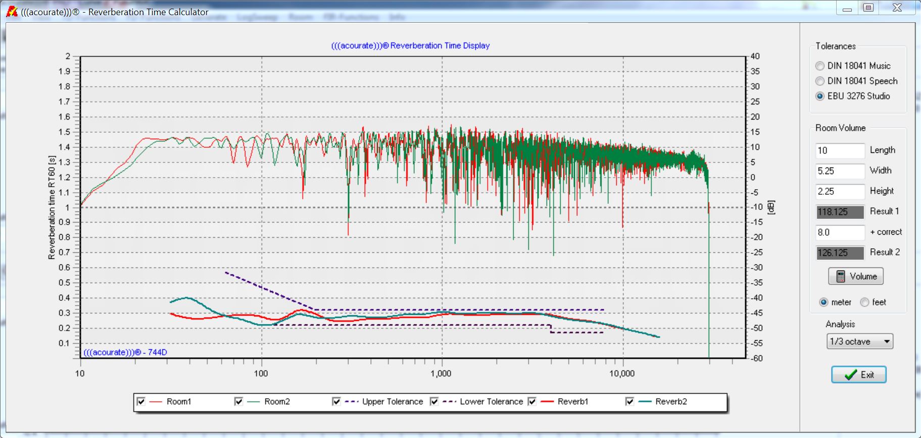

As an ex recording/mixing engineer, most of my time was spent in control rooms where the early reflections were suppressed and the later reflections were diffused. The primary reason was due to the Haas effect. One can hear over headphones what this sound like in this YouTube demonstration.
While the demonstration is to be listened over headphones and is on the mixing side of music production, it does demonstrate if early reflections are high in level (like specular reflections) and in the 0 to 10 millisecond range, how it can fool your ears from a localization perspective. In other words, strong early reflections mask the localization cues that are on the recording.
One of David Greisinger’s most excellent contributions is the objective measure of Interaural Coherence Coefficient (IACC). This is the measure of spaciousness of concert halls. The smaller the IACC value, the more spaciousness. An enterprising mathematician, Dr. Uli Brueggemann, uses IACC in the opposite direction, which is a measure of channel and room reflection equality for the first 80 milliseconds of sound travel. If interested, check out: Advanced Acourate Digital XO Time Alignment Driver Linearization Walkthrough.
See attached EBU 3276. While this is an old paper, I would say it is still valuable guidance for folks wishing to set up their listening environments for critical listening. There are basic guidelines for stereo setup, early reflections, target frequency response, reverb time, etc. Speaking of RT 60, attached is the simulated frequency response and reverberation time of my critical listening environment, as per EBU 3276 guidelines.
Hope that helps and Happy New Year!
