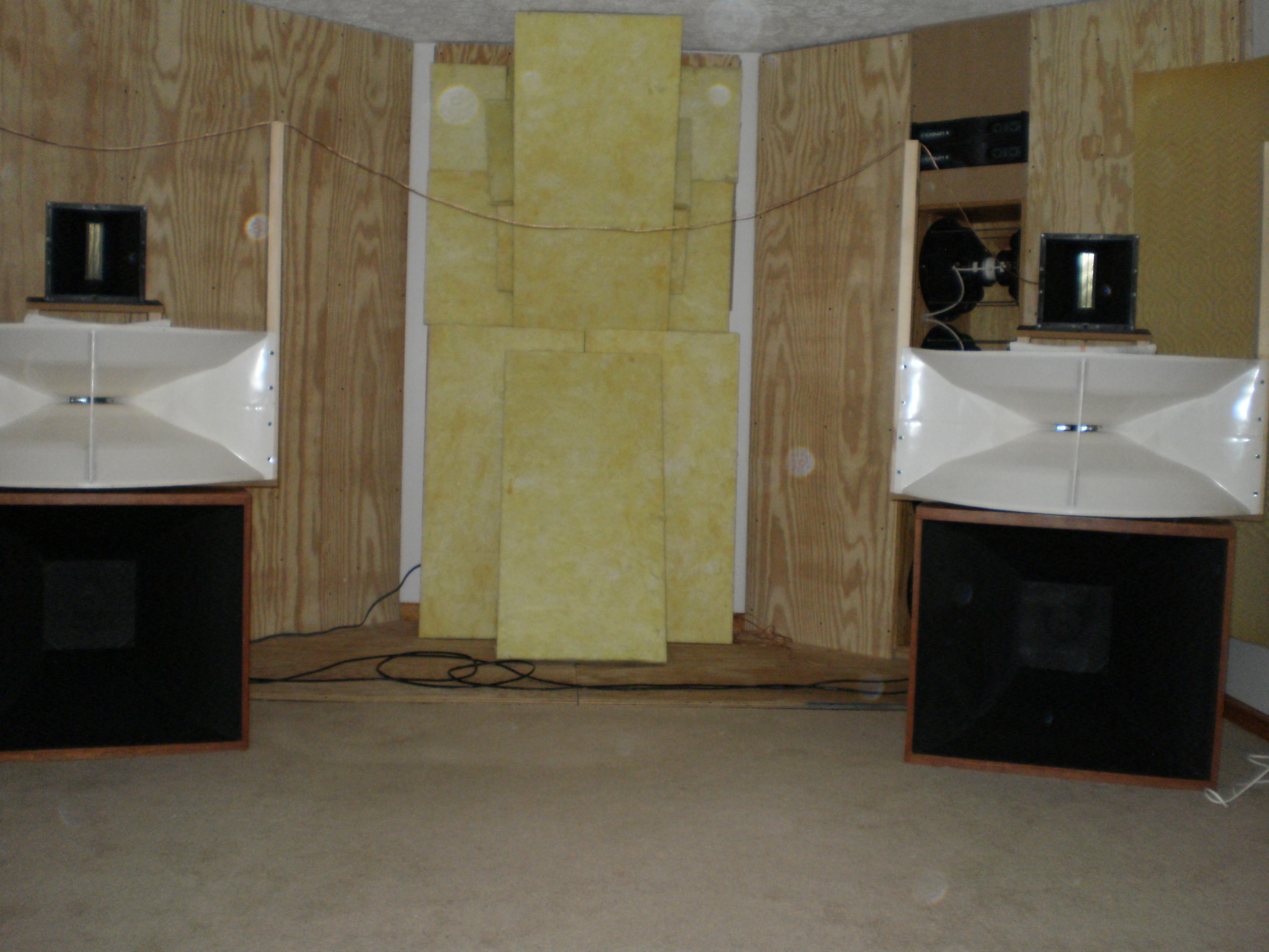

Please see the picture of my system that was "almost there". This was my incarnation about 18 months ago. The driver in the short (quasi) tractrix horn is the Altec 515-8G. It had wonderful articulate lower mid-range and could easily keep up with the white whales, but severly lacked in the "lower" mid-bass punch that my ppsl hybrids have (shown in a previous picture). Note the 8x15 IB sub-bass, and my findings are the same as what was posted by "bappe" in #10590. So, returning to the challenge faced by getting all the mid-bass right, I have to agree with you, Lynn, "band-splitting" to where I will add some "helper" woofer(s) to augment the area below 150 Hz is my plan as well.

nothing wrong with this bass solution , if going not-horn route , I suppose .......
Alexander is no longer using this bass module. The problem with the original version (as demoed at RMAF two years ago) was the missing woofer; it's not a closed box, but effectively a vented box, since one of the woofers is missing, and the opening left by the woofer was the de facto vent. Result, very high box tuning that interfered with the crossover to the cylindrical array of 2" aluminum-cone mid drivers. I don't know if he did a closed-box version of the bass module or not.
He's now going the OB route with reaction-cancelling pairs of woofers. The part I'm borrowing is the reaction cancellation, but not going down the OB route.

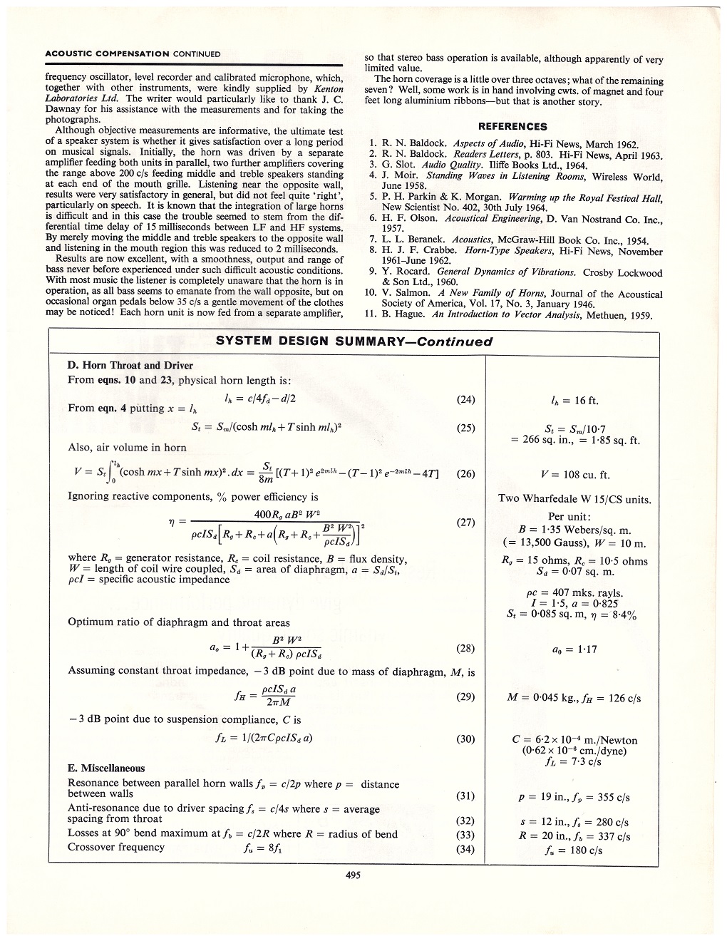

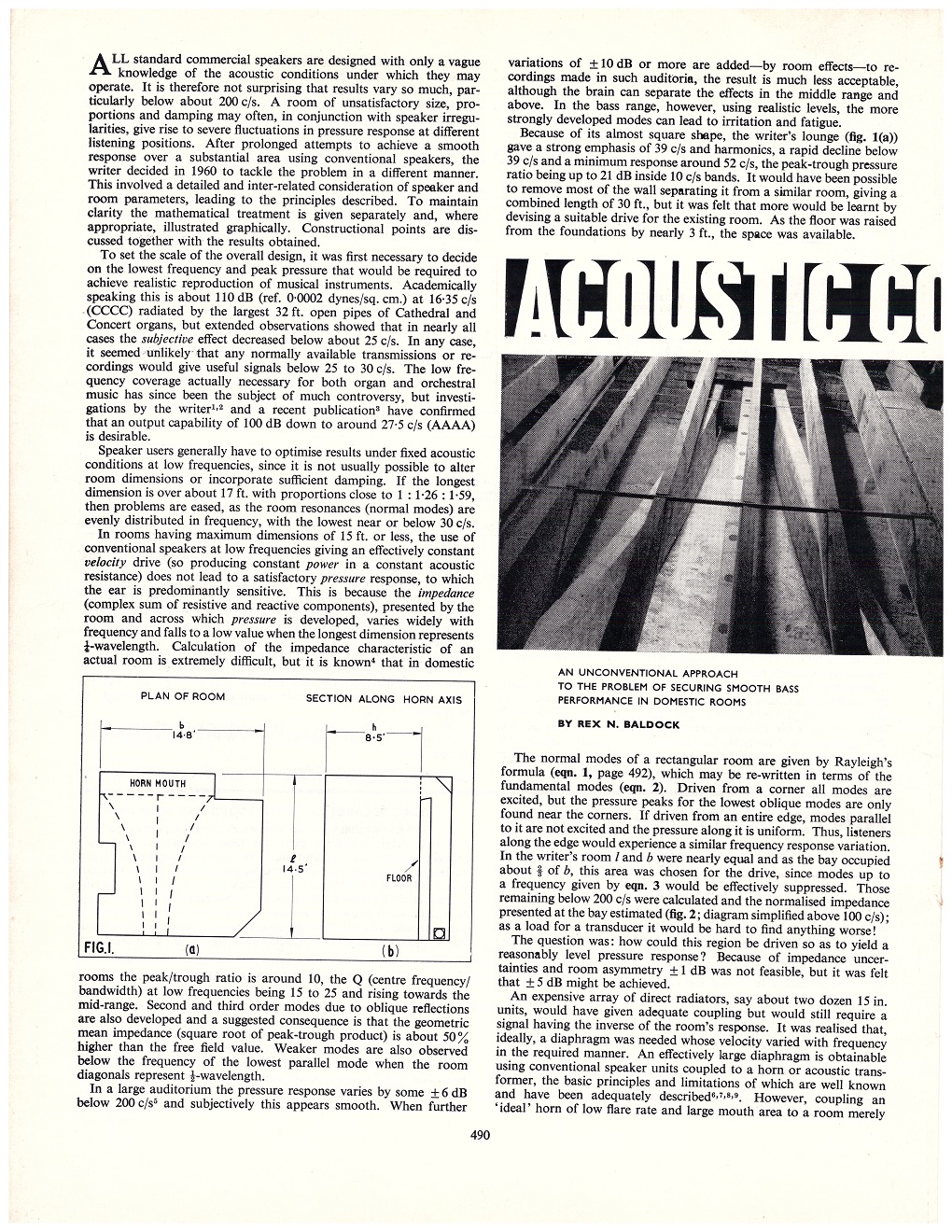

Here comes the promised scan.

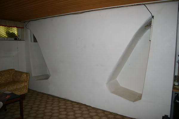

I have heard 3 and built one bass horns based on this article and these are the 4 best ones i have ever heard It would be a nice complement to the BTA for the one who can accommodate it.
One implementation can be seen below (borrowed from another forum) but the wildest one must be my friend Hans one in his basement, it is a little over 6 meters long and the mouth is 8m2!! I remember measuring the impedance on that one and it was very flat 20Ohms with some ripple below 14Hz. That system was so well integrated with room it was playing in. The mouth covered almost the complete back wall and gives the room a very pleasant visual and acoustic signature. The length of the horn fairly well matches the distance from the front wall that contains the wall supported, asymmetric Tractrix horns.
This is a little OT and does not really add anything useful to the completion of your project Lynn but i hope you don´t mind.
//Anders

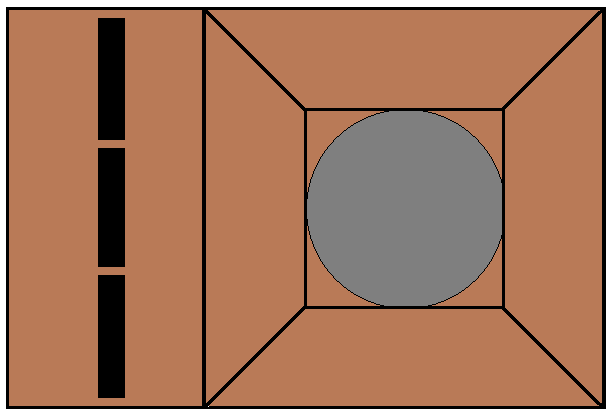

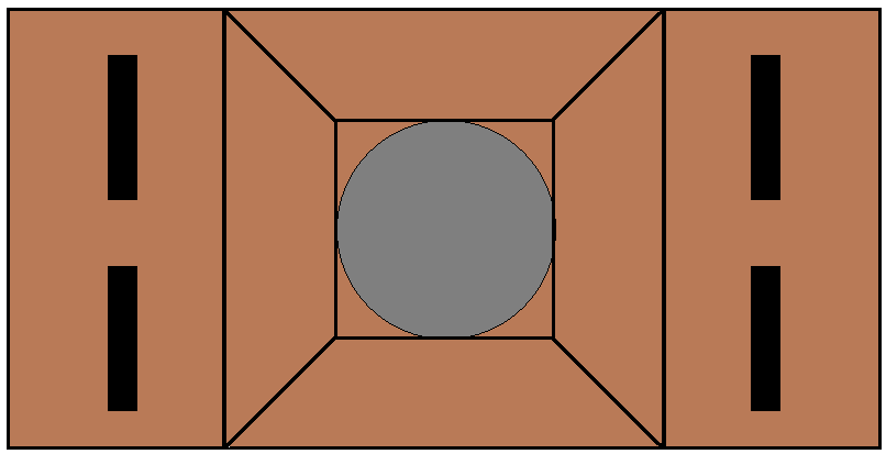

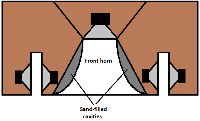

OK, so my idea for Unity-style subwoofer integration did not get a lot of traction, but here is an idea that I believe deserves some consideration.
If the Altec\GPA 515 is going to be front-horn loaded, as in Scott L's system, how about this: add two pairs of slot-loaded woofers either side of the horn-mouth, as part of the same cabinet. Think of the look of an Onken cabinet (see the first illustration). If we then add some straight baffles behind the curved horn baffles and sand-fill the cavity, we can easily mount the inner set of woofers (the ones nearest to the horn) closer to the horn (see the second illustration, a top-view cut-out, for more detail). My description may not be that clear so I made a few pics to illustrate. I also made a pic illustrating using subs on only the one side (see third illustration). Since the slot-loading method has inherent force-cancelling, the subs should not disturb the output of the mid-bass. The only problem I see with this idea is that the cabinet will become very big (read wide), especially with the slot-loaded woofers on either side, but other that that I cannot see a problem. I actually prefer the idea of woofer on both sides, but that's because I like things to look balanced.
Deon
PS. This is VERY IMPORTANT IMHO: If you look at the illustrations you will see that I added divisions between each pair of woofers' slot. This is very important IMHO. Take the situation that you make a slot with two pairs of woofers, and make a single long slot. If you use 12" woofers the total slot height will be about circa 28" tall. If you divide it into two separate slots, each slot will only be about 13" tall. Now, consider the 1/4-wave resonance frequency of a 28" tall slot: it will be circa 121Hz (if my maths are correct), which is at or below our desired crossover frequency. For the 13" tall slots it is only at circa 260Hz, which is well above our desired crossover frequency range. I would however further suggest that the upper and lower parts of the slot-mouth be lined with some carpet felt or Ultra Flex just as a further precaution. Once again, IMHO, and YMMV.
