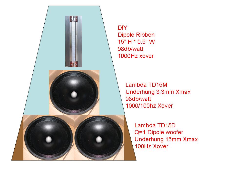

Looking at the spec.s of drivers - my OB midbass driver of choice (preferably 2X16 ohm drivers connected in parallel), is still the Jensen Neo 15-150. Its simply MUCH more efficient than other offerings EXACTLY WHERE ITS NEEDED, while having extraordinarily low mms for its sd (..for details and delicacy with the right amplifier - i.e. like the kind Lynn has). It also has its fs in the right place for such a design when considering its use in open baffle and its Qts. It does however need an appropriate low pass filter.
When I factor in cost and other attributes this is what I'd propose:
Esthetically similar to the Ascendo System M:
http://www.ascendo.de/english/frameSW.htm
Top down:
Top Module:
OB 175 mm's wide, 750-800 mms "tall" (height dependent on tweeter size).
4 PR170MO's in a vertical line.
..immediately below that:
A High eff. tweeter of choice (the Audax "line" gives you some options here because you can either cross at a lower freq. OR at a higher freq.). Though more costly, I'd choose the Aurum Cantus G1 at a lower freq. (close to 2 kHz). There are however MANY options available - including the recently mentioned Beyma Heil driver OR even the Hi Vi RT8-II that Gary Pimm uses (..as a low cost, yet low crossover capable driver).
Bottom Module:
OB 425 mm's wide, 850 mm's "tall".
2 16 ohm Jensen Neo 15-150's in parallel vertically mounted.
The surrounding "box" for this bottom module could be a cloth or perforated (yet dampened) metal panel(s) or a metal mesh.
Crossover design to suit the drivers (..Lynn's specialty, not mine. .)
Not a "small" loudspeaker.. and there is still the lower freq. to contend with. On the other hand it should be exceptionally "clear/transparent" with a very low compression character, while still being stunningly "dynamic".
Oh well, just my current thoughts - which are always subject to change..

salas said:Think about the 130Hz region. There lies average size chest resonance and there is where 'punch in the chest' is being experienced.
Yeah, thats a "hit and miss" thing.. one source says one thing, another says something else. I think the difference between the two is where the "listener" experiences it the most.. I.E. while the cavity resonance may well be 130 Hz for an average adult, this may not be the freq. for the greatest physical sensation.
Lambda Woofers...Acoustic Elegance
I used 50 Lambda woofers some years back because they just sound right. John Janowitz, the owner of Acoustic Elegance in GreenBay is said to be re-starting production of the Lambda line this summer. Following the philosophy of this thread with Lambdas, I would probably construct a 15"h * 0.5"w DIY dipole ribbon for 1K-20K, use the TD15M for the midrange down to 100Hz, and put a pair of the Qts=1 TD15D dipole woofers in a separate vibration isolated base baffle. I have found it necessary to go dipole from 20K Hz down to the room mode bass wavelength frequency (~ 30 Hz) to get the correct image. I have also found it necessary to put a diffuser on the wall behind the dipoles.
Here are the original TD15M specs:
T/S parameters:
Fs 30.5 Hz
Qms 4.47
Qes 0.29
Qts 0.27
Vas 405 Liters
Cms 0.4 mm/N
Mms 70 grams
Sd 855 cm2
Rms 3.0 Kg/S
Bl 27.6 T/m
Re 6.6 ohms
Z 8 ohms
Le 0.2 mH (low inductance due to underhung plus Faraday)
1WSpl 98.1 dB
Xmax (linear) 3mm
Xmax (mech) 10mm
T/S parameters:
Fs 30.5 Hz
Qms 4.47
Qes 0.29
Qts 0.27
Vas 405 Liters
Cms 0.4 mm/N
Mms 70 grams
Sd 855 cm2
Rms 3.0 Kg/S
Bl 27.6 T/m
Re 6.6 ohms
Z 8 ohms
1WSpl 98.1 dB
Xmax (linear) 3mm
Xmax (mech) 10mm
