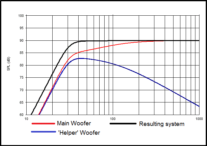

The extremely low Qts of the 515 Alnico results in a Lowther-like sloping response. In normal applications, this calls for horn loading to straighten out the response, but the secondary woofer lets Gary play around with crossover overlap to offset the falling in-room characteristic, while retaining the upper-bass virtues of the 515.

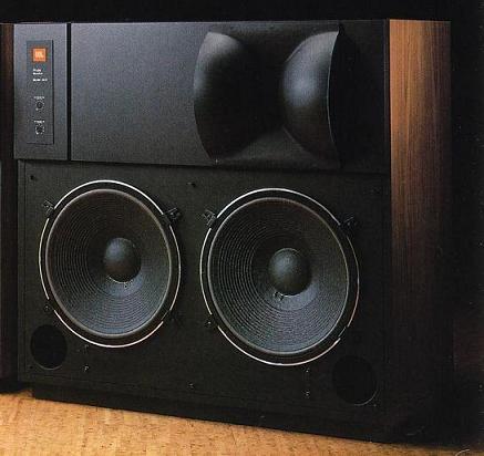

A similar design topology (2 1/2 ways with two low-Q woofers) has been used in a number of commercial speakers, like JBL's 4435 (simulation attached below) and DD66000/65000/67000 'Everest' (the latter also employ a supertweeter, but that's off topic here).

From memory such topology has been also used to give to the couple of bass loudspeakers a given radiation shape with a off axis of the radiation lobe.
Do you know if with the Everest DD66000 there is a left marked and a right marked enclosures?

Dear Jean-Michel,
as far as I know, both enclosures are identical, and the crossover can be configured by jumpers behind the faceplate so that either woofer can operate as the 'helper' (1st-order low-passed at 150Hz).
