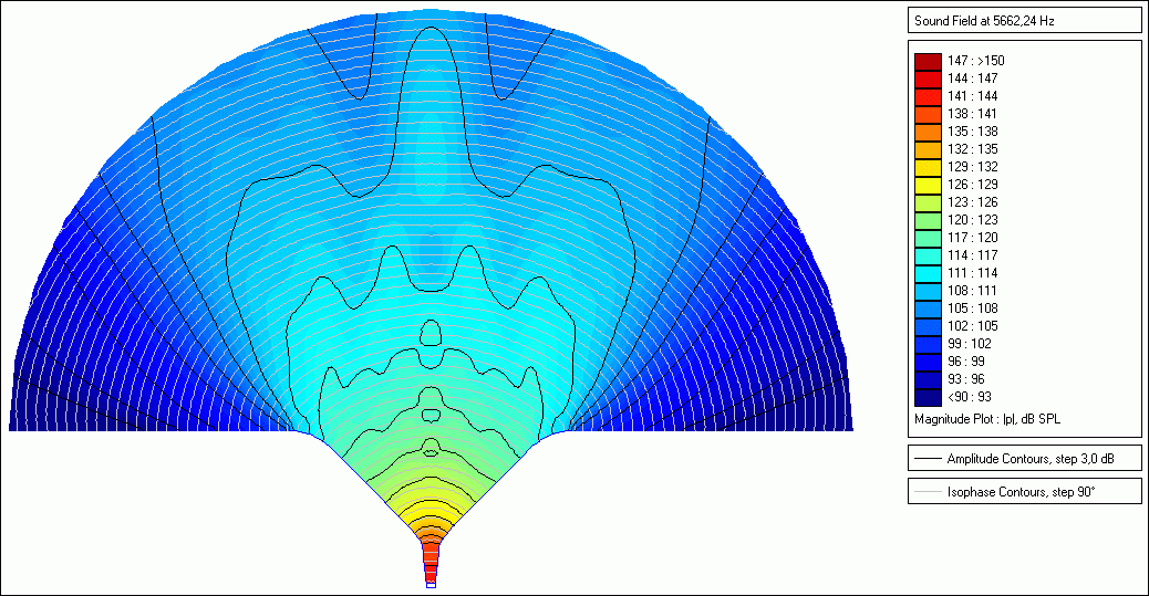

Lynn,Comparison of AH425 and CD waveguide at 1 kHz.
Since you did not answer the question I posed:
"What is the -6 dB beamwidth of the horn you are using in the "Beyond the Ariel" prototype at 500, 2000, 4000, 10,000 Hz?"
And then posted simulations, rather than measurements, am I correct in assuming you have not measured the actual polar response of the horn (or woofer) you are using in the "Beyond the Ariel" prototype?
Art
Robh3606,
I think what you are pointing out here about the polar response of the cd horn is something that most just don't seem to realize or disregard in whole. There are not any real constant directivity horn lenses that do not have lobs like you are seeing. What we see often are these smoothed polar plots that are hiding the real situation with nice pretty colors. I have never seen any horn or waveguide that does not have some beaming at higher frequencies and this causes lobing in the response curves when you really look for the details. Lower frequencies will also have a type of lobing that will be outside of the angular pattern that is described by the wall angle of the horn. I don't think this has anything to do with whether the horn is round or elliptical or even square. A round conic horn may have the smoothest polar responses but will also have some of this lobing at both extremes of the output.
ps. This is one of the reasons that I actually prefer the old single frequency polar graphs, you can see what is happening at individual frequencies and these details are not lost in the singular polar plots as we are seeing in these last few posts. Yes it is more difficult to see overall what is happening but the resolution of the details is not lost. There is nothing wrong with seeing an overall detailed map as just shown, but it does not tell the entire story.

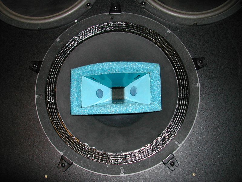

I know the UREI speakers well and they are just a modified Altec coaxial as far as I am concerned. At some point those horns had soft foam placed around that little horn to smooth out some of the diffraction from the sharp edges of the horn lens. The JBL speaker is a very different animal. it is not a coaxial design and you could do much more with that much larger Bi-radial horn, but at the same time you also now had a loss of the coherency of the single point source coaxial. I also must say that I do not believe those JBL polar plots in the least. I know they use smoothing and every other trick in the book to make their products look better than they truly are. Those polars of that bi-radial are more than suspect in my eyes.
Hello kindhornman
You mean like everyone else? You don't find that SIM odd especially when you compare it to the other horn?? Why so much SPL loss from the throat compared to the other horn??
Inside it as well.
Rob
