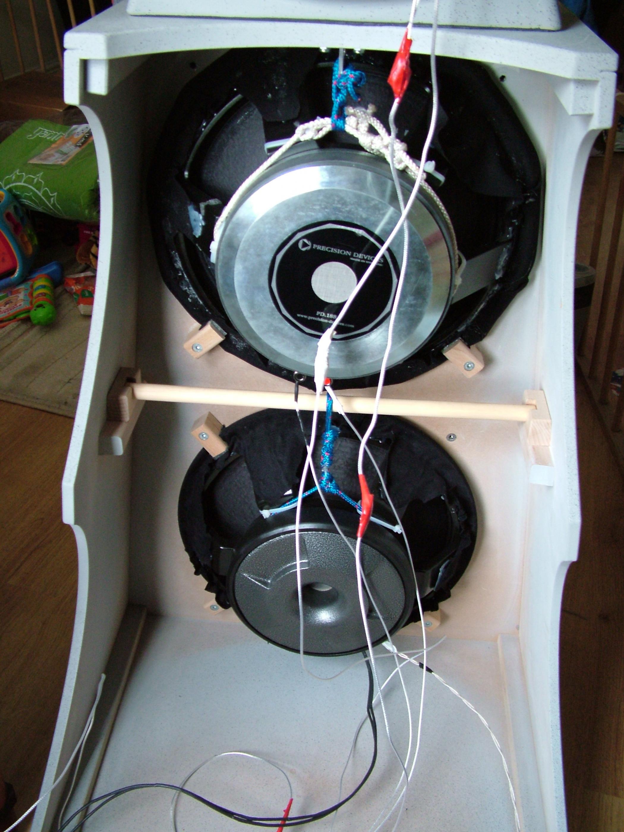

Possible 15 inch driver- dual or single.
Hi Lynn,
Hope all is well with you and you are back to good health.
I note your comments about dynamic mis match between cones and horns.
Well please have a look at this driver...
http://www.precision-devices.com/file-downloads/PD158DataSheet110912.pdf
The Precision Devices 15 inch PD 158.
I initially used it in a three way with a Beyma 15 inch bass driver below 100Hz and the Manger above 1,00Hz, it was and is sublime in that band, the kind of texture and delicacy I got from Volt 2500.4 10 inch or even my all time fav dedicated mid driver the PHL 8 inch M20 2520.
For a 15 inch Pro driver that can handle 500 Watts to a KWatt with Eq boost to make it flat to 35Hz, that is amazing to my ears.
Efficiency is very high, reliability is legendary and power handling almost unlimited...
Now my suggestion would be twin PD 158 's per side, crossed over around 600Hz to 900 Hz then your CD driver / horn combo on top ( with a thick sorbothane pad in between).
That would give you a two system with the cone section up around 103dB per watt...
Hope this helps.
All the best
Derek.
PS I also used my version of Mige0's "swinging speaker mounts" Really great idea and genuinely eliminated all cabinet resonance issues.
