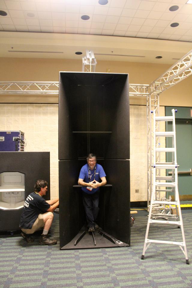

it seems to me that when you talk about horns you are considering something unmovable and possibly hidden. consider this one.
Wall of Sound Images
Or for extra headroom (much much more acoustic power than a large concert sound system), a pair of these large stadium speakers. A 40X15 degree CD horn. Radiating as if they were one source in time and space are 12, 18 inch horn loaded woofers, 32, 51/2 inch horn loaded mid drivers and 64 hf compression drivers.
You can literally walk into the horn (playing quietly of course)and you never hear any clue there is more than one driver, zero comb filtering.

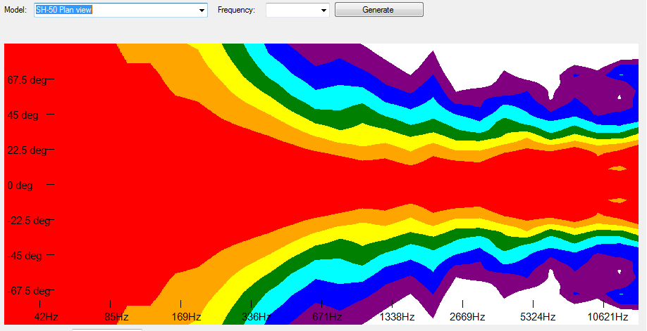

Seeing as all horns and waveguides follow the same rules no matter size, what of the diffraction effect from the edge of the very large enclosure you just showed. I am not talking about just the lowest frequency tied to mouth size but upper frequencies when they meet the edge of that enclosure? Do you have polar response plots on that monster of an enclosure?

Kindhornman, the Speaker shown in the picture is too large / heavy for the company that takes our spherical measurements to measure at the moment and so we haven’t gotten the EASE models or CLF files for that one yet. When Pat Brown saw it at the trade show, he said “wow, I can’t measure that one”. Your right, horns all follow the same rules size only affects the frequency where various things occur. The best I can do is direct you to a smaller cabinet like the J-3 which has fewer drivers, these are what did most of the full range part of the videos I had linked from LSU. The CLF data file is not normally used in hifi and is a 3D data set but one option in the viewer is to look at the 2D polar plot for H and V at different frequencies. You can get the data file and viewer here;
J3 | Danley Sound Labs | Danley Sound Labs, Inc.
I did ask our software guy to take the CLF data for an SH-50 and plot that as a map which is more common in hifi, attached is the map for that speaker, the span is 30Hz to 16Khz, the color graduations are 3dB per color.

So far as what is more powerful a horn or direct radiator, it depends.
Any driver will produce sound connected to any horn but if you’re talking about maximum acoustic power, once a horn is acoustically large enough and if one has drivers which are optimal for the job, a horn is very hard to impossible to beat.
A Tapped horn occupies sort of an in between area where the horn has less area than a regular horn, a TH812 for example is much more powerful than a vented box of the same cubic volume and frequency response..
Hi Pano, haha, to be honest, I have no idea what the price is, THAT is one cabinet I have not had in my living room and won’t have, it’s 10 feet tall.
