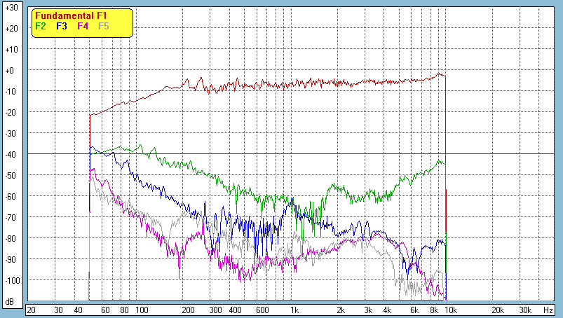

Because things get really ugly once we go above the first mode. If the driver is well-damped, with any luck, the output drops like a stone, and this is what we see in the better-behaved 12" and 15" paper-cone drivers. The 5.5" Vifa I used in the Ariel had the smoothest dropoff curve I've ever seen in any driver. Whoever engineered the polypropylene cone in that driver, they knew what they were doing.
But ... if the driver output does not drop above the first mode, it gets pretty nasty. The cone now radiates from several locations, with very complex phase relations between the regions. The size and shape of the regions can be dramatically different with small changes in frequency, and linear acceleration is no longer assured.
This region is where we see sudden spikes in distortion that are extremely narrow in frequency. Move the microphone a few inches to the left or right, and things are very different. It's fairly common for the on-axis response to be the worst in the group, with 5~10 degrees off-axis looking better. The group delay response disintegrates, with rapid shifts depending on frequency and angle of emission.
When I see this happening (looking at departure from minimum-phase and checking how much it changes with movement of the microphone), the driver is all gone. This is a non-usable frequency region, and can only be eliminated with very sharp filtering to push it below audibility. If digital filtering is employed, this is where the brickwall filter gets used. In the analog world, it probably takes an elliptical filter to remove the worst of the junk from audibility.
Cones or diaphragms with a reasonably amount of self-damping just make the design a lot easier and hassle-free. It's true that rigid diaphragms sound more "crisp", but some of that impression might be a little hint of the breakup region, not low distortion. They can sound alike, if you're not careful. Reviewers fall into this trap all the time.

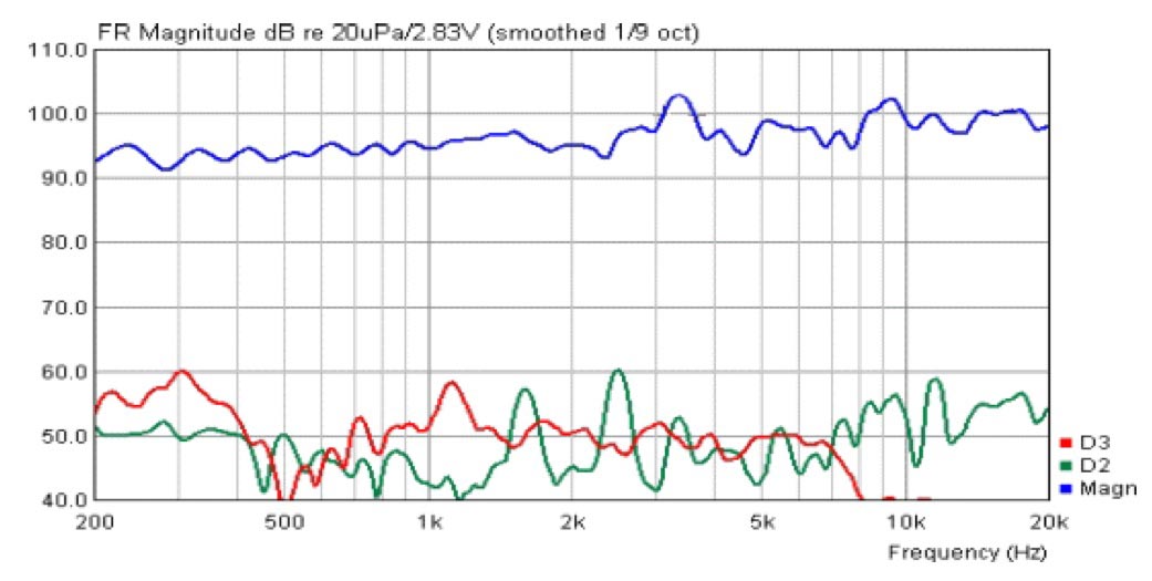

Thanks for the tip about the Enviee driver. Interesting. I don't care for the peak at 3.5 kHz, but that could be the whizzer cone, which always have rather awkward mechanical crossovers. If the driver was available without the whizzer that would make it even more interesting.
In a non-whizzer configuration, a pair would have an efficiency of 98.2 dB, not bad at all. Cone area would be similar to a single 12" driver.
