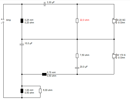

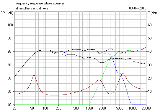

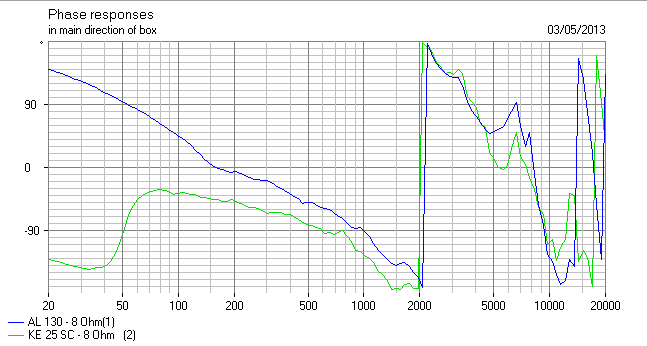

As it happens, Pano, I have come to think that seeking a flat frequency response at speaker crossover might be the biggest mistake people make in audio. :eek:
Quantum Theory says that ENERGY and TIME are related. But energy is not the same thing as frequency response when you try and integrate two drivers. Frequency response is momentum to me with my physics background, and that relates to position in quantum theory. We know that in a two way conventional speaker with flat frequency response, the overall energy takes a dip at crossover due to lobing above and below axis. I never get really good phase alignment with parallel Linkwitz-Riley filters unless I notch everything in sight. But the un-notched Butterworth series filter response with it's horrible +3dB peak (and actually FLAT POWER RESPONSE) works just great. :)
This time aligned series filter just seems to just WORK on a regular 6" bass plus 1" tweeter with no notches at all. BTW, time-aligned just means you set the tweeter back a couple of cms on the baffle, not hard. :cool:
