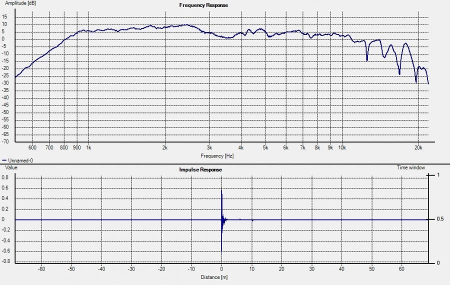

I have used the JBL 2470 and TAD 2001 down to 500. Many others 800 or 1200. Using a horn that loads it properly is recommended though - Here is the Dayton 250 polymide driver - reflections above 10k are bad - it sounds good 1.2K up even in a short horn like the SEOS waveguide. That's what it was in when I measured this
