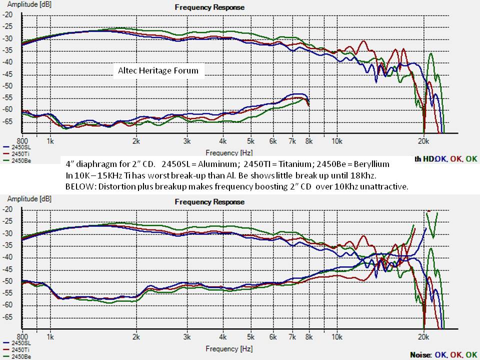

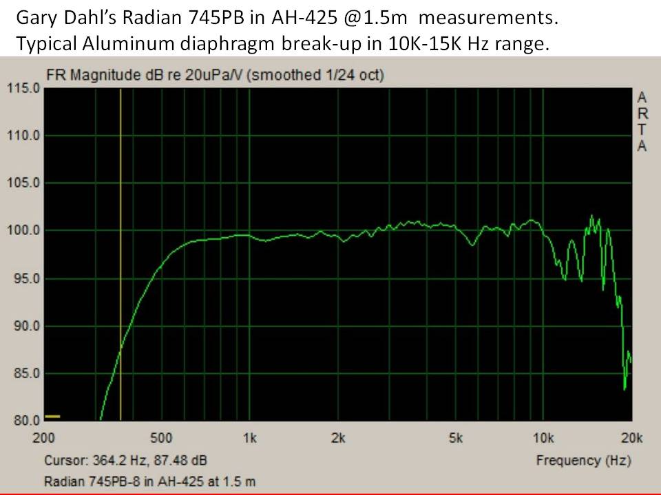

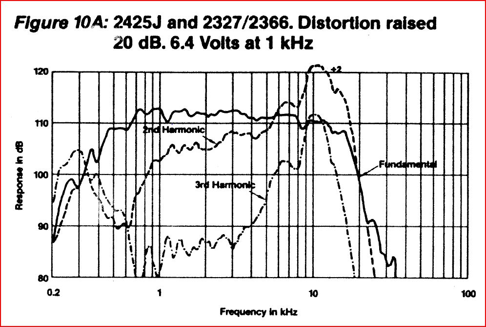

A couple of years ago we were discussing the beryllium 'frams over on the Altec forum (IIRC). I don't think I've ever heard one, but from all the measurements, they seemed only slightly better than aluminum. Didn't seem worth the costs and hassle to me. The jump from titanium to aluminum is a good one for SQ, but then onto beryllium there just isn't that much change in the measurements.
The Altec forum measurements(fig 1) match data from several other sources. Aluminum and Titanium diaphragms have break-up modes between 10KHz and 15KHz, but beryllium does not typically break-up until above 18Khz, and usually only above 20Khz. This SPL data shows the more extensive break-up of titanium over aluminum diaphragms.
The general viewpoint is that a beryllium diaphragm has little value with a 2" exit compression driver because the 4" mechanical diaphragm plus phase plug frequency limit is below 10Khz, especially when distortion is also considered. Aluminum diaphragms typically do not start break-up until above 10Khz.
The general viewpoint is that the expense of a Be diaphragm is probably only justified for a 1.4"-1.5" CD to remove Al/Ti 10K-15Khz break-up distortion(fig 2), or for a 1" CD to avoid break-up distortion until over 20Khz(example: TAD 2001). High frequency boost compensation can now extend a flat response to near 20KHz.(3)
