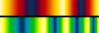

I did not take long last night fooling around with a dozen or more color gradients to discover pretty much the same things the IBM crew did. Luminance and saturation are key. And most color gradients don't show subtle variation well. The 2 below are the best I could come up with quickly, and you can see they aren't great. Better then JET , tho IMO.

Hello Panomaniac,
Your upper colormap is quite similar to the one used for the spectrogram in Adobe Audition (it also inspired from the Hot colormap...).
I doubt the usefulness of your second as our eyes (and our computer screens) are weak inside the green range.

I did not take long last night ... Luminance and saturation are key. And most color gradients don't show subtle variation well. The 2 below are the best I could come up with quickly, and you can see they aren't great.

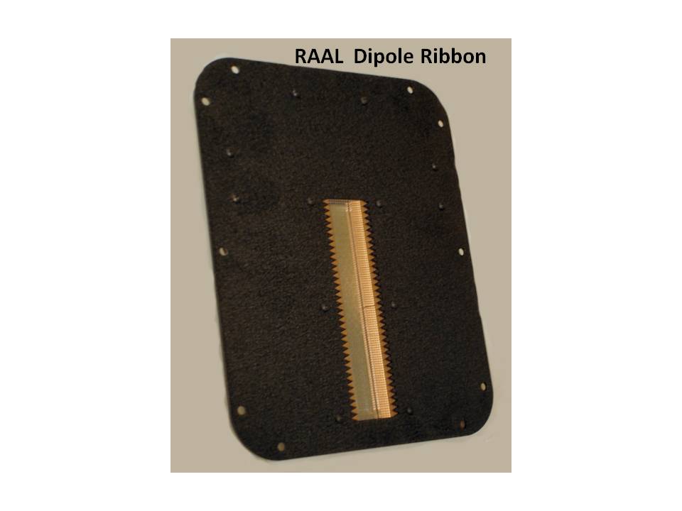

RAAL has also recently announced a dipole ribbon tweeter. I found this early documentation. Personally, I would minimize the baffle area by separating the ribbon's transformer off of the front mounting plate.
www.solen.ca/pdf/raal/DIPOLE140-15D.pdf
A DIY dipole ribbon tweeter is simple to construct from 0.5" x 0.5" NdFeB N50 magnets and some 0.5" square 1018 steel. I build 4" long x 0.7" wide dipole ribbons which can easily be crossed at 1,500Hz, and mount it on top of no-baffle Lambda TD15D or Tang Band W8-1808 mids. Material cost ~ $50. A no-baffle dipole ribbon tweeter has modest area required for good dispersion.

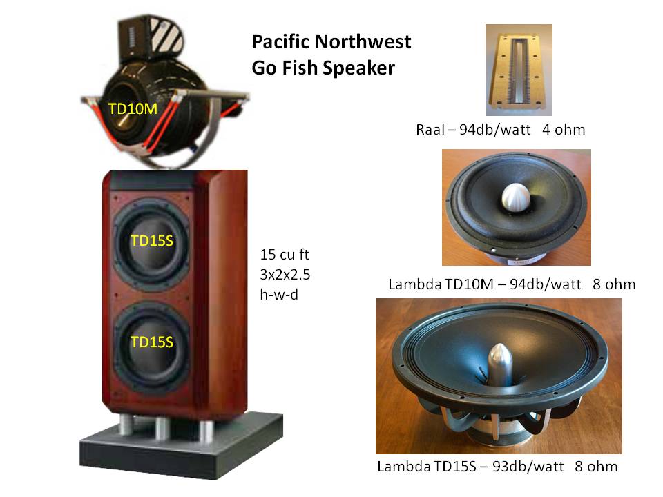

I wonder if a Fish Speaker would sell well in the Pacific North West.
