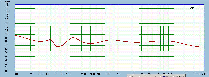

Here's the Radian with a Zobel: 8 ohms, 1 uF:

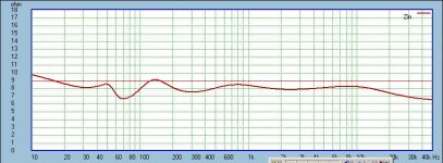

Can you or anyone identify a good amplifier that is not sensitive to frequency dependent impedance? Specific brand and model? Or does such product not exist?
Decoupling back EMF or any kind of stored energy from the amp is always a good idea. This is also why I mention requirements for flat impedance. The more gradual the slopes in the impedance generally is an indicator of less energy stored in the circuit. Attached is an impedance example of (if I recall correctly) a two way MTM small speaker in ported enclosure(s) crossed at around 10KHz. Attempt was make to smooth out the impedance adding as little components as possible, even the two peaks normally exsiting in ported enclosures were no exception. Listening was conducted on a HAFLER XL-280 amplifier.
Very interesting that you mention the sensitivity of swapping speaker cables. I've recently been doing some measurements with interconnects also with similar findings. I'm gradually going through my lot of interconnects to figure out correlation.
