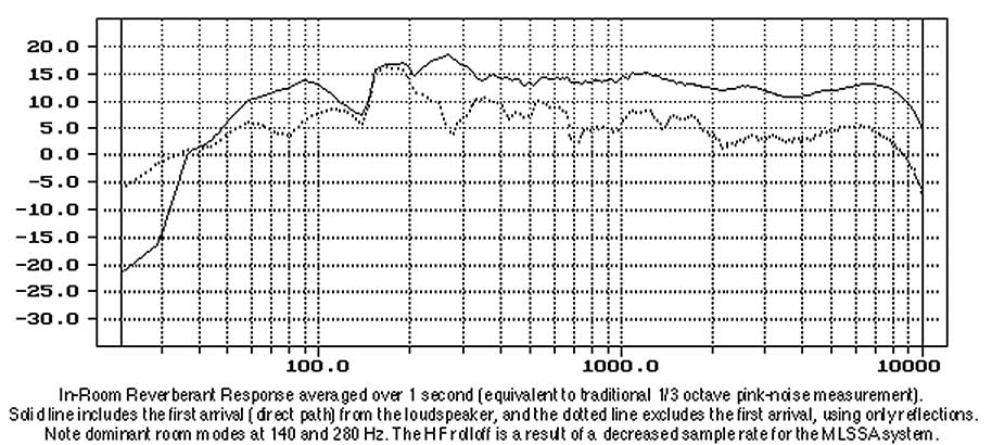

Good suggestion. Here's an example that compares the spectra of the direct arrival vs all of the indirect arrivals (room reflections). In other words, the lower curve has been windowed to exclude the first 2 milliseconds, but remain open for 1000 milliseconds afterwards.
I'd probably limit the window length to eliminate the room reflections as they really aren't the issue here. I.E maybe use a 5 msec long window for the full impulse and then a 2.5 long window when the first 2.5 msec is taken out.
