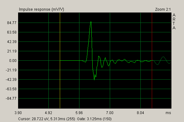

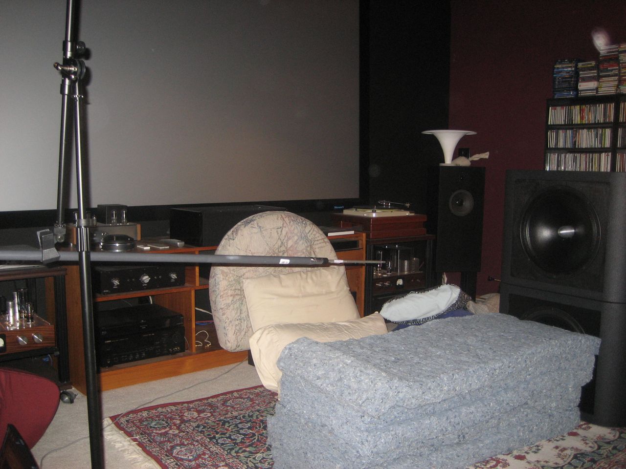

Following one Lynn's suggestions, I changed the mounting scheme for the test microphone. I mounted it on the end of a piece of plastic pipe (see photo), with the cable running through the center, so I wouldn't get an early reflection off the mic clamp. I also experimented with a whole bunch of Bonded Logic insulation batts (more than shown in the photo) and all the pillows in the house, in an effort to attenuate the floor bounce.
No matter what I tried, the impulse response showed a persistent wrinkle at 2.5 ms, which corresponds to a distance of just over 2.7 feet. Not sure where it's coming from. If I cut it off by setting the gate just before the wrinkle, all of those nasty ripples disappear from the frequency response graph. If I move the gate any later, the ripples are back. Ripples or not, the 1.5 kHz lift remains. I plan to use a crossover frequency of around 700 or 800 Hz, so it doesn't appear to be a terribly serious issue, but I do wonder why it's there.
I have attached a .zip archive containing both a .pir and a .wav file, in case you want to look at it on your own.

There is really not much else you can do. Which is why lots of people will either use anechoic chamber or do outdoor measurements. The way Lynn mounts the mic is the best I've seen, and it does reduce reflections effectively viewed in CSD and impulse. You will probably not see much change in the SPL.
The best distance setup is using the speaker center and mic center as ellipitc focal points to draw and elliptical sphere, keep all objects out of that sphere.

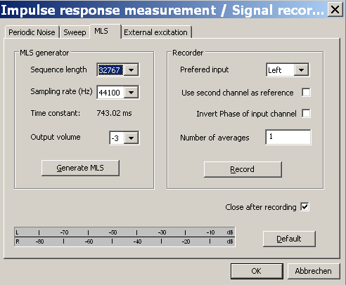

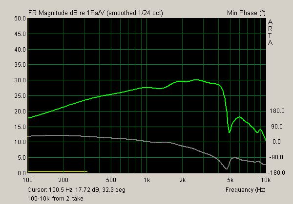

If I set the window before first reflections I get the on axis response below
Seems to be sort of "too good to be true" for a 15" (I could be wrong of course) :)
What were your settings for the IR measurement, actually and could you possibly try the settings I've shown for comparison?

If I set the window before first reflections I get the on axis response below...could you possibly try the settings I've shown for comparison?
Michael, with the same settings, I get the same on-axis response. But I don't think that snipping out that 2.5 ms wrinkle lets us see the whole picture, so I suspect it really is too good to be true.
John, it isn't the either of the sidewalls or the equipment rack on the left, which is too far away to be causing the 2.5 ms wrinkle. This morning I raised the speaker another 20" by adding the other TD15M cabinet to the stack. Now the center of the woofer is 50" off the floor, and there is a minimum of 50" of off-axis clearance in every direction. Microphone is at exactly one meter, and the 2.5 ms wrinkle is still there.

With my current setup providing 50" of clearance all the way around, would measuring outside on the ground still be an improvement? How would I set that up -- vertically or horizontally?

If your mic is at 39.4" and the closest reflecting surfaces are at 50" from the speaker, then the path length for a first reflection is about 107.5". So the path length difference is ~68.1" or 5ms after the direct sound, so that's probably not what you're seeing...
I'd say it's definitely worth going outside if you really want to see what's going on. You could take your same setup with the insulation on the ground and remove the effects of the wall and ceiling reflections in your room. Or you could put your mic on the ground, tip the cabinets forward a bit to point at the mic and lose the insulation to do a ground plane measurement. If the 2.5ms bump is still there in these cases (assuming any walls are further away), then you're seeing something from the enclosure or possibly mic stand although I find the mic stand less likely.

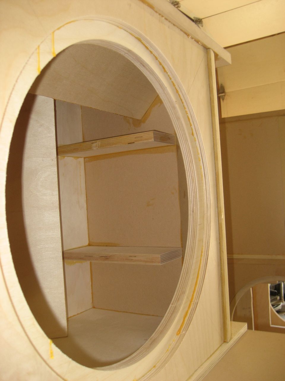

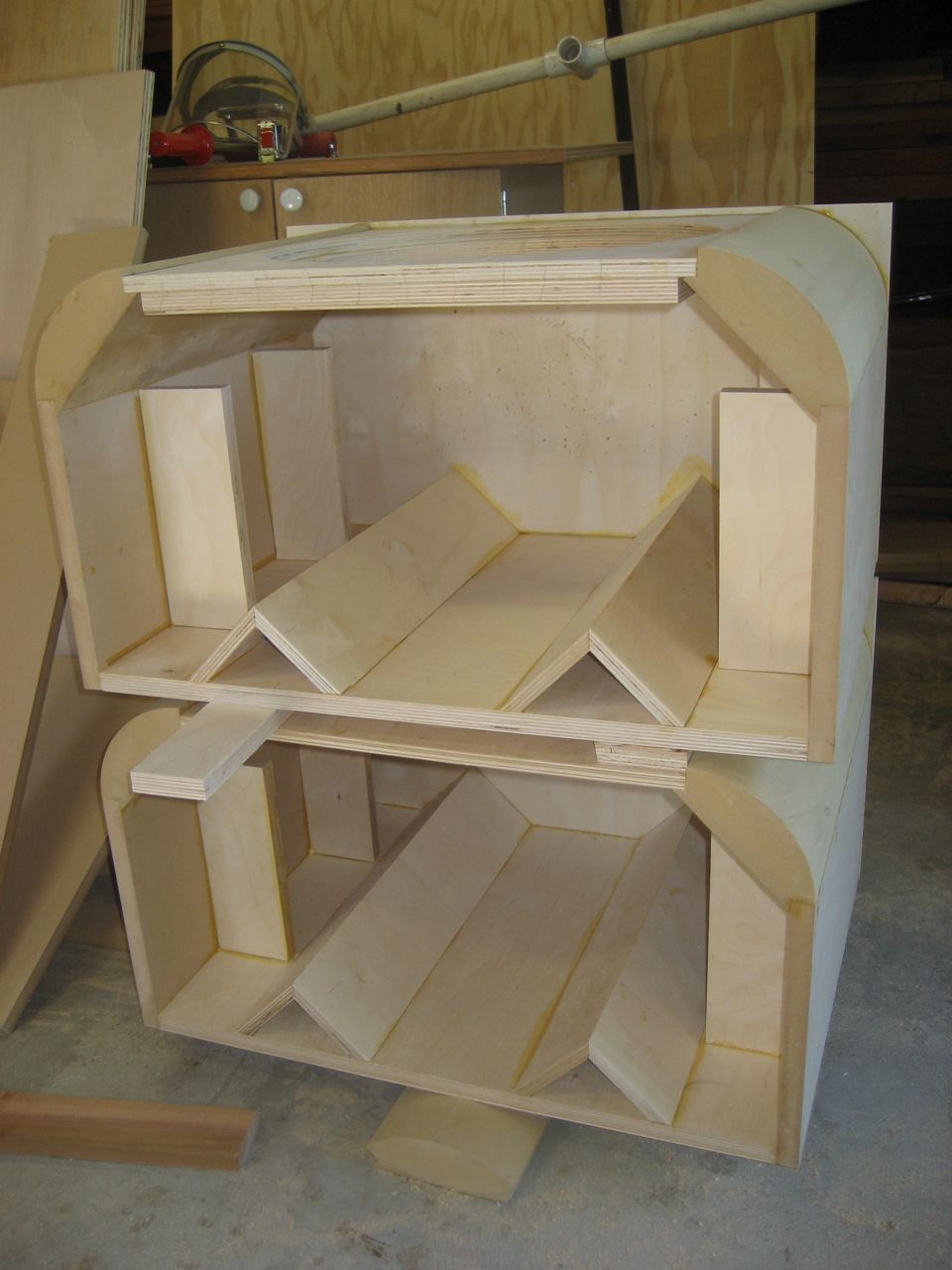

John, I think it may indeed be coming from the enclosure, although the actual cause is not readily apparent. There are two V-shaped diffusors on the back wall of the cabinet, one across the top, and a couple of small shelf braces on the sidewalls. I'll post a picture of the completed enclosure without the driver (gotta go to the other computer for that). The cabinet is filled with Bonded Logic, which is very highly absorptive.

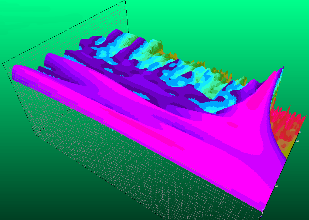

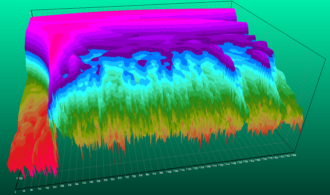

I listened to Gary's TD15M impulse response at very low spead (1/40 speed) and I think one can clearly identify a dampened back wall reflection. Following up there is a small amplitude but only slowly decaying train of brighter echoes until the first wall/floor reflections appear and the echo contours slowly disintegrate more and more into reverb.
In a perspective S-transform view the start of the IR looks like this, initial pulse ridge to left, the ridges of the first discrete reflections to the right (decreasing frequency along depth axis, X axis is 1ms/div, Y is 5dB/div), and the above mentioned low level echoes might be identified in the pretty repetitve pattern in between.
Klaus

I built a set of grill frames and installed one on the TD15M cabinet. Everything's all flush now. No noticeable difference in measurements.
Next, I removed the damping from the back wall and ceiling of the cabinet. These are the .pir and .wav files named "lessdamping."
Afterward, I replaced the previously-removed damping, and added a second layer between the driver and the back of the cabinet. This resulted in the box being completely filled, except of course for the area inside the driver basket. These are the .pir and .wav files named "fulldamping."
Finally, I completely removed all of the damping material from the cabinet. These are the .pir and .wav files named "zerodamping."
That blip at 2.15 ms still looks the same to me. :headbash:
