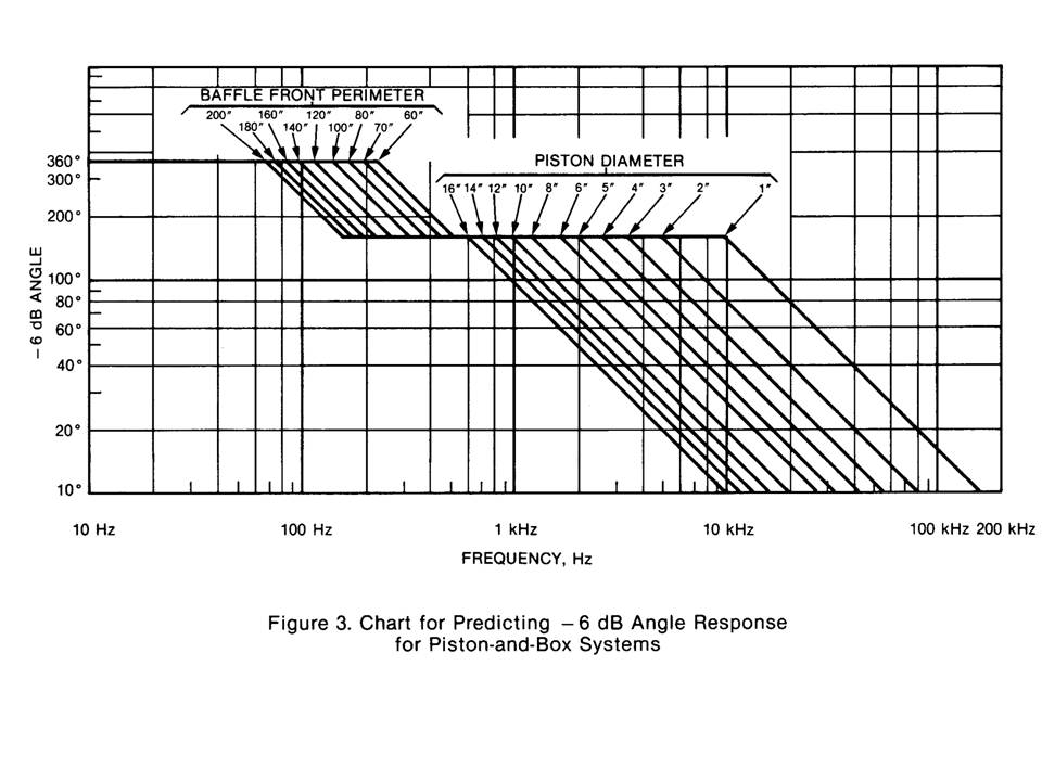

p.s. the only thing I don't like about them is the dispersion pattern which is (I think) largely dictated by the horn implemented.

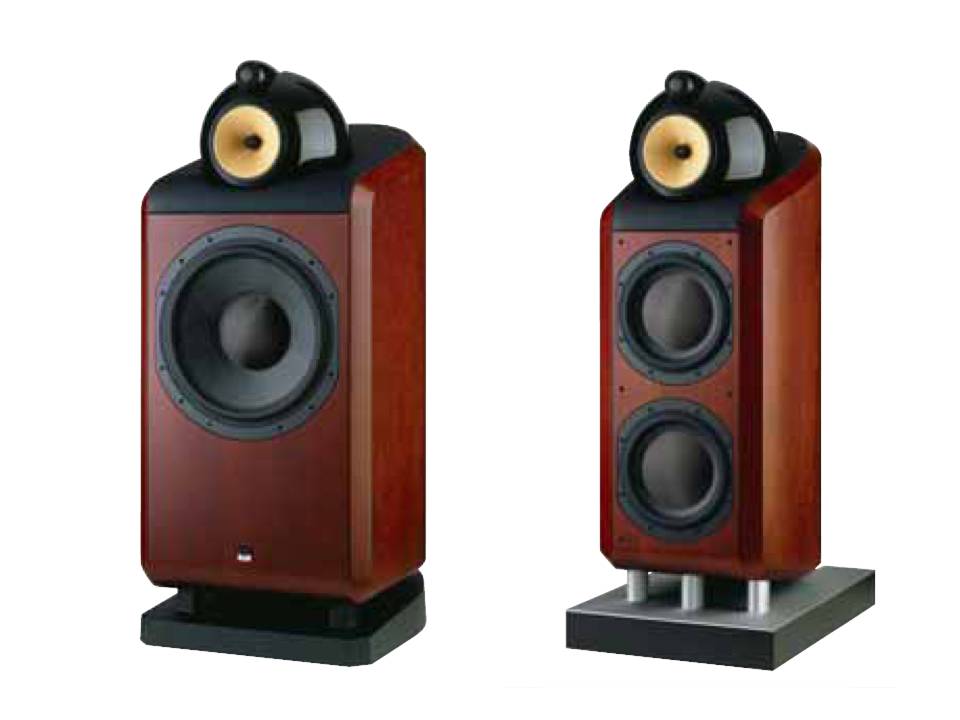

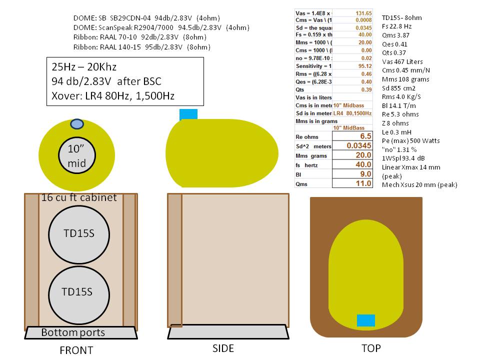

BOX SPEAKERS. Is there a great non-horn design with high enough efficiency for Lynn's tube amps?
My boxed speaker sketches these days look like a BIG B&W 801. Two Lambda TD15S covering 20-80Hz at 96db/watt after BSC. A 10" midbass covering the 80-1,500Hz "vocal_range", and a dome or RAAL type ribbon tweeter. The main goals are 94-96 db/watt efficiency from large cone areas, and putting the vocal_range on just one speaker. Personally, a cone midrange puts the correct level of energy into my room better than a compression driver on a horn.
Today there are good dome tweeters with 94db@2.83v, and it seems possible that NdFeB motors can increase this to 96db@2.83v before a 25-28mm dome cannot move enough air to provide a 110-115db SPL. The RAAL ribbon provides 95db@2.83V. A 10" vocal_range speaker in a sealed 2 cu ft volume can provide 95db/watt over 80-1,500 before high IMD(dopler) or noticable beaming. Two Lambda TD15S in a 16 ft3 fiberglass filled ported box can provide 25Hz 96db/watt after BSC. Passive radiators cannot increase efficiency like a second woofer motor.
