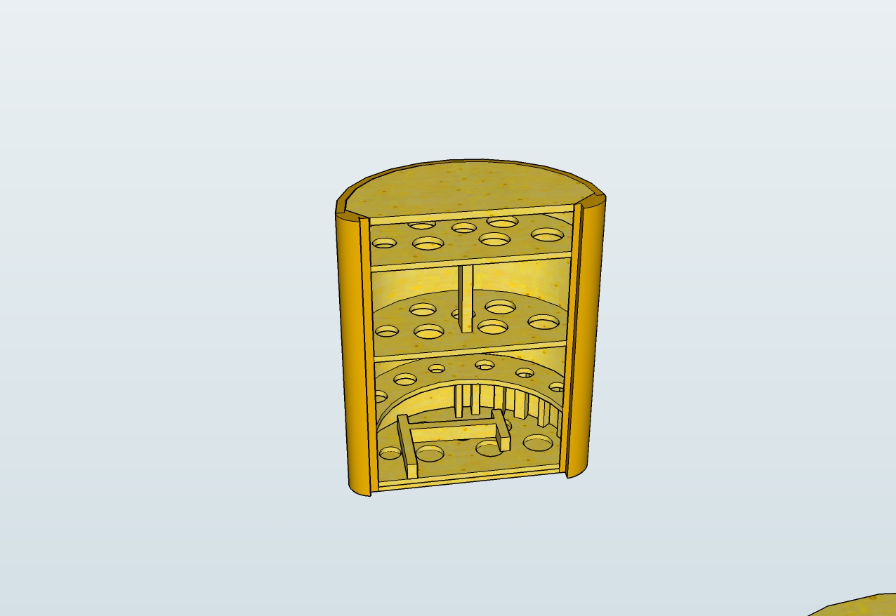

nice looking. It reminds me of a few things...but it's a much more affordable implementation than most of those.
Why not have a brace that goes all the way through the enclosure to connect the top and bottom plates?
There are ribs between each of the shelf braces, but no, there's not a full top-bottom continuous brace. The bottom has many braces distributed over the surface of it, and connected to the first shelf brace, which has more connections to the second.
