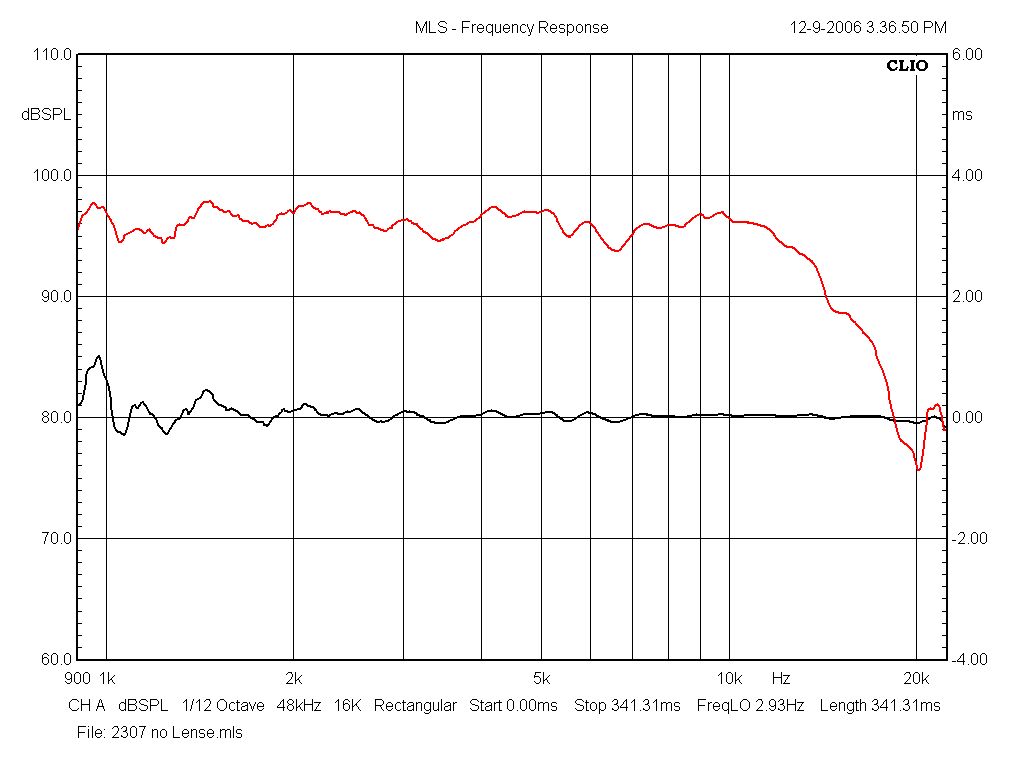

The problem I have with all this discussion is that I have yet to see any data that shows any deviation form MP in other horns. So when you say MP horn, it doesn't mean anything to me at all. It doesn't separate it form the rest of the pack.
I'm not sure which you are talking about. I have already posted data on four designs, and do not intend to post any more until someone else matches that number. Quoting data from others don't count.
taken from:
http://www.diyaudio.com/forums/multi-way/103872-geddes-waveguides-66.html#post1916139
Have you posted measurements for the upper one? - I must have missed it - could you please point me there ?
Showing simus only "does not count"
Michael,
I second that.
I give up on trying to explain / justify that one - gonna take some English lessons ....
Michael
Those are just part of analysis of a new design, which also depends on a new driver. There is no firm date for that driver yet.An externally hosted image should be here but it was not working when we last tested it.
taken from:
So - which measurements do you mean then?
Michael
Summary is here, but you would have to dig through the thread to recall the details.So - which measurements do you mean then?
Michael
http://www.diyaudio.com/forums/multi-way/103872-geddes-waveguides-320.html#post1887771
Kidding - eh ?
Don't think I would have missed *any* measurements form you in this thread connected to the topic at hand
Michael
