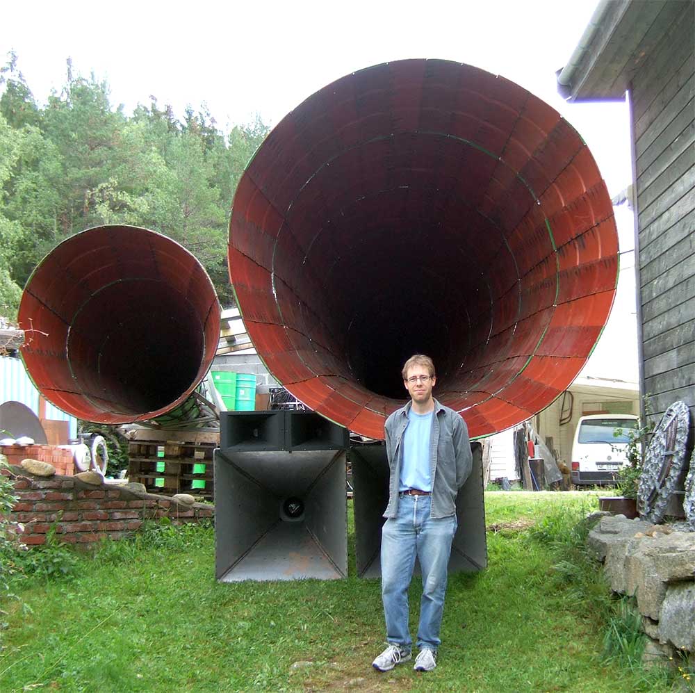

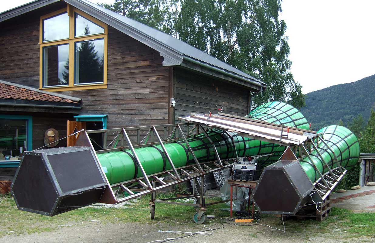

My Norwegian friend Bjorn Kolbrek sent me some pics and text about this modest little project:
BTW, last weekend, I tuned up an insane horn system that I have helped design. I don't have time to explain much about it now, but it had a very nice bass. The big horn has good response down to 15Hz. It is 9.2m long, and the mouth is 2.4m across. It's yours truly standing in front of it to give you an idea of the scale of the thing. The system is 3-way, and covers 15Hz-15kHz, and sounds remarkably good, very clean too, even at loud volumes and large distances. Playing organ music on it was cool :). You could hear the quality of the bass far away, and the sound was balanced even 1.5km away.
I think even Truesound would agree the bass horn is adequately large for the task. If you ever wondered what Norwegians do during those dark winter months, well, now you know.

That's quite a horn system - bravo!
I am surprised to read that it will play down to 15Hz. That's a wavelength of almost 23 meters. Wonder how he does it?
Given the size of the throat seen being the size of the driver you possibly get plenty of SPL with and without horn ;)
I'm curious - is the normal listening distance the mentioned 1500m ?
They seem to have excessive living rooms up there...

I hope that is photoshoped :)
Nope :D The big horn is 9.2m long and has a mouth diameter of 2.4m. Compare it to the Patrol in the attached pic. It's not the worlds biggest horn, but I believe it ranks among the largest.

The first resonance of the horn is about 15Hz, it drops quite fast below that. As the frequency rises, the response increases somewhat, and is really powerful at ~25-30Hz. The mouth is far to small for good 15Hz response, but the response is not very peaky. The smaller of the green horns fills in the dips, for a quite smooth response. The drivers for the large horns are Billebro 21" drivers, BTW.
We had planned it bigger, but we had to do some compromises - mainly based on how lage objects he who built it could fit trough his workshop door, and what could be practically and legally transported along Norwegian roads...
The normal listening distance is not 1500m, but we had to test it - crank it up and drive away to listen. You would think the neighbors would object, but the system sounded so good that they actually asked for more. In actual use, the listening distance was from ~150m and up. With the right weather conditions, it could be unpleasant loud even at 300m.
The horn system was build to make an audible and visual protest against a titanium mine in a small place called Vevring. A special "noise composition" was written for it by Maja Ratkje. It echoed out over the fjord in a magnificent way :)
