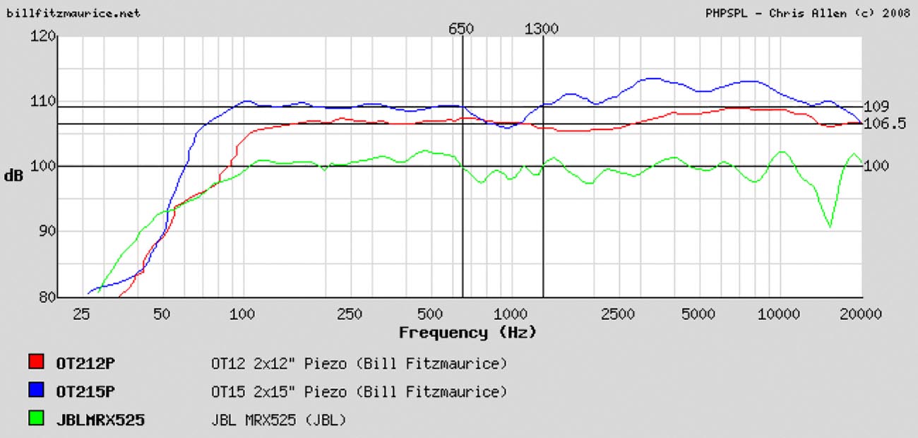

Just ordered the $99.95 all-projects CD from the Bill Fitzmaurice website. The most likely candidates at present look like a stacked pair of the OmniTop 12, which give very flat (measured) response, 105 dB/metre efficiency, and a moderate size and weight of 22"W, 30"H, and 18"D, and 60 pounds (for two cabinets & 12" Deltalites).
The comments from the builders indicate that the OT12 and OT15 are more tolerant of driver swaps than the DR280, which has to stick exactly to specification - and requires more EQ in the real world of live gigs. If I'm interpreting the build pictures correctly, the small rear chamber of the OT12 is almost completely filled with damping foam, which make it closer to a resistive-vent than a classical big reflex box like an Altec A5, A7, or the eXemplar or Blue Thunder.
The more I thought about it, I just don't want a big beast like an A5 or a full-size Onken in my living room - they are nearly the size of a refrigerator, weigh well over 100 lbs, and need a hand-truck to move from one place to another. Also, it's not trivial to dampen vibrations in a cabinet that size - the bigger the cabinet, the more over-the-top internal cross-bracing and panel damping need to be. The bracing requirements of cabinets with smaller panel areas are not as difficult.
When combined with the Altec or GPA 288 large-format driver and AH425 Azurahorn, I think it's reasonable to get a speaker with 105~106 dB/metre efficiency, reasonably flat response from 100 Hz to 12 kHz, and not too much EQ in the crossover. I might also try a 2-stack of OmniTop 15's, just to see how well they work with the 800 Hz crossover of the 288/425 combination.

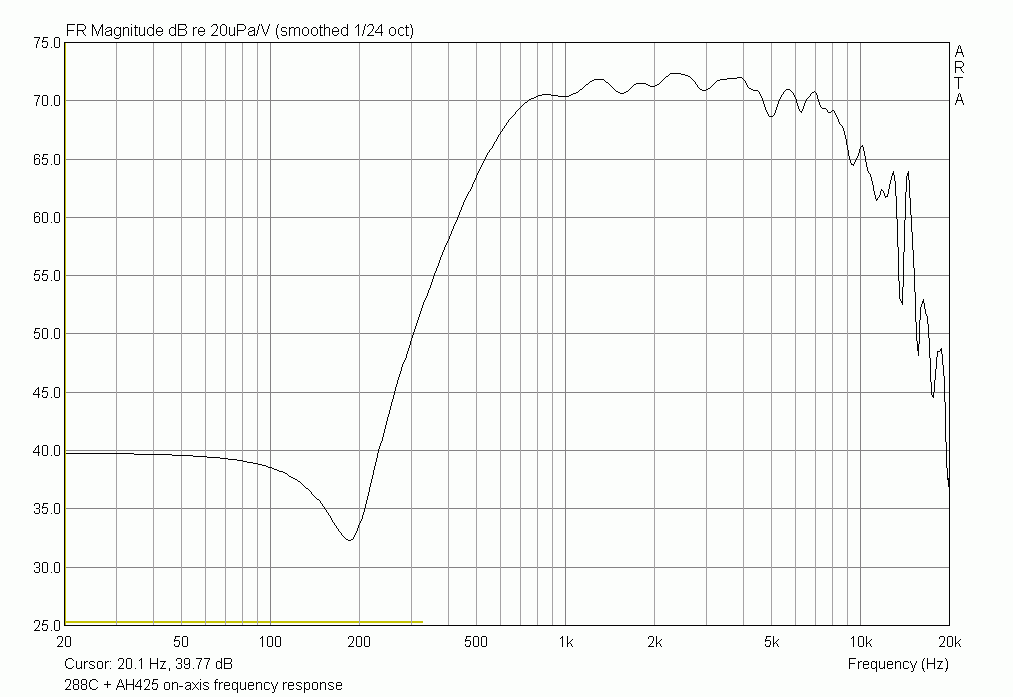

Here's Bjorn Kolbrek's measurements of the 288's and 425 on the day he got them - note that Bjorn is using vintage Altec 288C's with circumferential phase plugs, so the HF is completely different. People still argue about whether radial (Tangerine) or circumferential (traditional) phase plugs are better, some 30 years after Altec introduced them. For that matter, the Tangerine is preceded by an older Western Electric radial phase plug that dated to the mid-Thirties.
Seems a great solution.... I really hope it will perform well, because I've seen that some builders used BETA 12 drivers with Omnitops. I would definitely try it. The build seems very simple, that's a big plus.
Mr. Olson, what makes you believe these won't suffer from diffraction problems at the throat of the horn?
Hard to tell from the pics at the BFM site, but there seem to be some kind of small inserts to fill in the space between the cone and entrance of the horn - a small phase plug, as it were. Since the piezos have little output below 2 kHz, that part of the spectrum is controlled by Bill's phase-plug and horn-throat design.
I'm guessing that the dip we see in the OmniTop15 between 600 and 900 Hz is due to this kind of thing, although its absence in the OT12 is interesting. Maybe the internal chamber is smaller, pushing the cancellation region above the crossover for the piezo tweeters array.
The bottom of the horn range and the top of the big cone (12 or 15-inch) has always been a troublesome region for high-efficiency speakers. The cone is close to its first breakup mode, and the horn response is starting to depart from the desired pattern (and diaphragm) control. Neither is at its best. Unfortunately, the 1~5 kHz region is also where the ear is at peak acuity for distortion and stored-energy problems.
It's probably a little simple-minded on my part, but the intention of using a large-format compression driver, and a smaller-than-fifteen-inch midbass driver, is to leave a little room for overlap. Small-format compression drivers are typically intended for use above 1.5 kHz, and 12-inch drivers can just squeak above 1.5 kHz (with very well-damped surrounds and cones). 1 kHz is usually the end of the line for 15-inch drivers (with the exception of the AESpeaker TD15M). So by choosing a large-format driver that is designed for use down to 500 Hz, I get a little wiggle room in the crossover design - not much, but some.
There is an alternative, a horn-loaded cone midrange. Yes, I'm aware of that - something I might try in the future, but for now, I'll see how the BFM's perform in the 100 Hz to 1 kHz range. I've read just about every comment in the BFM forum, and it appears like the OT12 needs the least EQ of any of them.
For the directivity police, the AH425 is still maintaining pattern control down to 700 Hz, and the controlled dispersion of the OT12 is intended to avoid the beaming of a typical 4x12 array. LF and HF drivers would be in the horn region at crossover, unlike a horn+direct radiator combination.

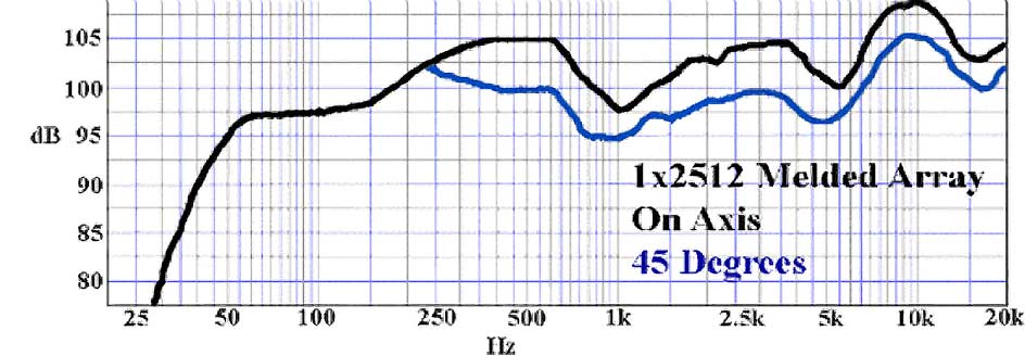

Do you think the BFM measurements are fictitious? BFM is unusual in publishing anything at all. The measurements of the Jack12 look smoothed, but real enough. On the other hand, I've measured Fostex drivers with MLSSA, and found no correlation at all between what I measured and the factory curves.
I should add that the (unpublished) measurements of Klipschorns, LaScala's, Lowther's, and other well-known folded horns are actually worse, with 10~15 dB peak-to-dip ratios. That's what I'm trying to avoid.
