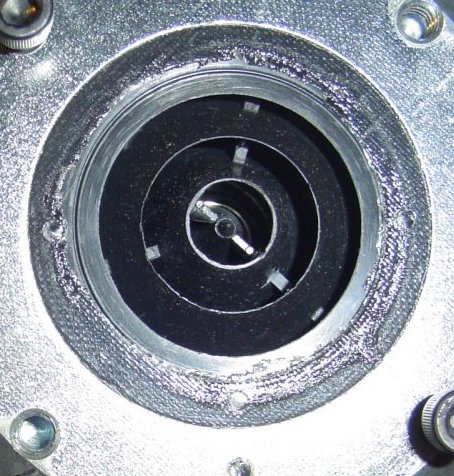

Lynn Olson said:
There are a few drivers that claim to have no internal throat sections, but I don't want to be limited to just JBL - besides, JBL's are not my first choice on purely subjective grounds.
The JBL 243X drivers still have a flair through the phase plug (based on my measurements), even though there is no 'throat section'.
"The JBL 243X drivers still have a flair through the phase plug (based on my measurements), even though there is no 'throat section'."
Hello John
Where are they hiding it?? If you look at a driver with the screen and thermally conductive gasket removed you can see that the screen rests on the top of the phase plug.
Rob
Hello John
Rob

Robh3606 said:"The JBL 243X drivers..."
Rob
CLS said:I think he meant those slits are expanding towards the exit, thus the <a flair through the phase plug >.
Correct. The exit of the driver is larger than the combined area of the phase plug slots near the diaphragm. The phase plug slots are really where the horn starts anyway - it's just built into the driver. What I've heard anecdotaly is that most CD's have this, but I've actually measured it on the 243X drivers.
