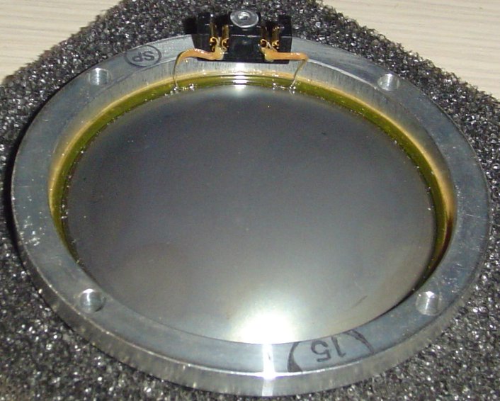

"One of the things I'll be mentioning to Great Plains Audio is applying Aquaplas (now called Antivibe) to the tangential surround of the aluminum compression driver diaphragm. JBL applies Aquaplas/Antivibe to the whole diaphragm when you buy a 435Be, but I feel this is a mistake. The part of the diaphragm with the most chaotic radiation is obviously the surround, and it's an area where mass-damping and outright suppression of radiation is desirable. That is NOT true of the diaphragm dome, where low-as-possible mass and uniform emission into the phase plug assembly are primary goals. Raising the mass of the diaphragm is extremely undesirable, since it depresses efficiency and decreases HF extension."
Hello Lynn
Do you have any personal experience with Aguaplased compression drivers?? Have you ever listened to the differences before and after coating a titanium diaphram?? Have you ever listened to a 2435 vs a 435be?? If the answer is no to all of the above you really should have a listen. The amount of mass added and the subsequent loss in HF extension or sensitivity can be compensated in the network.
The surrounds in a 2435/435Be are Kapton not metal like a Tangential diaphram.

Well, to be honest, I think there's a lot of mysticism about WECO, Altec, JBL, and TAD. True, they made great, classic loudspeakers, but physics still applies to them, and there are areas of design that were overlooked or ignored.
It hardly seems controversial to treat the surround and spider differently than the diaphragm - this has been standard practice for direct-radiators for 80 years. The task of the surround and spider is to assure pistonic motion, prevent side-to-side rocking motions, minimize nonlinear distortion, and minimize spurious emission. Rice & Kellogg were aware of all these requirements.
The aluminum tangential surround was originally chosen to provide maximum excursion linearity for a near-full-range WECO theater driver. Due to the limited HF content of movie soundtracks, spurious emission above 8 kHz was not a concern, but power-handling was very important, with only one speaker system behind the screen, and very large theaters.
Adding mass to a diaphragm always lowers efficiency, lowers the mass rolloff point, and lowers the maximum HF extension of a driver. In direct-radiator tweeters, the amount of damping goo to apply to a silk-dome tweeter is a judgement call between leaving in resonances and too much depressing of efficiency and HF extension. Similarly, the reason the Bextrene drivers of the Seventies were so woefully low in efficiency (85 dB/metre typically) wasn't the Bextrene cone itself, but the very generous application of damping goo to quiet down the 1.5 kHz and higher modes - raw Bextrene is actually very resonant. The BBC developed the inherently lossy polypropylene cone specifically so they wouldn't have to mess with applying damping goo to the cone.
Now that optical soundtracks are no longer in use, and compression drivers are expected to cover the 8~20 kHz range, it exposes problems with diaphragm breakup and surround spurious emission - the same problems seen in direct-radiators for the last 80 years. The problem with compression drivers is that they are much bigger than the equivalent direct-radiator tweeter, so these HF problems creep in at lower frequencies.
Spurious emission from the surround is a problem for direct-radiator tweeters, and as shown by the 1979 Murray paper, is a problem for compression drivers as well. I guess the reason I have a slight problem with applying Aquaplas to a beryllium diaphragm is that after decades of PR about how wonderful beryllium is, now it has to be treated with the same kind of damping goo as other, less awesome drivers using titanium or aluminum diaphragms. The plain fact is that large-format compression drivers just aren't at their best above 8 kHz - the HF cutoff of old optical soundtracks, which is what the WECO and Altec compression drivers were originally designed for.

"Well, to be honest, I think there's a lot of mysticism about WECO, Altec, JBL, and TAD. True, they made great, classic loudspeakers, but physics still applies to them, and there are areas of design that were overlooked or ignored."
Hello Lynn
Like dampening the diaphram as an example? So I take it you have never heard an Aquaplased Compression driver?? Since you have never heard one I think you should reserve judgement on the effects of how it was applied until you actually get a pair and hear for yourself. It's real easy to sit back and pick nits.
'Adding mass to a diaphragm always lowers efficiency, lowers the mass rolloff point, and lowers the maximum HF extension of a driver."
Like all drivers a balance of trade offs. What matters is the end product not just one part of the puzzle.
" I guess the reason I have a slight problem with applying Aquaplas to a beryllium diaphragm is that after decades of PR about how wonderful beryllium is, now it has to be treated with the same kind of damping goo as other, less awesome drivers using titanium or aluminum diaphragms."
Well that's too bad becasue you are missing the point. It works on Titanium and Aluminum as well. It's not about using it on Berylllium the point is using it. If it improves the performance why not use it. You have said yourself you were not bowled over by Beryllium undamped. May be you will like it better coated???
If you assume the diaphragm is piston operation, that may be true. But since in reality it is not, it all depends on how the damping is applied.
