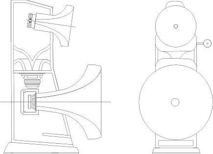

hello Lynn
i read this thread up to page 55, and i recommend people from AA board to read it, as many aspects of hornspeakers are mentioned as well. I just hope the one that send you the email, is not aloud to post here.
I have never listened to open baffles. it is controversial. some like
them , others don't. something your OB 3, 4 ways idea does not solve, is what i read today at another thread of this forum :
Personally, I like coaxes. They have the potential to sound very coherent, due to the almost point source radiation characteristic. They energise the listening room differently than most speakers because, generally, they have a conical (90 degree) dispersion characteristic, that can remain defined over the entire frequency range, narrowing a bit at the top end. Normal cone/dome systems change their patterns quite a lot over their range, and so gives a wildly varying reflected energy that just sounds wrong to me.
I agree with that.
fullrange drivers and coaxes however lack of the tremendous dinamics, 3, 4 way horn systems are able to deliver. also, fullrangers do not have enough indirect radiated sound, as omnidirectional speakers, to give more "openness" and spacial sound.
I've heard mbl's at ces, and they radiate on the other hand too much energy indirectly, what does not sound right as well.
i like Magnetar's full horn system. as all drivers, including the bass, use a small backchamber, so no boxy sound.
to adress the problem of directivity : why not built in a
fullrange ore coax driver , similar to duevel, upward firing, and radiating 360 degrees into the room, with a L-pad, so the indirect radiated sound can be padded down until the right relation direct sound / indirect sound is reached , similar as Wilson ore others do with a tweeters, backward firing ?
i draw a view month ago a speaker with this idea , i named it AudioVoice Bariton :
http://www.flickr.com/photos/12312992@N07/page3/
today i would change the design, but the draw gives a idea what i meen :

Well, as many people have thoughtfully informed me, I don't know a whole lot about horns. If we are to take the experts at their word, they're over in the AA H-E forum and the "other site", not wasting their time with this thread.
From my non-horn perspective, traditional horns have issues in the time domain. Of the non-traditional horns, Dr. Geddes' foam-filled waveguide has pretty impressive time domain measurements. There were hints of a group buy the last time I looked over in the Geddes thread.
I haven't seen time measurements of LeCleac'h horns, but what I've heard sounded very good. But remember, I don't know anything about horns and have "primitive" tastes, so please don't take what I say seriously.
This whole horn thing has so many religious overtones that I'm bound to offend somebody no matter what I say. So I'll keep it really simple: do some travelling and audition famous horn systems. There are all kinds of competing horn-design philosophies and the proponents of each are confident they have the Keys To The Kingdom. Do not expect kind words for other design approaches - the voice of experience speaking here.
Set aside the words, marketing PR, and in-group thinking and listen for yourself with your favorite music - not the stuff they want to show off. Do not take any Internet or magazine recommendations seriously, no matter how smoothly written and persuasive it appears.
Since the design approaches are sharply drawn, pick the methodology that agrees with your tastes. If you branch off on your own, expect no support from the existing methodologies.

This probably sounds really wussy, but truthfully, I'm more drawn to cones-n-ribbons because it's a technology I'm more comfortable with. Horns and waveguides are alien territory, things I don't know very well, and the old-school colorations aren't to my tastes at all.
I was never an Altec or JBL fan, despite living for six years in Los Angeles, birthplace and home of ERPI, Altec, and JBL. I heard plenty of 'em there, even sold a bunch in my first job, but I never liked 'em, despite the huge - and I mean huge - following they have in LA.
But if horns are your thing, be my guest!!! The HF portion of what I've shown is perfectly adaptable to a horn or waveguide, and for that matter, the 8" driver can be discarded in favor of a 500 Hz horn, so you get the horn sound in the crucial voice range. But as for designing the horn itself - uh well, you're on your own.
