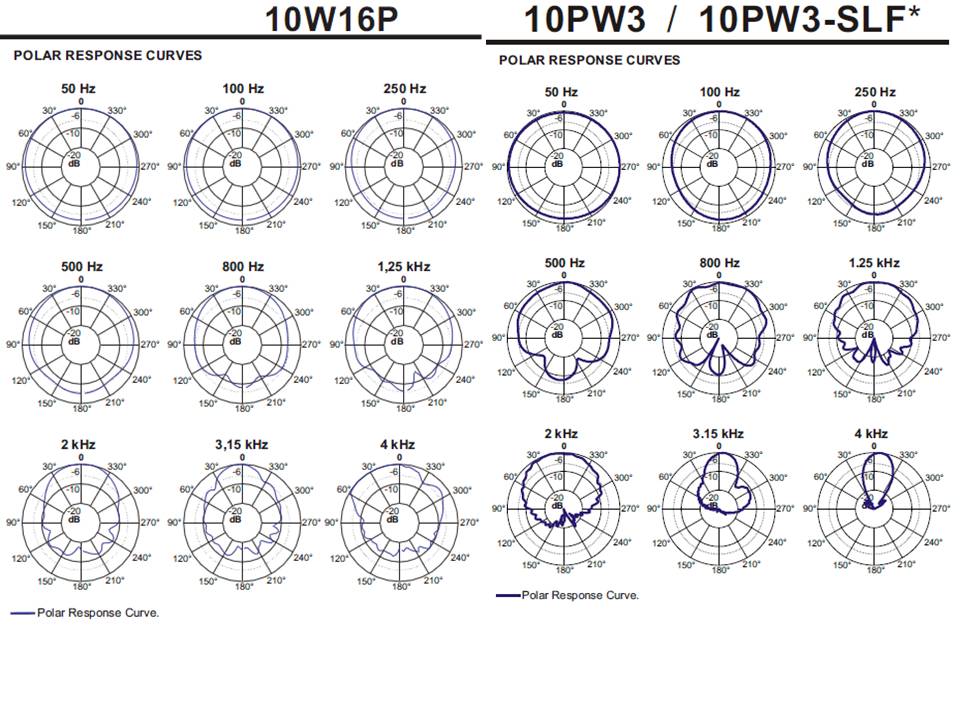

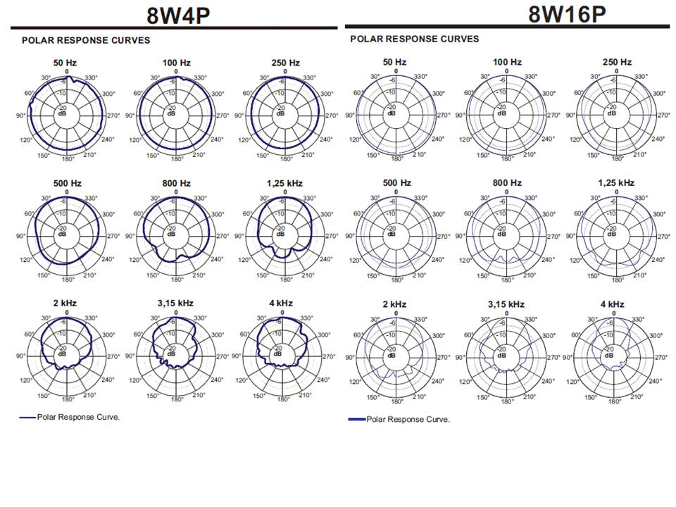

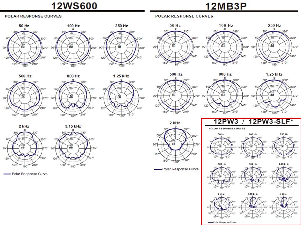

My rule of thumb, before polar measurement of each speaker:
10" midbass has ~90degree polar at 1100-1300Hz
12" midbass has ~60degree polar at 1200-1400Hz
There have been a few well reviewed designs using the Acoustic Elegance Lambda TD10M midbass with the Beyma TPL150H 80x30 horn crossed ~1200Hz. A 10" diameter midbass has ~90 degree polar response around 1100-1300Hz based upon cone profile, surround, phase plug, etc... For decades, JBL's 4345 monitors used the JBL 2012H 10" midrange with a 90 degree tweeter horn, plus a 18" woofer. I classify the Lambda TD10M as a "vocal range" speaker since it can cover 80-1100Hz. I own Lambda TD10Ms.
The Levinson Daniel Hertz M1 uses the Beyma 12p80nd with a compression driver on a 60x40 horn, which I "think" is crossed 18db/octave at 1600Hz.

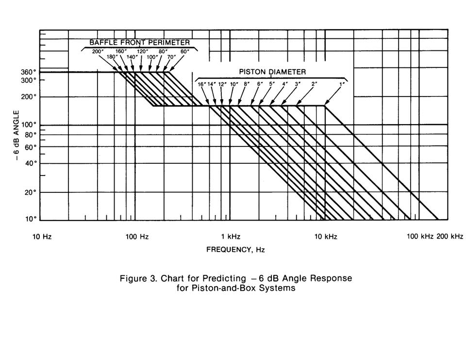

Years back, JBL published a SIMPLE graph which estimated the polar pattern vs. frequency for THEIR speakers. Today, some manufactures plot the polar response for each driver, and this better illustrates how much cone profile, surround, phase plug, etc..., can affect the polar response at different frequencies. (figures)
Today, everyone understands "horn honk" and tries to minimize C-to-C between the midbass speaker and tweeter horn/waveguide.
Today, everyone understands controlled directivity and "has a plan" for how the polar response should be continuously and smoothly shaped for their listening environment from: 20Hz==360degrees, bafflestep==180degrees, tweeterbeam <<90degrees.
Today, because of HT with large flat panels on the wall, "the plan" OFTEN attempts to get the best sould from against-the-wall, or in-the-corner speakers.

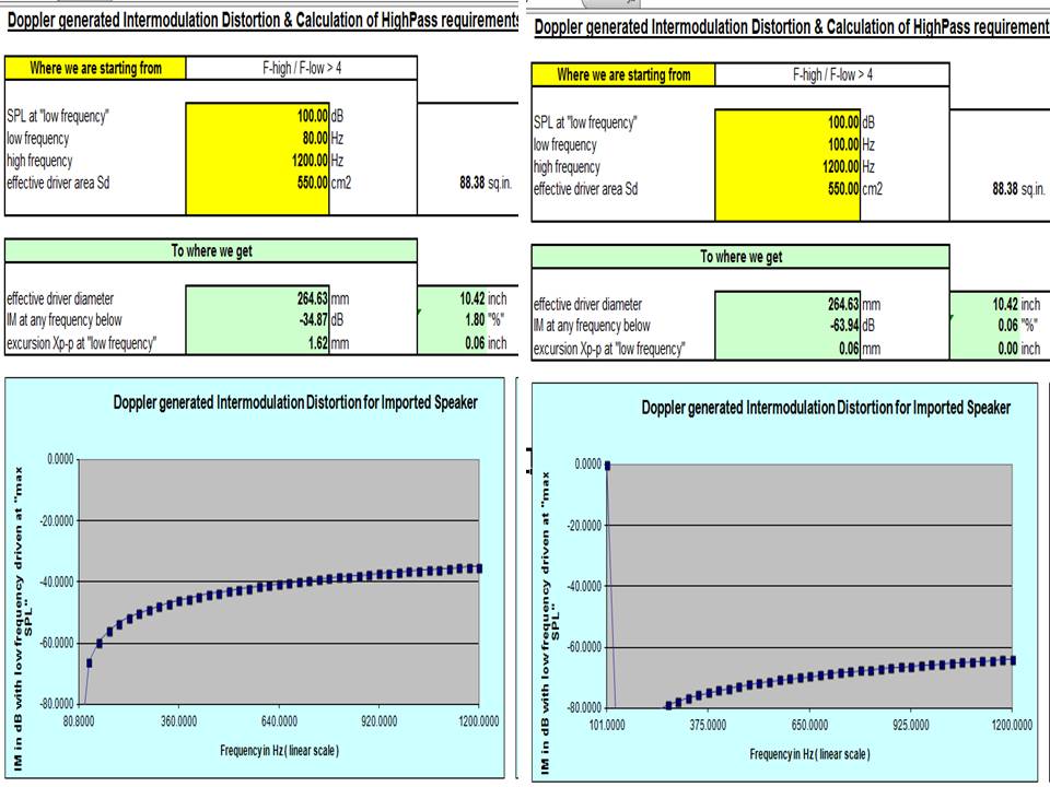

That is a 4-octave passband! Do you really want doppler IMD in the critical voice range?
There are a few simple Doppler/IMD modeling tools that are said to provide conservative estimates of high_on_low frequency intermodulation distortion.
I attached figures from one tool for a 12" speaker covering 80 or 100Hz midbass up to 1200Hz midhigh range. As you can see, moving from 80Hz to 90Hz or 100Hz provides significant extra IMD margin. -40db is typically reported as the baseline inaudible level. A LR4 Xover at 80Hz removes ~6db of power, so the 100db SPL graph point is conservative.
With these tools, the Classic Altec Voice of the theater with a 15" woofer covering 30Hz up to 700Hz has much less(worst) IMD margin(11db Altec vs. 40db for the 12" modeled @80Hz).
I am a fan of "vocal range" midbass speakers. My HT speakers use the Lambda TD10M from 85Hz to 1200Hz with LR4 slopes. I have experimented with 1000Hz sines mixed with 100Hz sines and do not hear high frequency "flutter" at normal listening levels.
