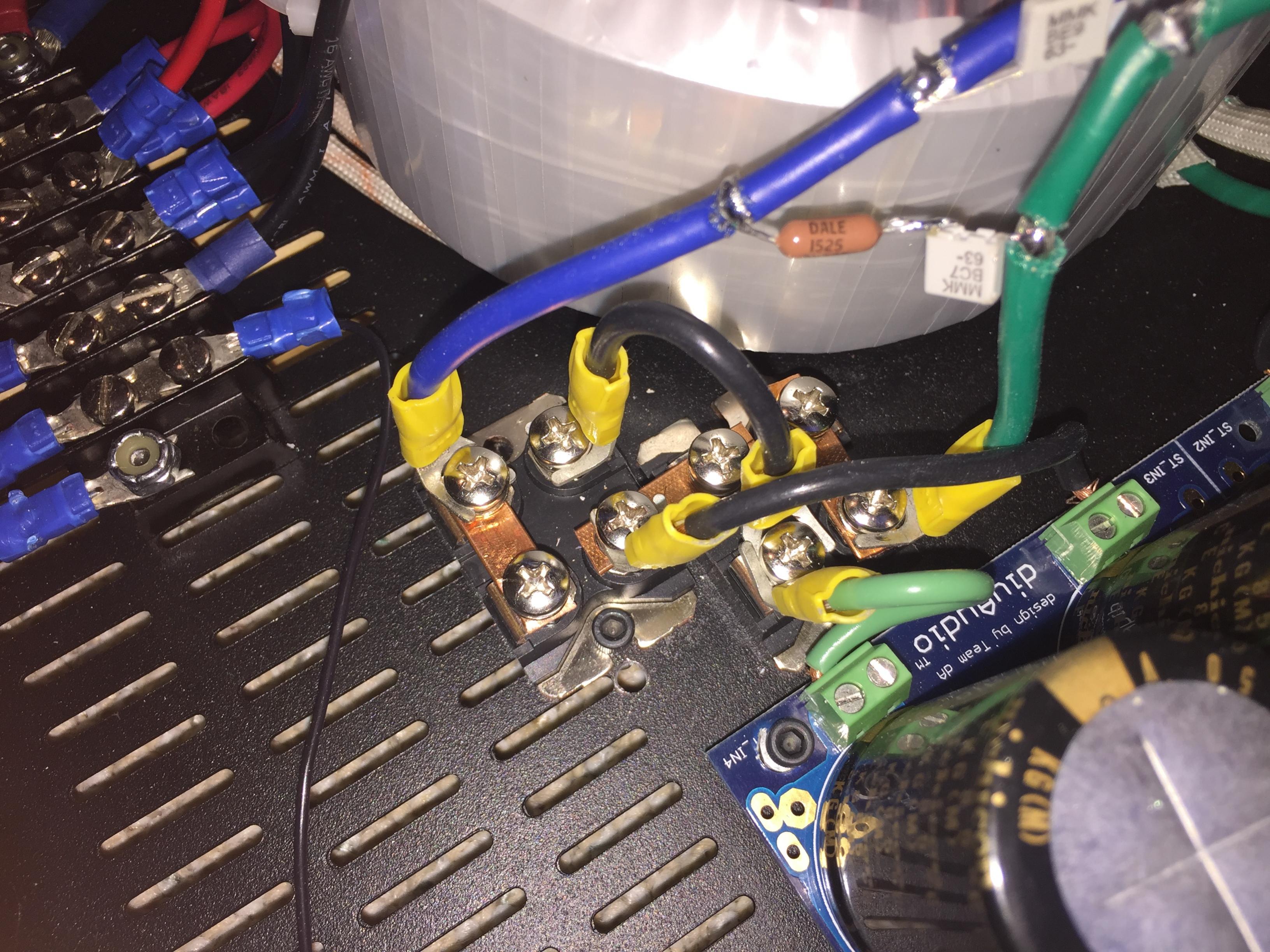

Nice looking. I do like the copper bus bars. I have 2 sets of those for my DIY VFet build. I need to do the power supplies, when life allows.
Well done, and thanks for the picture.
Decided to post this here.
Today mounted up some HFA50PA60CPbF diodes onto a PCB.
The plan is not to repeat the excellent work of Mark but to see if simply replacing standard block bridge rectifiers to Hexfred diodes provides a measureable improvement, when used within the context of a diy class A amplifier. Each channel of the amplifier is biased at 1.5A.

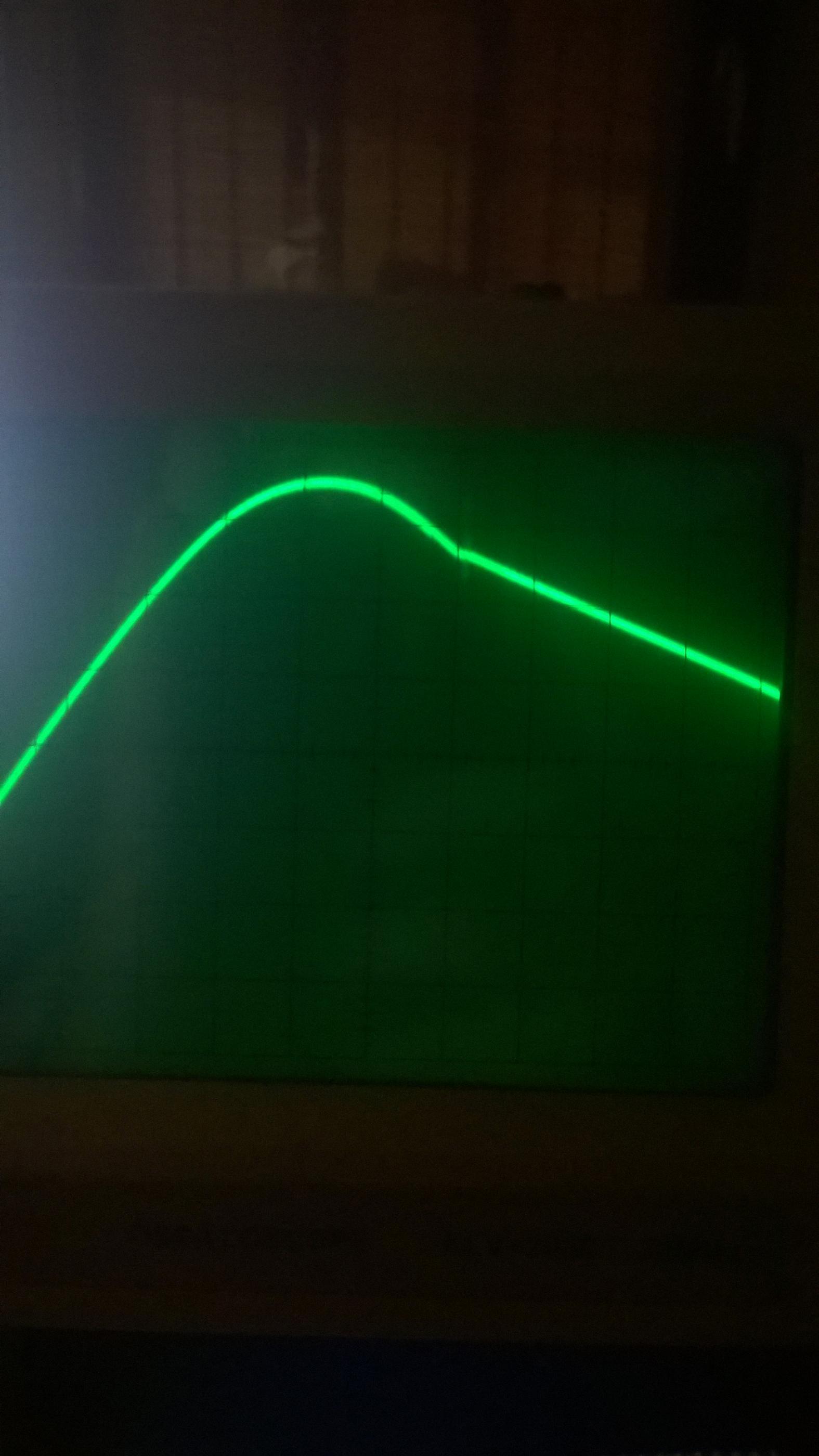

Here is the result with the standard bridge rectifiers, you can see the rectified noise is filled with harmonics up to 350Hz.

Compare "350 Hz" against the natural oscillation frequency of your un-snubbed transformer secondary. Based on the uploaded measurement data from hundreds of diyAudio members, I predict you'll find there is a wide gap between the two.
let f1 = 350 Hz
let f2 = the natural oscillation frequency of your un-snubbed transformer secondary
let g = (f2 - f1)
g is an abbreviation of gap
What is the numerical value of g, in Hertz? Would you say g is a big number? If so, would you say the gap is a big number? If so, would you say the gap is wide?

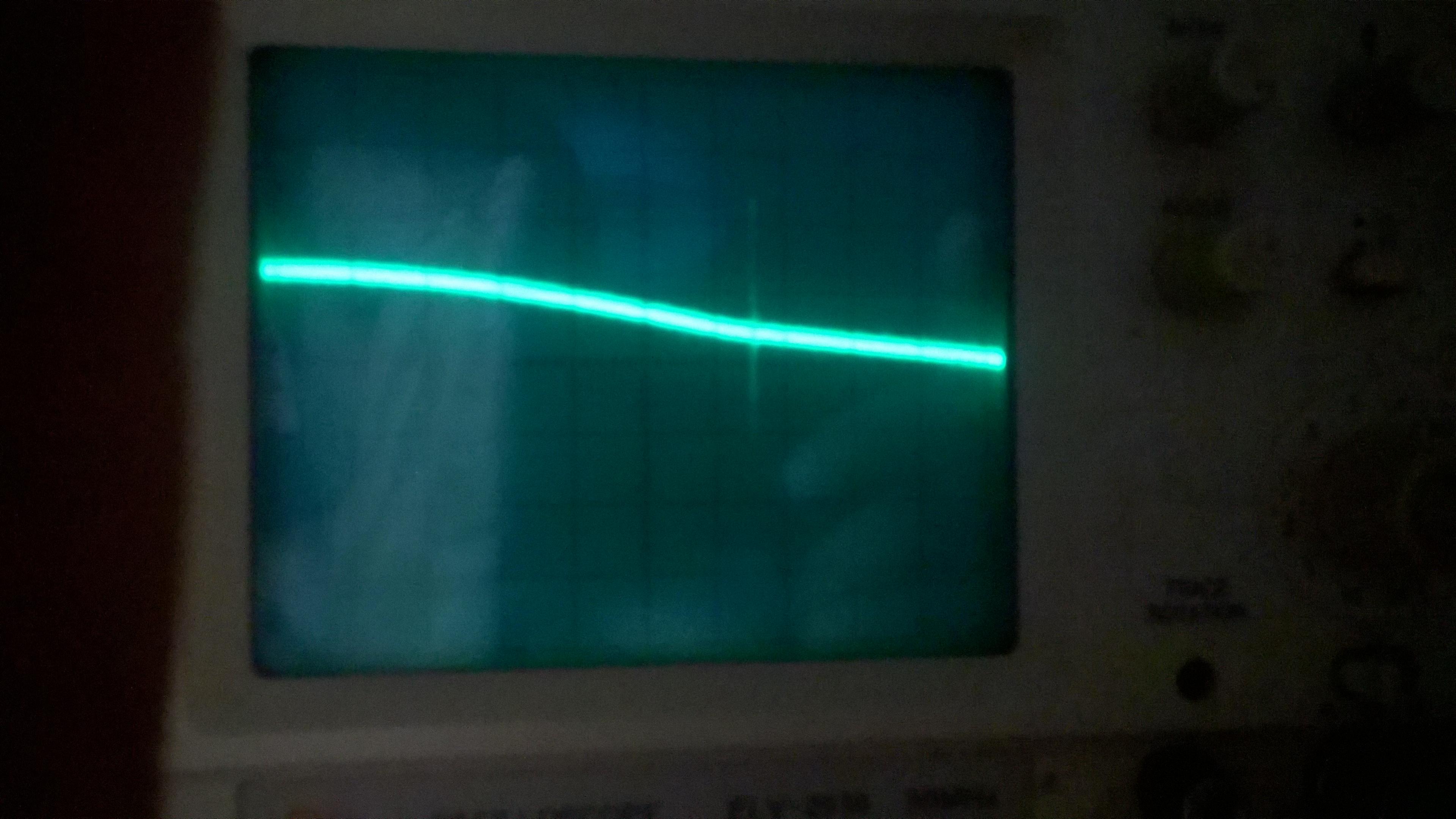

With the Hexfreds installed.
No measurable improvement. If anything slightly worse. Hahaha

With analog osciloscope I must to turn off light in room to see that shadow spike. With digital osciloscope I dont have experience.
Then I sniffing on the rails and on the amplifier output without input signal.
With Mhz bandwith amplifier its funny.
I using this vilager method, then I playing, until I kill that spike.
