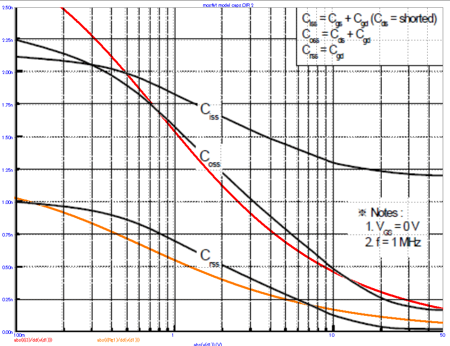

Someone asked about verifying the model capacitances. Some models have fixed capacitances, and they will give fake results. Fortunately, there is an easy way to check.
We start in transient mode, with Vds=0. Then, the constant current source charges the drain-source and drain-gate capacitances. Since C = I/(dV/dt), we can plot this capacitance easily and compare with the datasheet curves. This is the Fairchild model.
The capacitance we're measuring corresponds very well to the datasheet Crss. However, we're measuring Coss. The models seems wrong here.

Yes, the curve is close, but it's the wrong curve ! Coss versus Crss.
I'm using Microcap, and the FQA19N20 model is a subckts : diodes are used to model capacitance. The FQP12P20 model is a BSIM3 one by Fairchild.

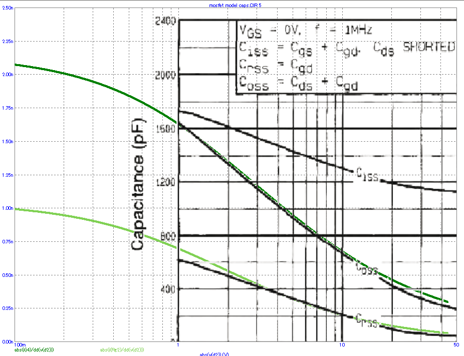

Now, for FQP12P20, the PMOS complimentary. Its datasheet capacitances are very similar to the FQP19N20, which is good.
Its model (green) is completely bollocks compared to the datasheet.
I was wondering why my MOSFET amp simulations showed a PMOS being much faster than the NMOS, which isn't supposed to happen. So, that was the reason ! The capacitances are wayyyyyy optimistic. Also, in the crossover region, the BSIM3 model does... nasty things.

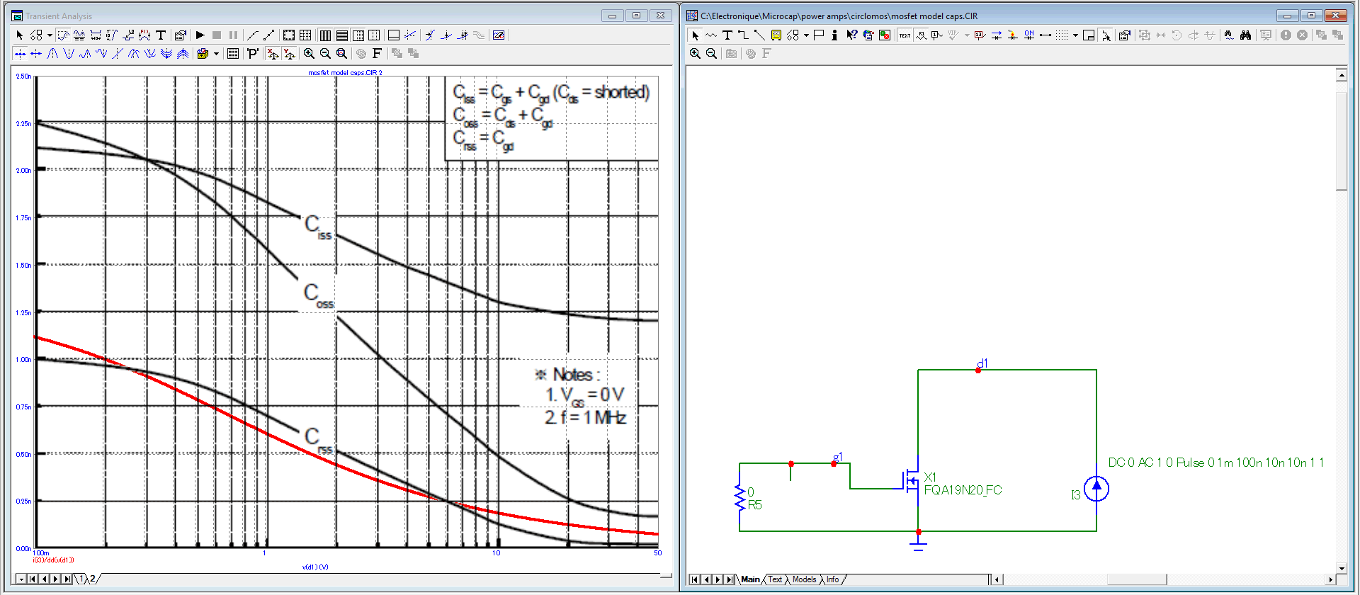

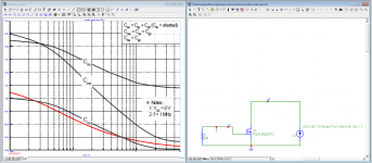

Crss is traced by measuring the current in the gate resistance. Coss is red, Coss orange. I tweaked the model to have a better match with the datasheet Coss/Crss. Unfortunately, I do not have a FQP19N20 sample to actually measure it for real, so please take the following model with a grain of salt.

Measurement would be simple, though :
- Connect D to any AC voltage
- Short G and S and connect to GND via resistor
- Use scope in XY+Math mode...

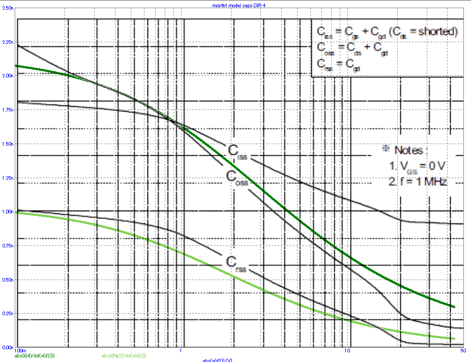

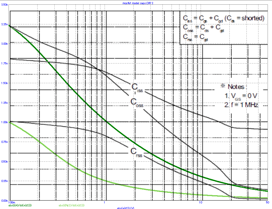

Now, about that PMOS. I got a IRFP9240 model from one of Bob Cordell's posts.
First picture is this IRFP9240 model, versus IRFP9240 datasheet. It matches perfectly. Second picture is the same model versus FQP12P20. It also matches very well. Therefore, IRFP9240 model can be used to investigate the frequency response of both FETs.
FQP12P20 has more transconductance, so it would be a better match for the NMOS, but it also has an impractical package (TO220).
